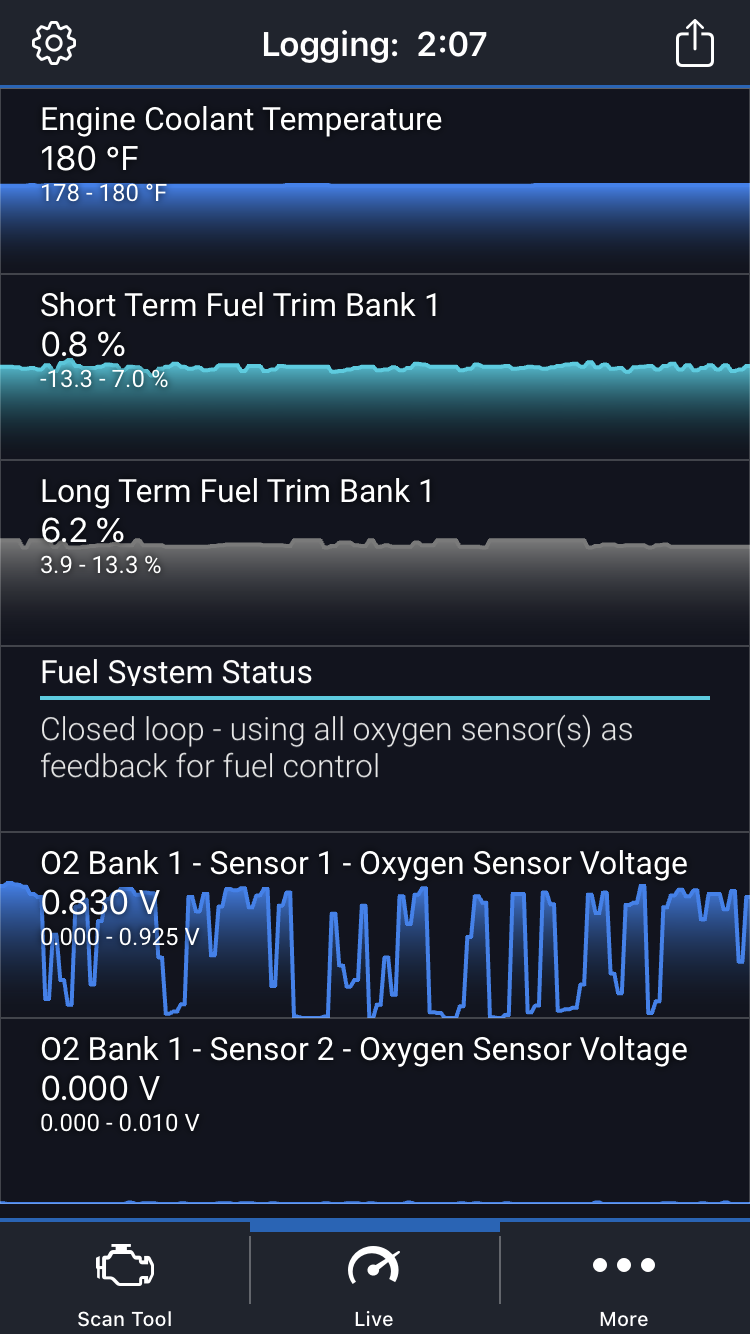

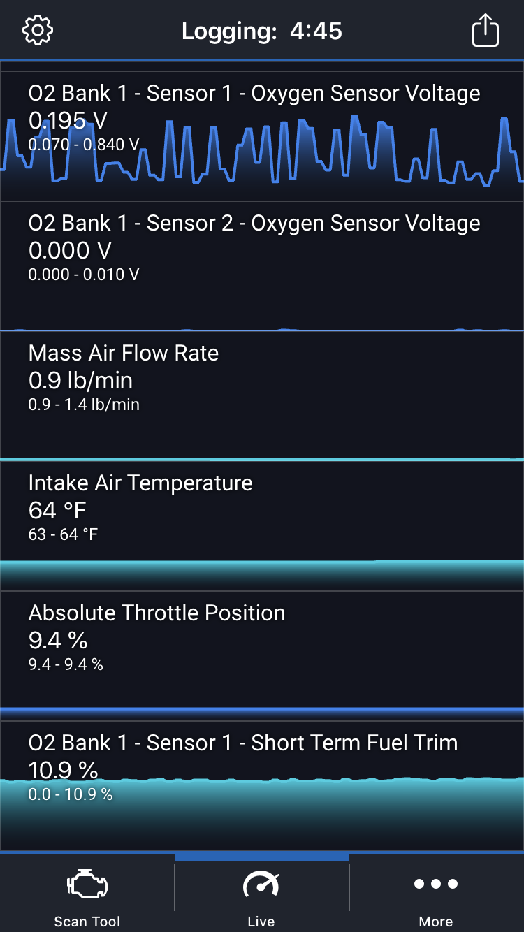

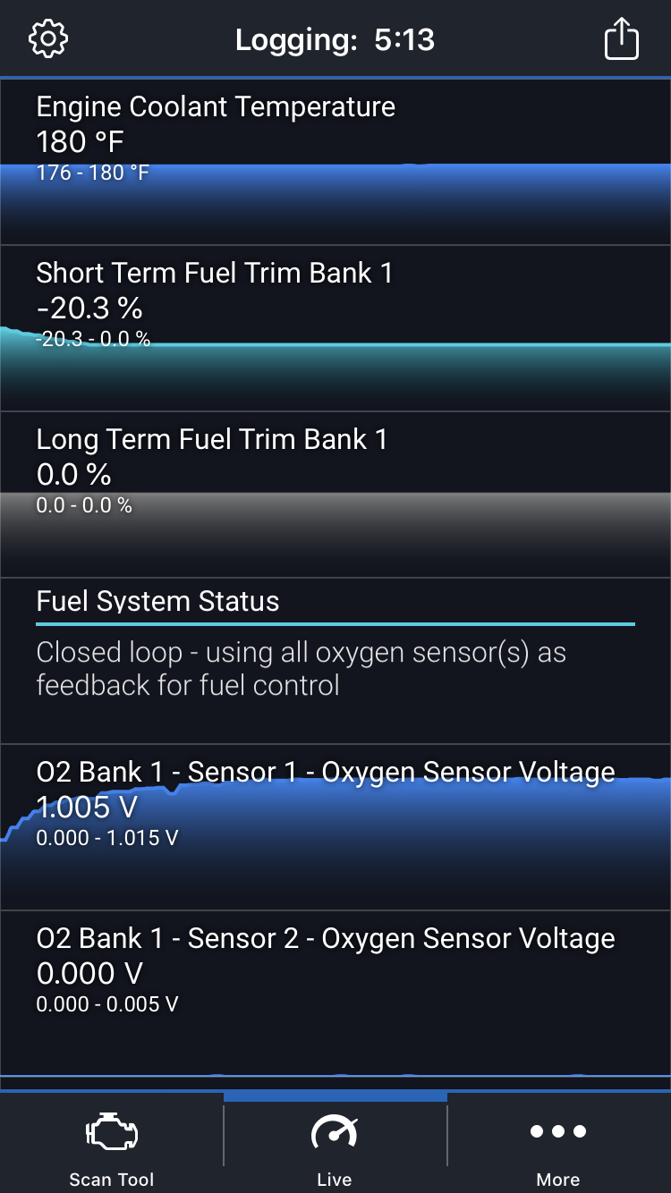

This is what my ODBII reading is looking like right now:
Start up is not where it should be, it definitely turns over about five times before it fires
it idles pretty nicely when in Open Loop, just before the fuel system goes into closed loop I can watch the voltage for the Bank 1 Sensor 1 (Upstream O2 Sensor) start to rise up to about 1.000 volt
As this is taking place the short term fuel trims begin to fall into the negatives. Besides that Long Term fuel trims stay at 0.0% and doesn't move at all.
Also Voltage for Bank 1 Sensor 2(Downstream O2 Sensor) stay at about 0 maybe getting to a peak of 0.010 Volts
MAF is reading at .5 lb/min when in closed loop at idle
Absolute throttle position is reading 9.4% at idle
Intake air temperature seems to be reading correctly compared to my phones reading

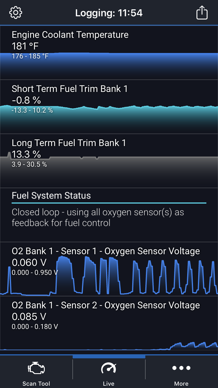

Your fuel trims look good now, great work. My truck flexes to around +20 on the LTFT because I have a fairly shoddy intake setup behind the MAF, and have driven about 5000 miles with no problem. It's easy to end up constantly paranoid about your engine's efficiency with those phone readers. My wife almost killed me over a trip from SoCal to Washington and back for staring at the thing all the time. Toyota CEL tolerance for lean/rich codes is +/- 30%. To be under +/- 15% means it's is not worth worrying about.
Why is your Bank 1 Sensor 2 O2 sensor not reading a voltage? Those two O2 sensors have to agree on what's happening or the ECU will create a bunch of performance issues.
Additionally, what catalytic converter do you have? I ran my truck with a cheap 48 state one and a CA ECU and holy ˟˟˟˟˟ did that create some gremlins.

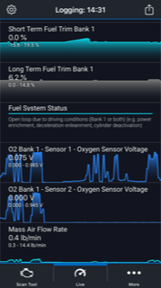

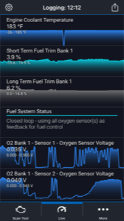

Man I think you hit the nail on the head!

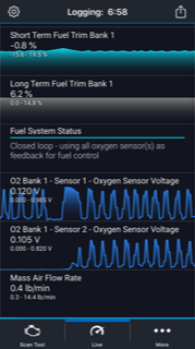

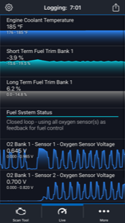

To start I have been concerning myself a lot with fuel trim numbers. I have seen others say similar things about not looking too deep into what the numbers indicate and more that the ECU is still doing its job and adjusting the engine to optimal performance.. I was hoping to see only about 10% + or - fluctuation on the fuel trims and the more i research, the more i kinda see that isn't always correct..
I bought a cheap direct fit down pipe and catalytic converter off of Ebay.. I ended up cutting it up and welding it to the stock down pipe with the 02 sensor bung in front of the cat. I believe i paid $150 maybe for that federal cat.

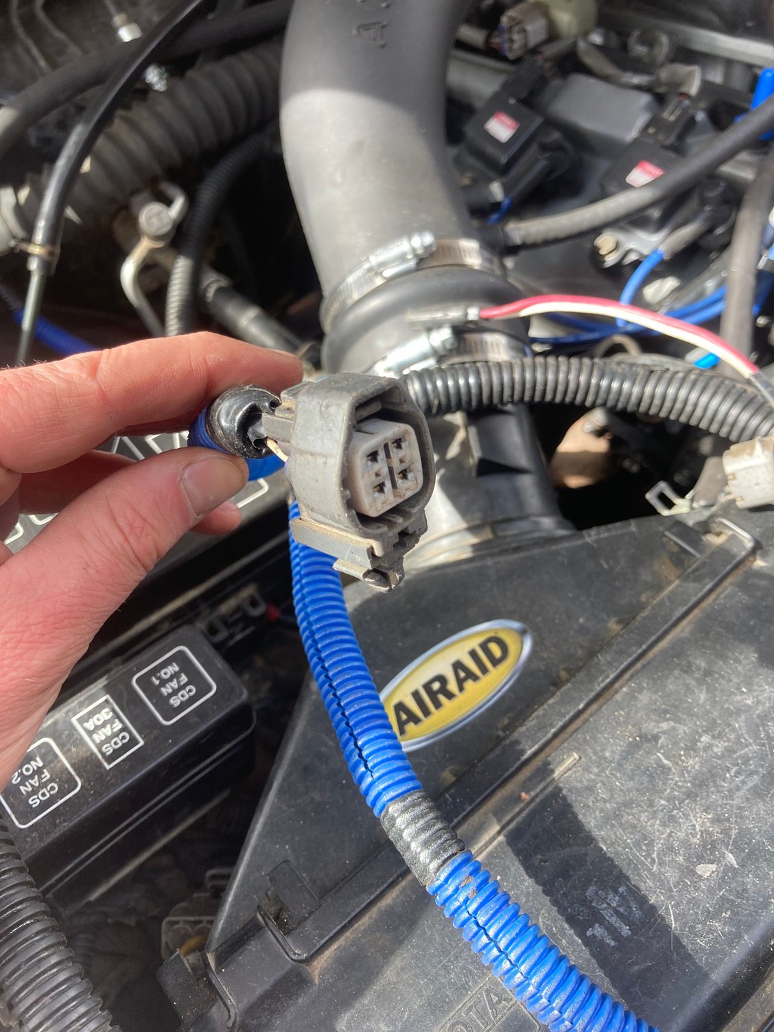

The voltage on Bank 1 Sensor 2 has always bothered me.. and after some calling around and some more research. Im leaning towards the Cat is bad, or not responding correctly.
Below are some photos of my ODBII reader, This was after I had driven around the neighborhood for 7 minutes, I would pull into the drive and let it idle. All of a sudden the Bank 1 Sensor 2 starts to respond with some voltage feed back! Unfortunatly I think it is fluctuating too much for being Sensor 2.. correct me if I'm wrong but I thought it was supposed to sit right around .45v?
And then it just dies out again! I was concerned that maybe the brand new Denso sensor was faulty but seeing that makes me lean more towards the cat being the problem.

Here's an example of OBD2 data with O2 sensor data from my truck, pre-CA cat, and post-CA cat for comparison.
So ya, I agree that it looks like your downstream O2 sensor is fluctuating too much. Those sensors are rather simple heat=voltage machines, so it's safe to assume A. it works & B. your exhaust is being funny. I'm comfortable agreeing that it's the CAT because you can see in both my pre-CA cat and post-CA cat that the downstream 02 did not follow the upstream voltage exactly and was more of a muted version of the same. Your voltages closely match so I'm inclined to think you bought a similar CAT that doesn't have enough catalyst in it to adjust the exhaust to its expected temperatures. Curiously the muffler shop that installed my CA cat said that a Toyota engine will burn out a cat pretty quickly unless the cat is made by a specific company. (pretty sure it was Magna-flow, but I'm not totally sure) Good luck man! I feel your pain trying to get the thing running properly. I ended up just driving illegally with it for about a month, just to properly troubleshoot the issues.
Images originally posted here - https://www.yotatech.com/forums/f160...-3-4-a-307109/
Pre CA Cat - Vehicle runs improperly

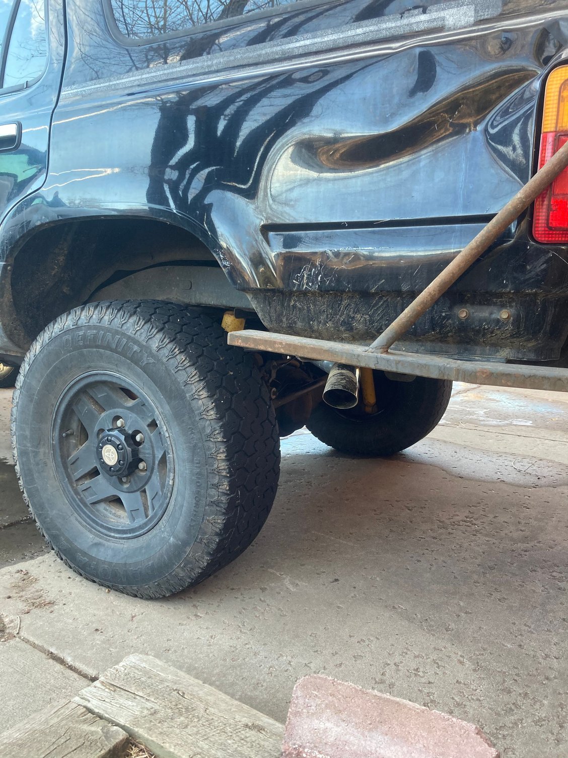

So last week I got the truck over to Mountain Muffler in Golden, CO got it back Friday afternoon, I am very happy with how it all turned out!
The guys at Mountain Muffler did an awesome job! I would highly suggest using them! They tucked it nice and tight to the body, gave me a couple extra hangers too! Ended up adding the 2.5" diagonal SS tip
The Muffler and Cat combo sounds prefect for what I was looking for. On start up it growls sitting in the 1200 RPM range as it warms up and settles it fades off to a really nice soft exhaust sound. But anytime I give it some gas it comes right back to life! Not too loud just right..

In other news...
Im still having some lean readings sitting at idle, and my 02 Sensor 2 is still misbehaving..
Below are some more screen shots of what my ODBII readings
As previously posted my rear 02 sensor 2, is reading very low volts for the first 10 or so minutes..
Then all of a sudden it will start to read voltages. I am however seeing better numbers than before, still No CEL. I sprayed started fluid around the engine hoping to catch a vacuum leak with no luck.
I started to mess with the throttle at this point to see how both 02 sensors would react, and this was the response..
at this point it seems that the 02 sensor 2 is reacting very similar to the 02 Sensor 1
I reached out to a local shop where a Master Toyota tech works and talked with him for a bit.. After asking about the build and what I have done so far, he was concerned that the valves might not be adjusted properly...
He likes to have them loser on the exhaust side and tighter on the intake side.. I did check my valve tolerance, and had a local machine shop shave the stem down to meet spec. That being said, on the second rebuild i lapped the valves one last time, while I was cleaning up the head for reinstallation...
Anyway not my favorite answer, but I can definitely go through and check them some point soon.
Anyone have any other thoughts??

I tested my wiring at my 02 sensors in hopes of finding a short or something that would identify why my rear 02 sensor has been acting up.
Below is my EDW which is what I followed to do my testing: (The key was turned to the ON position, but I wasn't able to run it due to the transmission being out of the truck)
96 4runner 4x4 manual EDW
Bank 1 Sensor 1:
Pin 1: ((Pink) Heater HT1) - Started at about .7v and fell at a steady rate until it hit zero
Pin 2: ((White/blue) +B 12v) - read at 12.26v (same reading as battery)
Pin 3: ((White) OX1 Signal) - There was a reading of .006v (if I were to back prob this wire while the truck was running I believe i would see a reading similar to my ODBII readings)
Pin 4: ((Brown) E1 Ground) - .006v (seems very low?) Will document how I tested below.
Bank 1 Sensor 2:
Pin 1: ((Red/white) Heater HT2) - Started at about .7v and fell at a steady rate until it hit zero
Pin 3: ((Red) OX2 Signal) - There was a reading of .006v (if I were to back prob this wire while the truck was running I believe i would see a reading similar to my ODBII readings)
Using my Multimeter, I grounded the negative wire to the negative battery terminal. Then using the positive lead off the multimeter (DC setting) I probed each pin to get the readings. I did this for every pin even when looking for continuity of the ground.. I wasn't totally sure if I was testing the grounds correctly.. If anyone sees anything wrong with my method of testing please chime in!!
After all of this I might be looking at changing out my rear 02 Sensor to see if anything changes...
