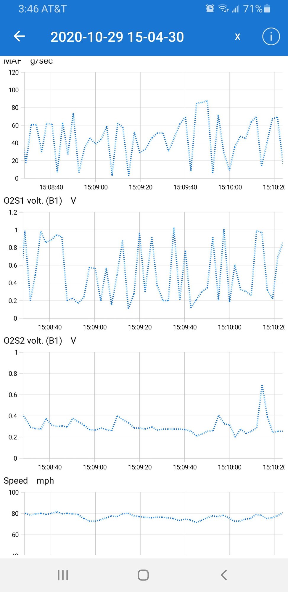

Pre CA Cat - Vehicle runs improperly
Post CA Cat - Vehicle runs properly
Comparing the two sets of numbers, noting nothing changed except a proper CA Cat for my CA vehicle - O2 upstream voltage is now running a healthy bit more than spec minimum. Additionally and likely more critically downstream 02 is running a much lower voltage. Whether that's unique to CA or not I'm not sure.
Likely what was happening prior to the correct Cat was the ECM believed the car was running much hotter and richer due to the rear 02 sensor, and much cooler and leaner due to the upstream o2 sensor, and the ECM couldn't figure out why one was so "low" and the other so "high" and kept occasionally throwing fits of unpredictable fuel trim causing very noticeable power loss.
