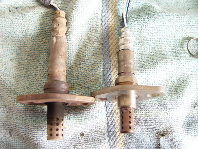

I was hoping someone could just verify the Denso O2 sensor part # for me to make sure I got the right one. Attached is the OEM one I pulled out, and the "OEM replacement" Denso I bought:

Is you O2 connector for four wires or three? It's hard to tell in the pic.

4 Wires!

That's why I asked him if his connector was for four or three wires. His has four. Two for the heater circuit and two for the sensor signal. And, that's why I'm surprised he didn't get any codes. If the heater or signal circuit's broken, the ECU should set a DTC. My guess is that's what the red wire was for; to make up for the one cut.

Just to make clear, that 4 wire harness with the cut wire HAS NOTHING TO DO WITH THE O2 sensor!!! Its the harness for the alternator! I am fairly certain I have the wires hooked up correctly for the alternator, otherwise I doubt I'd be getting a charge.
Anyways -- As far the O2 sensor is concerned, wouldn't I throw either a Rich/Lean CEL or an O2 sensor CEL if something was way off?
I've truly read the autoshop 101 document you posted. I understand that for the most part.
From what I have gathered, the O2 sensor output and heater circuit are functioning properly. But like I've said, my torque, power etc is better during the warm up cycle and the ECU is not getting information from the O2 sensor, and when I disconnect it. The air flow meter seems to be functioning properly too.
