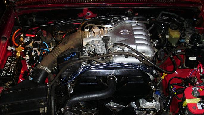

heres some pictures from today just to wet your mouth...took it out for some flex to find where to cut my firewall. shes a fresh SAS & 3.4 swap on 35's with dual arbs and batteries... I cant stop looking at it in my driveway.

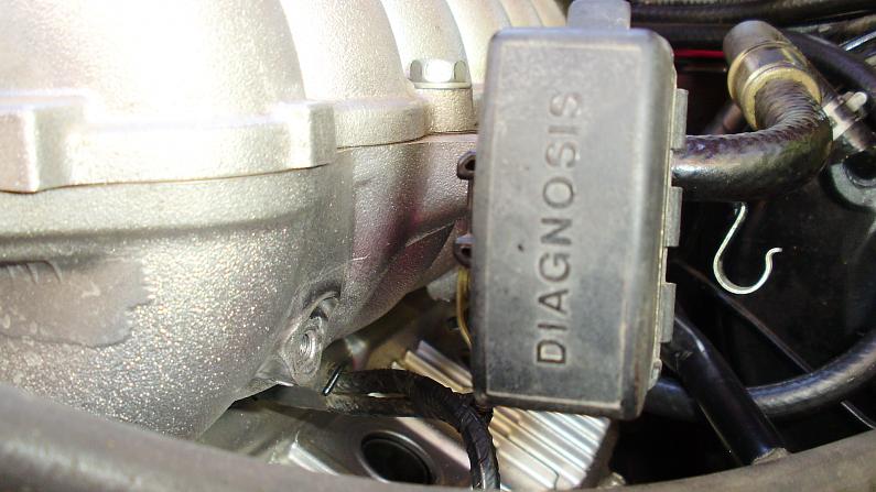

WHAT IS THIS DIAGNOSTIC PORT FOR ON THE ENG IF I HAVE TO WIRE ONE IN THE CAB?

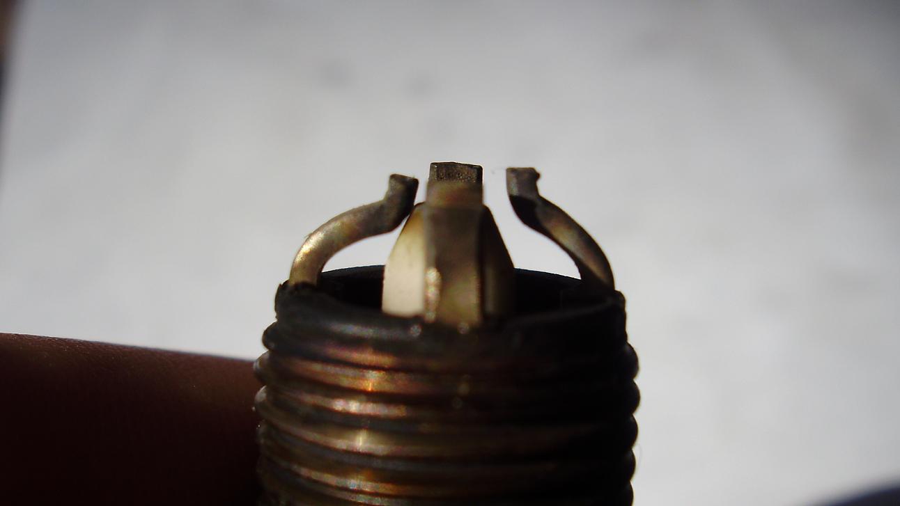

HERE IS A PIC OF THE SPARK I SPEAK OF: WHAT WOULD CAUSE THAT?

bosch plugs suck, end of story! the connecter under the hood is for testing, the one in the cab is for comuniction with a computer scanner. I cant' really tell ya whats goin wrong with it.. just wire it in and get a cheap scanner from schmucks.
