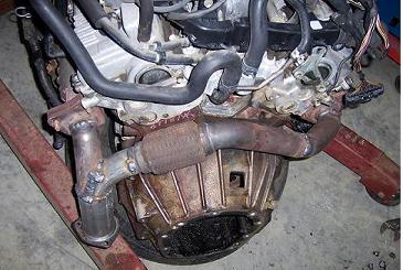

crossover pipe, will i have any flow problems?
i got my engine in and started on the crossover pipe, the collector end was hacked with a torch so i fabbed up my own, do you guys think i will have any problems with this concerning flow or backpressure? i basicly just cut the two pipes in half on the corners and stuffed them in a 2.5 collector, i have it all tacked and ready to weld, i was just wondering about flow, i just dont see paying $400 for a ors crossover. should i wrap this crossover with header wrap or leave it bare?

should i use my fabbed crossover or not? look at pictures above

By the way, I think your crossover looks like it should work. You kept the flex joint which is important. Assuming you welds are sound... I'd run it.
Of course, if it fails you are gonna have a heck of a time replacing it once the engine is in place.

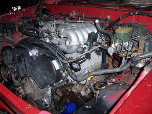

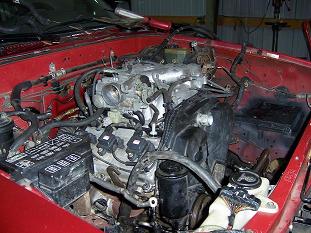

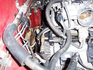

here is some pics of my progress, you can see the engine installed, my battery box, and how i tied in the fuel lines by cutting and flaring the two ends together
