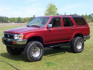

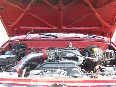

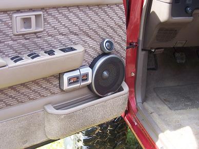

Hey guys its been awhile but i have been busy at work. I finally got some time off to finish my 4runner. i got everything workin but the cruise. got my sterio put in, and my 33's on. This thing rides and runs great, lots of power and torque. sterio sounds great to, i used 1'' spacers in the door and installed some 5 1/4'' components with no problems, put some 6x9 in boxes in the rear with a sony 444 watt amp. here are some pics of my completed ride. thanks guys for all your help

Likes: 5
From: Calgary, AB
Didn't we tell you that you'd love it? Yeah, that's right...we did...
