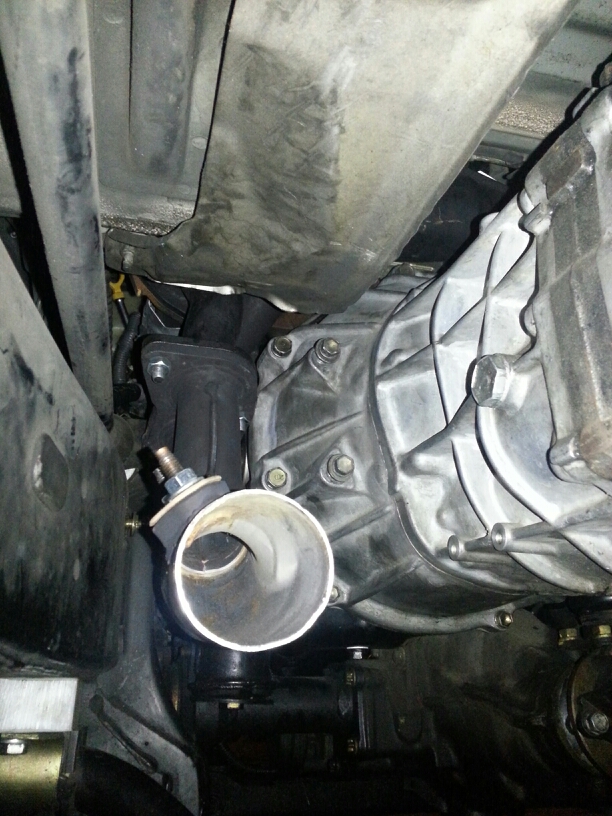

Here's the crossover:
They included a down pipe as well with a spot for the O2 sensor.
Picture from down below before I got the exhaust completed:
