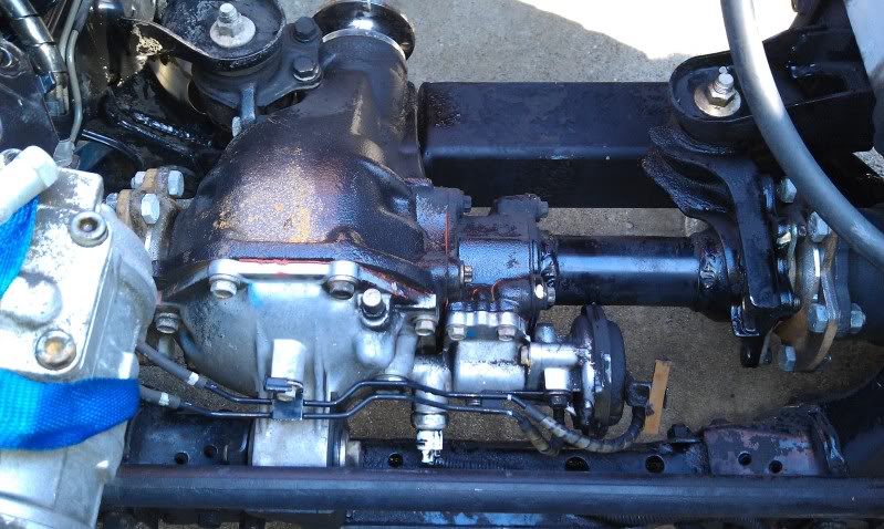

That "4WD" terminal connects to the VSV for 4WD and activates that VSV (while deactivating the VSV for 2WD). When the VSV is activated, it allows vacuum to pass through it to the ADD actuator on the front of the front differential (see below, that big wort looking thing on the axle tube next to the diff). When the 4WD port on the ADD receives vacuum it pulls a splined gear over that connects the differential to the driver side axle shaft.
When that gear is in proper position, it closes another switch, "ADD (A5)" which provides a path to ground for the 4WD light in the dash, and the 4WD light becomes illuminated.
If your truck was originally equipped with ADD, all you would need to do is ensure that that "ADD (A5)" switch is bypassed (the 2 wires leading to the plug should be soldered together) and you should have a functioning 3.0 ADD 4WD system that will work for a SAS truck.
Here's a picture of my ADD front diff, taking note of the two vacuum lines, and the white electrical connector (near the front diff mount):

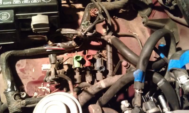

Something that would be easy to find, look on the passenger fender for the VSVs. Mine were in a group of 3 VSVs but only the brown (looks red) and blue are used (brown for 2WD and blue for 4WD); I don't remember what the green one was for, but I didn't need it with my swap.
For the 3.4 swap, the ADD switch can and should still be bypassed as described above (by soldering both sides of the ADD switch connector's wires together).
