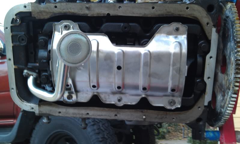

Yes, the 3.0 oil pan will work on the 3.4.
I'd recommend using the 3.0 pan (either buy a new one or reuse your current), use the 3.4 baffle (the 3.0's is sandwiched between the oil pan and the block, and is a potential oil leak source), use a 3.4 oil pick up from a T100 (15104-62070, this will work 100% with the 3.4 baffle and fit the 3.0 tank), use a T100 3.4 dip stick 11452-62060 (guide) and 15301-62060 (dip stick itself). This is the set up I ended up using (with the stock IFS setup) and everything went together and fit like factory.
EDIT:
Here's a picture of my first 3.4 with the 3.4 baffle (freshly cleaned up, thinking I was going to need to cut a hole in it for the pick up) and the new T100 3.4 oil pick up:
