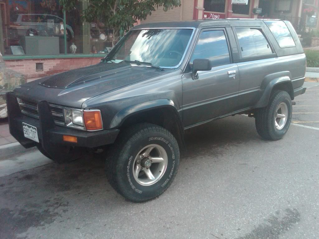

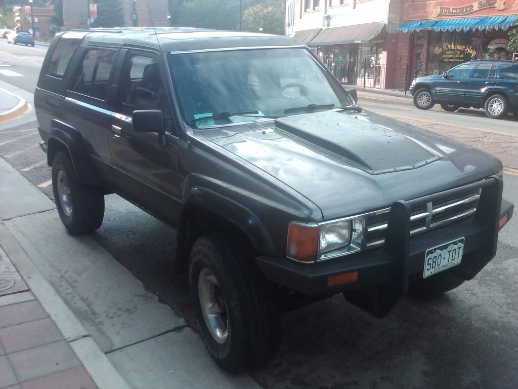

Just an update on how she is doing since the swap was done. Things were running fine but I encountered my first problem during a crazy rain storm. The engine started to lose power and I had to leave it for the night. The next day it started right up again. I got it home and cleaned out the MAF and put some Fuel Injector cleaner in and things seemed to be ok again. Then it happened again and it turned out the O2 sensor was not reading on the computer during the rain, replaced the O2 sensor and all was good.
I have attempted to get the tach working and soldered on the 10k resistor using the instructions I found on the web for the 1st gen but still have nothing. My buddy tried to hook up a wire directly to the tach from another car and still got nothing so I am thinking I have a bad tach.
Sent it up to my body guy and had him put on the hood scoop, touch up the paint job, clean up some rust, and straighten out a the frontend a little. I lost the toyota stripes but it looks pretty nice regardless. I found some cheap 31s on craigslist and put new ball joints and idler arm on it. It rides great now and it flies down the highway!

Taking off to Telluride this coming weekend and plan on doing some of the lighter runs around the area and see how she holds up.
