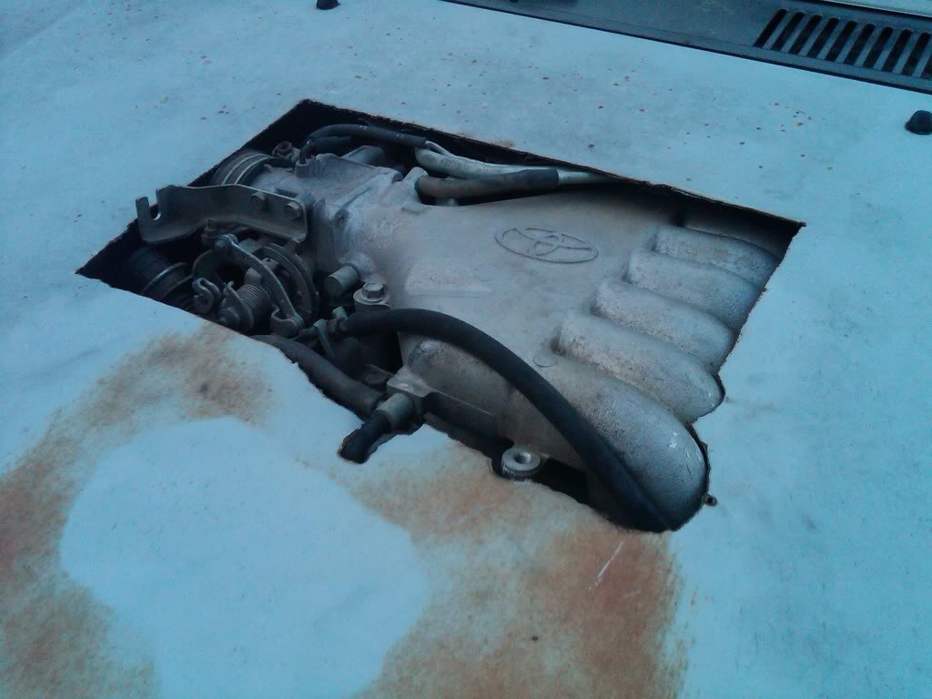

Most of the swap is done, I don't have a tach though. I have a nice hole in my hood just need to get something fabbed up now to cover it. The truck drives great so far just need to tidy up the details.

Old Apr 7, 2010 | 08:31 PM
asg1290's Avatar
Joined: Mar 2009
Posts: 29
From: Wilmington, NC
pics please!
Here ya go
