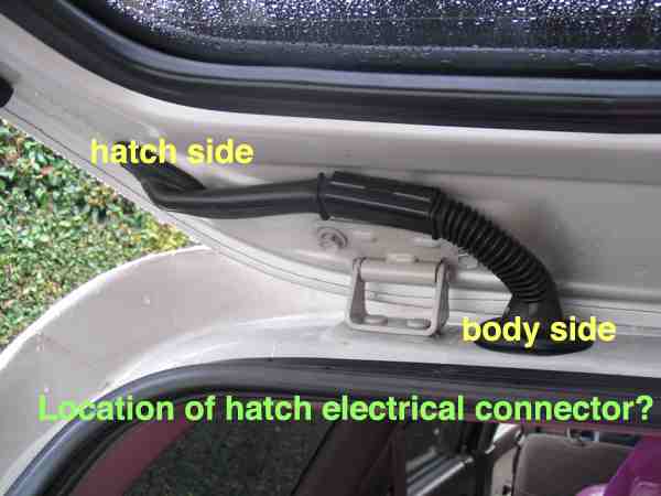

BREAKTHROUGH:
NOTHING on the hatch door works. Wiper, license plate lights and window all do not function. Could this be a simple issue with a plug not being connected with the main body? A fuse issue?
I happened to look at my rear wiper knob and it was turned to 'ON' when I opened my car, probably been that way since I got it. Since its never gone off I assume that means there's a missing connection somewhere.
EDIT: fuse is good, just checked it. could it be a connection somewhere between the hatch and the body?

does anyone know where the connector is between the body and the hatch? I bought a Haynes manual today but its unclear where the connection is. First off, the picture in the manual is of the wiper fluid hose, not the electrical. I got both sides of the wiring exposed but don't see any connections. Is the connector on the body side or door side? How do I get to it?
