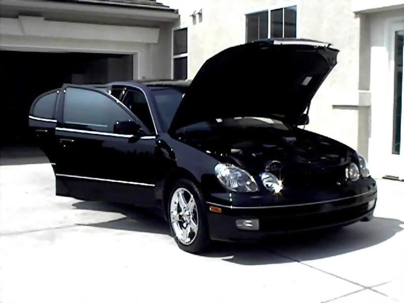

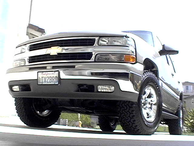

Or for the SUV side of the spectrum...no 4Runner yet.
~Jeron
