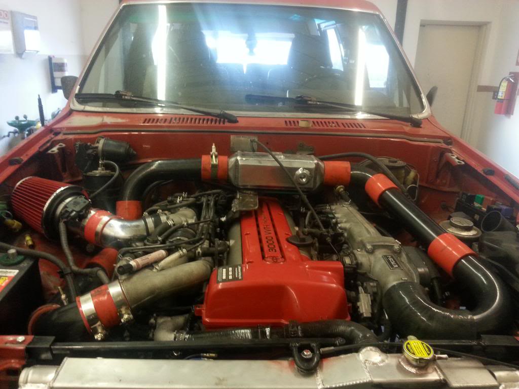

I swapped a 2jzgte and am really happy with it. Its a little too powerful with all of the bpu's just north of 400hp. Its a blast to drive and drift

Thanks for the diesel and 4.3 clarifications. Still doing a lot of reading on the issue. Wow Blake, I'm not really looking for turbo, but that is nice! What did that come out of?

The 2jzgte is nice, very nice!

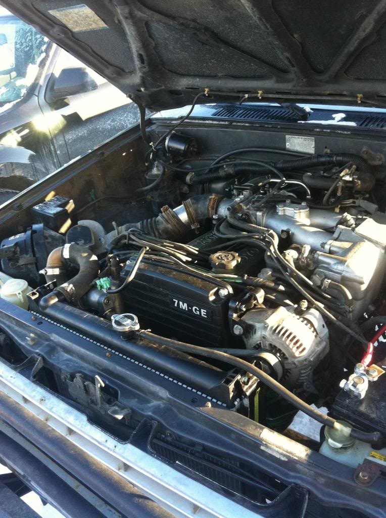

Size:  132.9 KBI have a 7mge swapped '85 extra cab 4x4. I love it! I was originally wanting to put in my 1uz but it wasn't ready to go when my motor went. I just happened to have a freshly rebuilt 7m sitting in my shed so in it went. I didn't have any hood/firewall clearance issues that others have run into. I cut the frame mounts off with a sawzall and re-welded them back on to match the 7m mounts. (I didn't have any 5m motor side mounts. Alternator plugged into stock connector. I straightened out the power steering pressure hose to connect it on the pass. side. I moved the battery to the drivers side. Only about 5 wires needed to get it fired up.

Thanks everyone, the 4.3 and the 7mge look great. Is the performance about the same?
