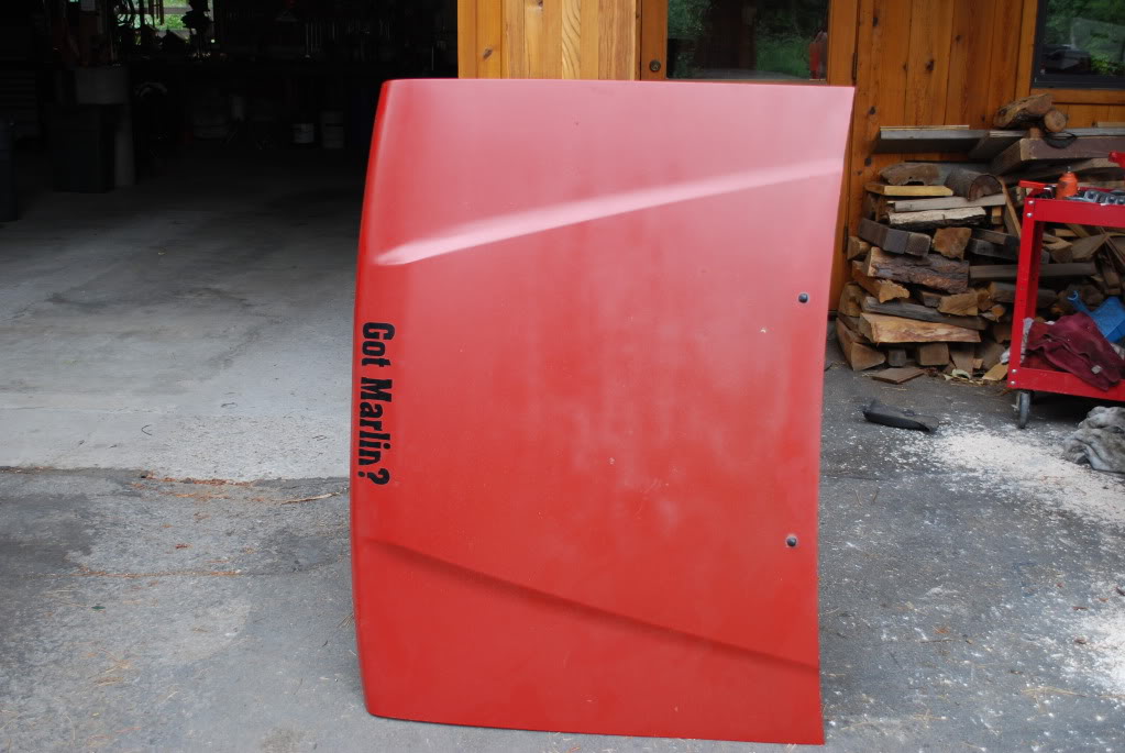

step 1: obviously, pull the hood off.

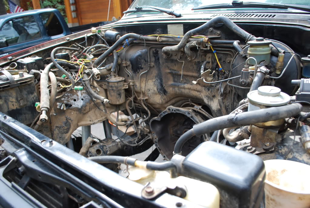

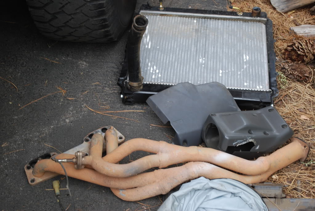

step 3: find everything that is connected to the engine that is also connected to the truck. disconnect all of it. check and re-check. i checked at least 4 times and i still missed a bolt and a ground wire. take the header/manifold off, all the air filter crap off, and vac and electric lines.

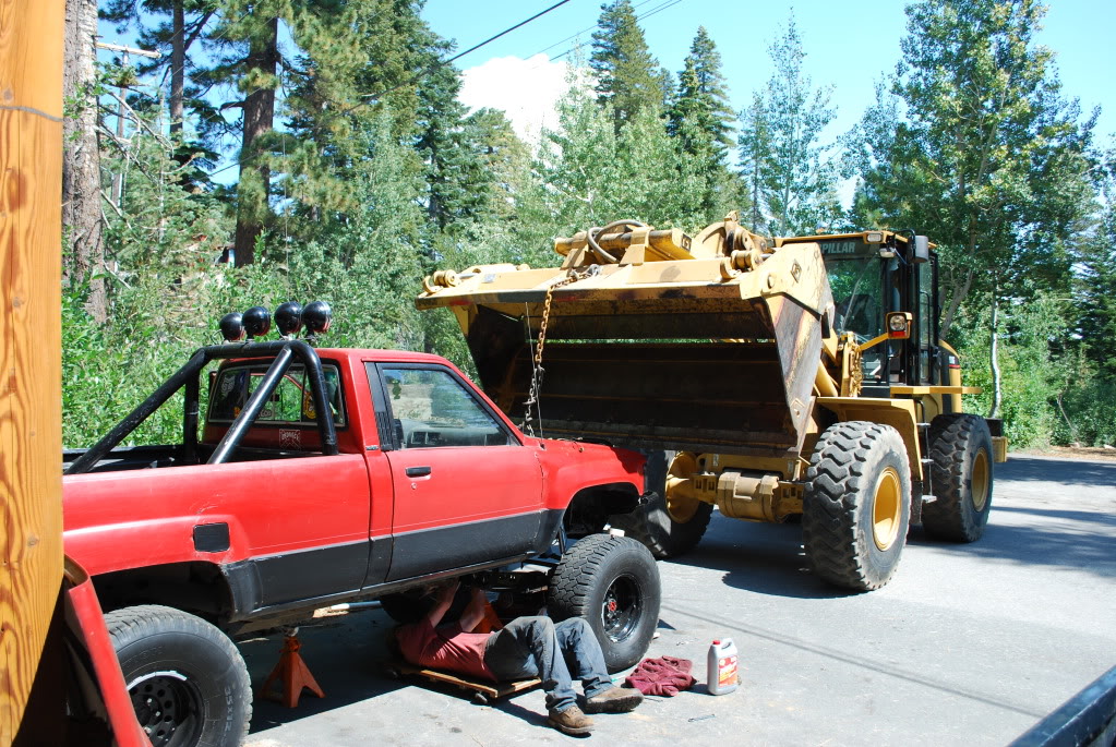

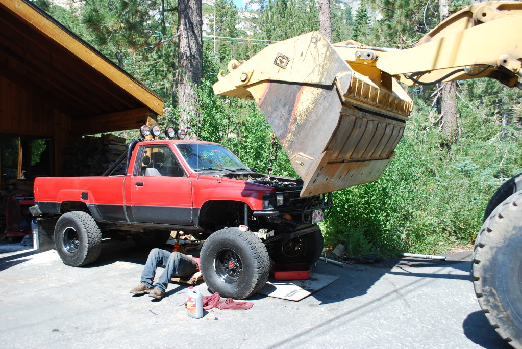

step 4: support the transmission and the engine.

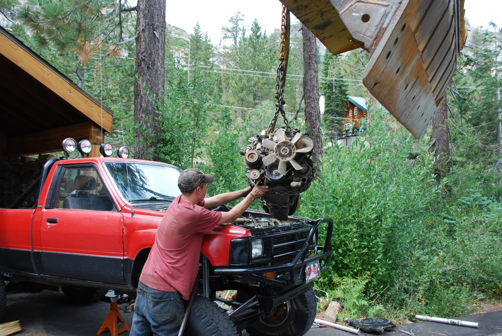

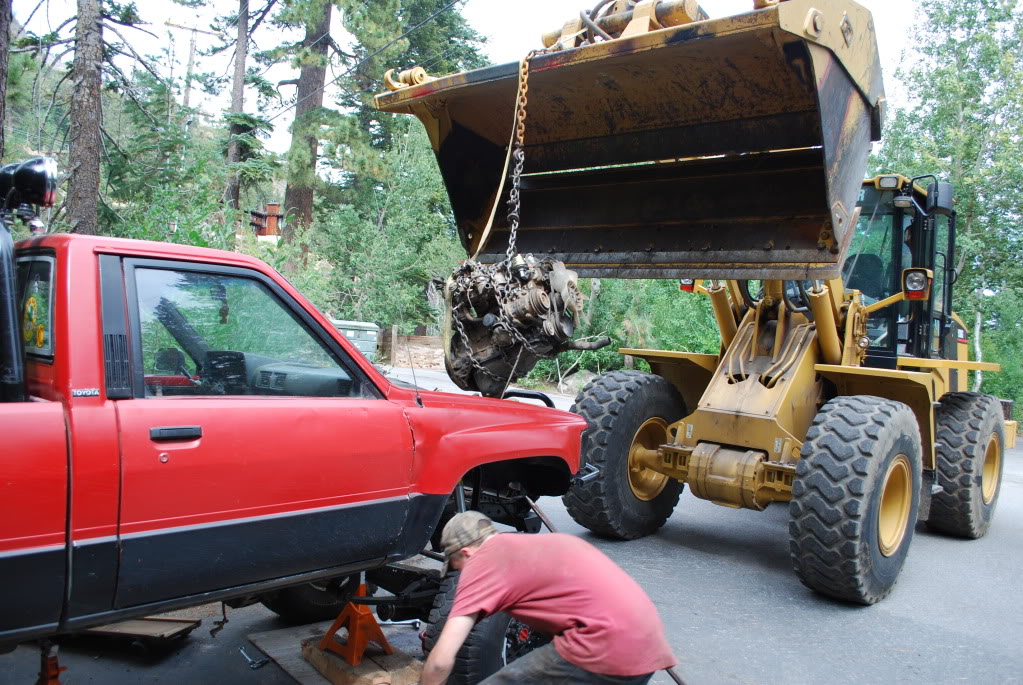

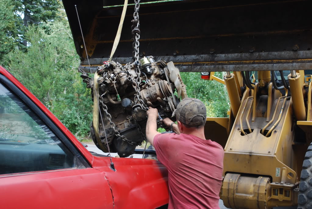

step 7: pull the engine. i had to yank mine a little to get it loose. had a little trouble getting it out of the engine bay because i didnt route the chains right.
oops! missed a wire

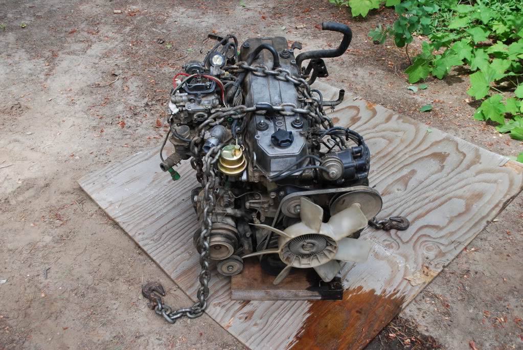

the engines resting spot :gap: by the way, this thing is for sale, if anybody is interested.
empty engine bay

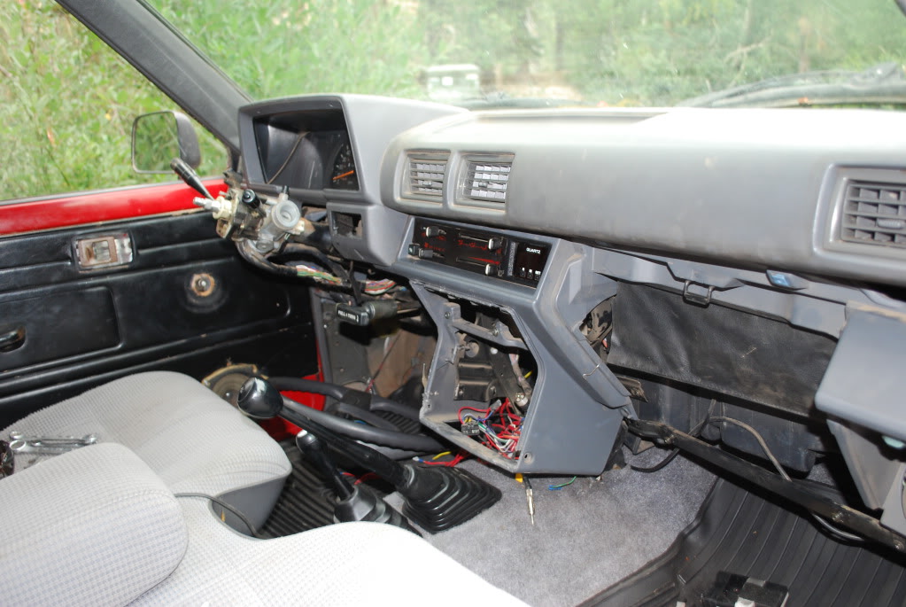

and where im at on the dash- didnt try any more today, still cant find where its being held up at.
