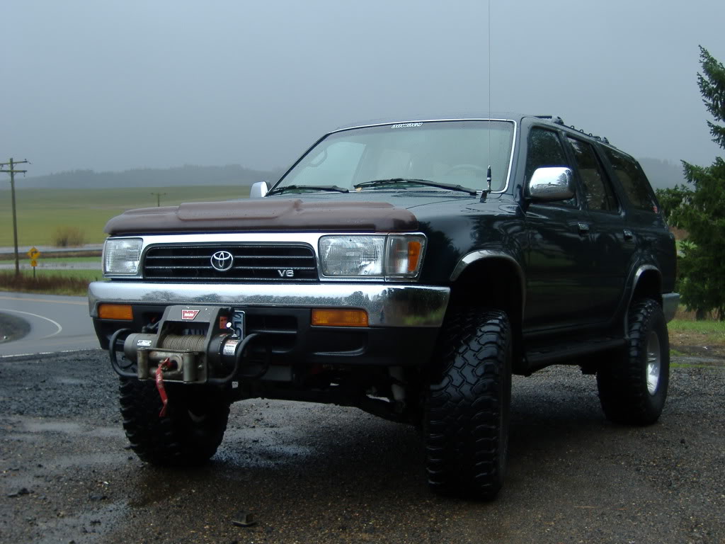

I found a 1uz on CL and have been thinking about doing a swap on my 94 4runner.
I have read enough about both swaps to make my head spin. Some swaps got started but the thread abruptly stops and there is no indication if the swap was successful.
I am looking for those who have completed the swap either way and if they are happy with how it turned out. Things they would have done differently.
I guess it goes like this I wanted the 1uz but it appears that it is much more detailed in what it takes to make it fit and that parts are as not as readily avaliable state side. The 3.4 appears to be much closer to a drop in than the 1uz.
The one 1uz I found had been pulled and crated. The owner bought to do the swap on his rig but decided to sell it and buy a Tundra instead. He says that the wiring harness is there but the afm is gone and one of the timing covers is missing, other than that it is complete. He wants $300 and says it was a runner.
I would either have to buy an inchworm adaptor and use the auto tranny which I would have to find or order a bell housing to use my R150 tranny I have.
The 3.4 would bolt up to my tranny and looks to be less expensive.
Just want to weigh my options from others who have been there. I don't want to go to the 3.4 and be unhappy with the power over the 3.0 I currently have. Dont get me wrong I have the ability, tools, and space to fab up anything my heart desires, but I don't like to do things twice.
Any input would be appriciated, but I am looking for what you have done, not from people who have opinions about what they would do. If you have done it post away.
