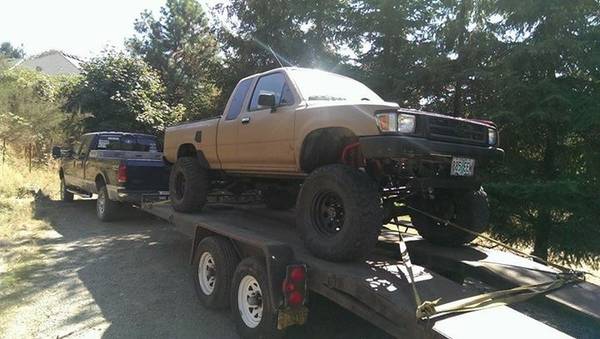

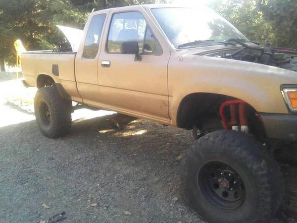

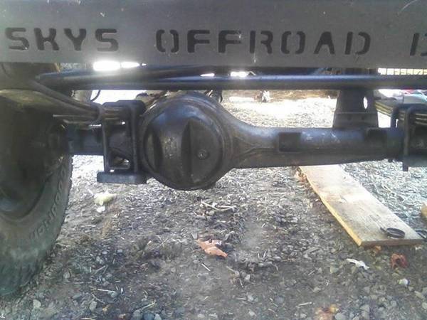

Here are a couple pictures. I know it's not much, it's a'll I have right now. Let me know if you see any issues with

To be honest your pics don't show squat as far as being able to tell anything other than it is an SAS'ed 3rd gen truck on a trailer. You can tell it has a sky's front spring hanger and that is about it.
Almost looks like they used the sky's hanger and did a RUF conversion (rear springs up front)
Most people would have cut off the track bar and steering stabilizer mounts from the front axle.
cycle the steering to make sure it doesn't bind. Etc.
is the spring hanger fully welded on or tacked?
Take a look at several build/ SA conversion threads to get an idea as to what to look for.
