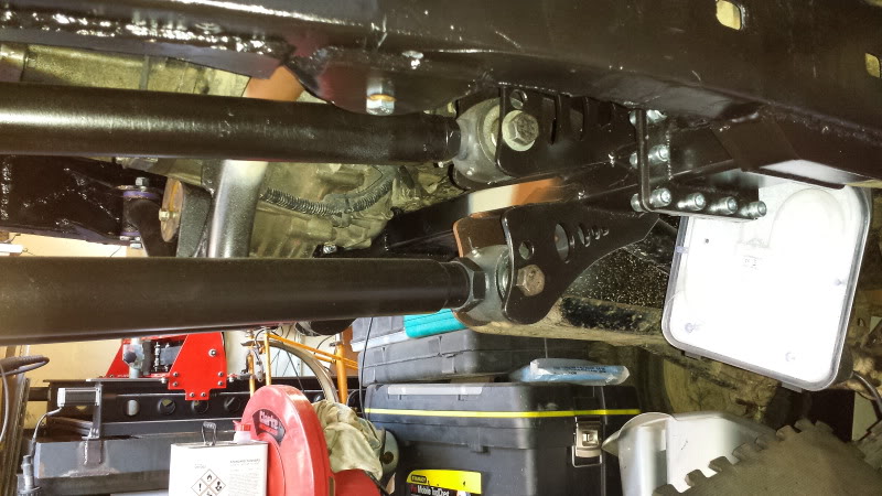

Long overdue updates..

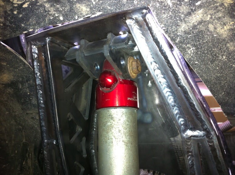

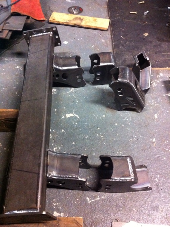

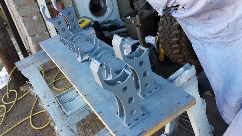

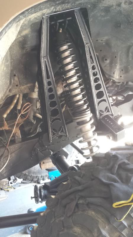

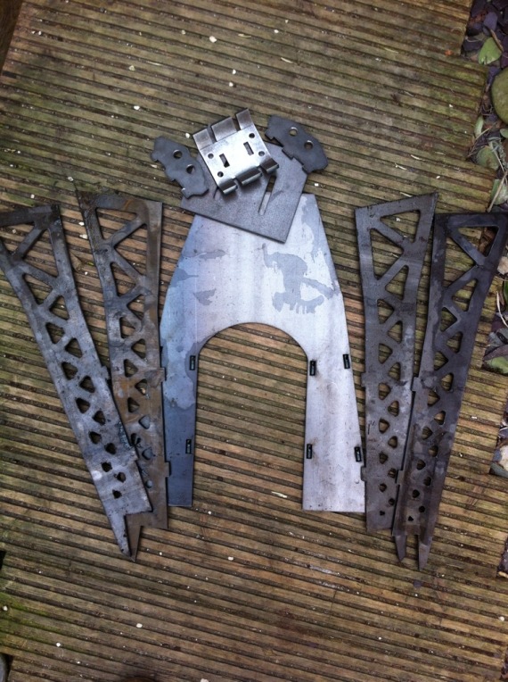

long story short..decided to re-do the front 3-link as I'd bought a Torchmate 4x2' with a view to starting a little fabbing side line, the geometry was a mile out also, and I did decide to plump for coilovers (16" radflo's) as opposed to the swayaways.
K'.. So, front re-do pics..
Shock towers..
Link mounts..
Painting up (new crossmember in there too)
Installed..
There's tons more pics of the build if you follow the pics back to photobucket & a pretty concise build thread over on HPOC.co.uk, but you would have to register to access it.

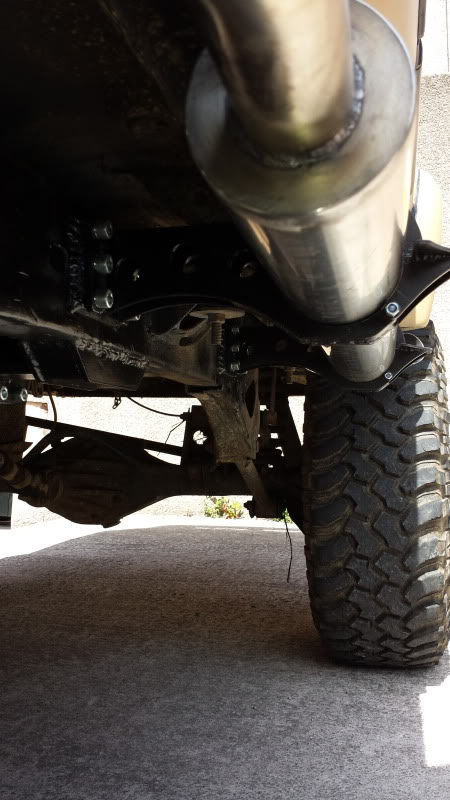

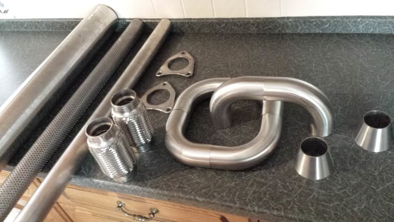

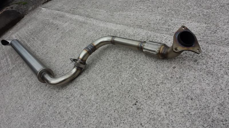

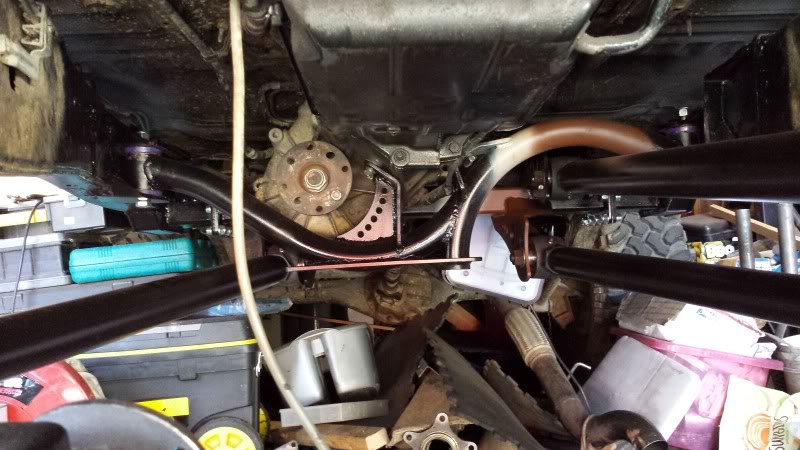

With moving the top link, I had to remake the exhaust. I decided to revisit the side pipes, but make a proper silencer, these sorta act as side steps & the mounts/outriggers are jackable..
Bits..
Stuck together..

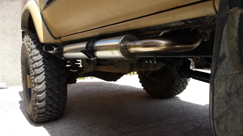

Outriggers..
Mounted up..

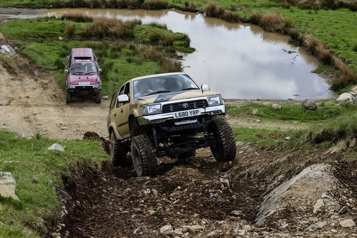

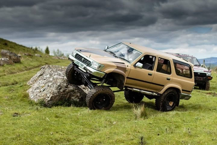

and did a little wheeling..

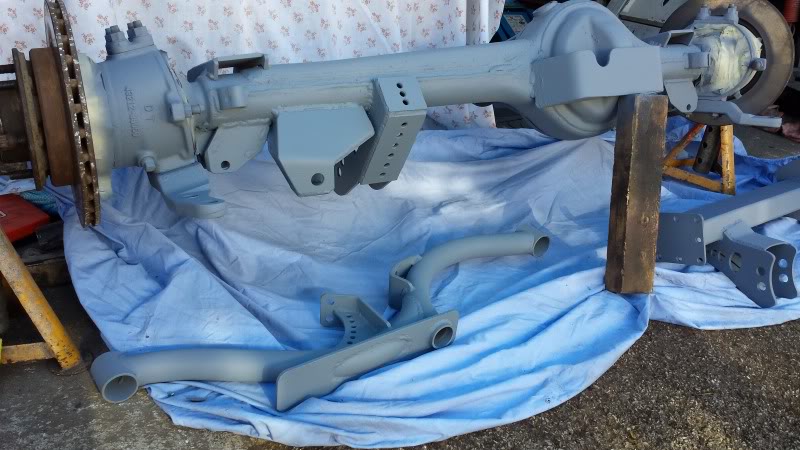

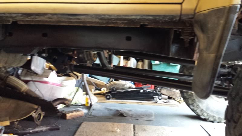

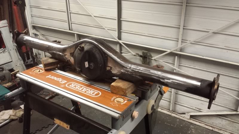

I'm still planning to do the back end..axleis stripped ready now..
I'm pretty sure I'm gonna go 4-link and make a new tank sited where the under slung spare used to live..I know it's not ideal throwing extra weight out past the axle, but with the 1UZ motor, the tank is always empty anyways

Did you use the torchmate for those shock towers? They seem very intricate, any issue with warping the steel? Hoes the new suspension handle? Did you accomplish what you were looking to change?
Nice work, suspension and all your work looks tight.
Cheers!!
Yea, I used the table for 99% of the cutting..
They were cut from relatively big sheets so I don't know if that made any difference, but no warping no.
Better detail of the top..
The top mount is adjustable, albeit only by 30mm or so, but I've tried to build in as much adjustability as possible for fine tuning & future mods/upgrades
It's getting there.. I still need a proper alignment doing (and try tweak the castor a little) as I've only eyeballed it at present. It's night and day from the 1st time round..I don't feel the need for any anti-roll control at the front anymore, where as the airshocks were locked down with limit straps for daily use.
I'm still chasing an issue, when you load or unload the transmission slightly..applying light throttle on and off at say 25-30mph+ it feels to be steering from the back??? I've tried all the rear bushes with a pry bar and they don't seem excessively worn, the left hand lower link-chassis mount has taken a hit from a rock and is bent over slightly but has been that way since I bought it?
I think it's gonna have to wait until the back end is done before I sign off on it properly.

Very sweet work... liking the Martian detailed web work in the cuts... looks very solid...
loving the side pipes... are they meant to double as sliders?... gave me an idea to look into a double skin slider... an inner SS exhaust pipe with an outer layer steel slider tube...
Cheers!!

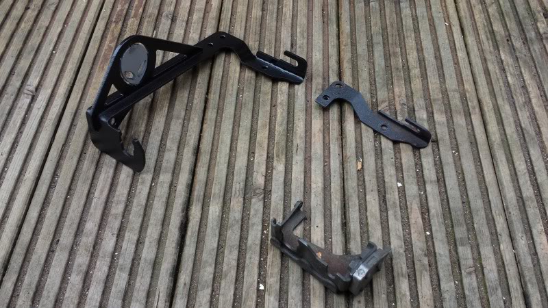

I'm gonna name the truck 'Area 51' and use the same name for that side of any business I get. I run a strut brace from the top of the towers which interfered with the throttle cable bracket so I had to make another..
Drew it up using the existing bits of bracket, shame I stuck my thumb in the paint..I'll touch it up at some point
The brace is only a temp job too..will come up with something fitting eventually
Yea..the pipes will take a hit although I'm not really intending to use them..that first hit is gonna hurt..lol I also plan to run a skid under the silencer, but haven't got round to it yet. The initial plan was something similar to what you're thinking, I was going to run the silencer inside some geometric, stealth bomber looking, boatside, rockslider pod thingy inspired by some of the modern sports bikes Ducati 1199 panigale springs to mind but I had to reign it in due to time and money! Having mounted the outriggers with bolts, I'm open to realise the dream (lol) somewhere down the line.
Mounting detail..
These 'pads' were cut..
consisting of 6 & 3mm plate, then tacked to the chassis, using the pilot holes on the pads I drilled through @ 8.5mm and tapped the lot M10..no mean feat with (x6) on each pad..one of those jobs you wish you hadn't started
