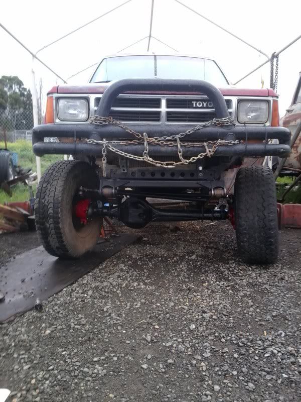

underneath

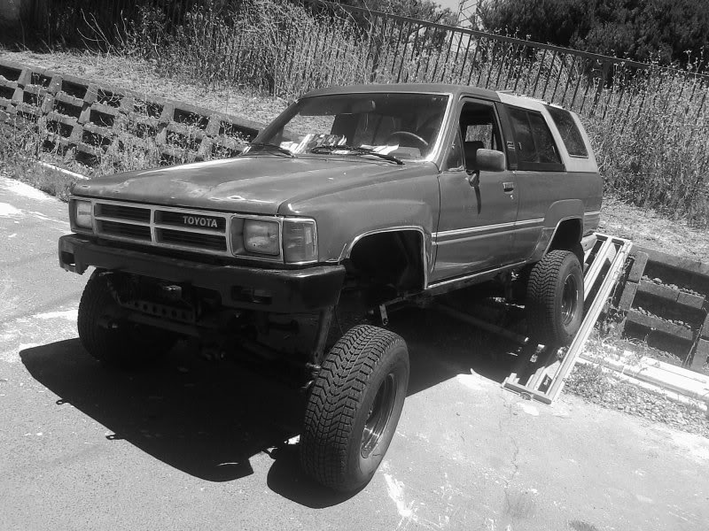

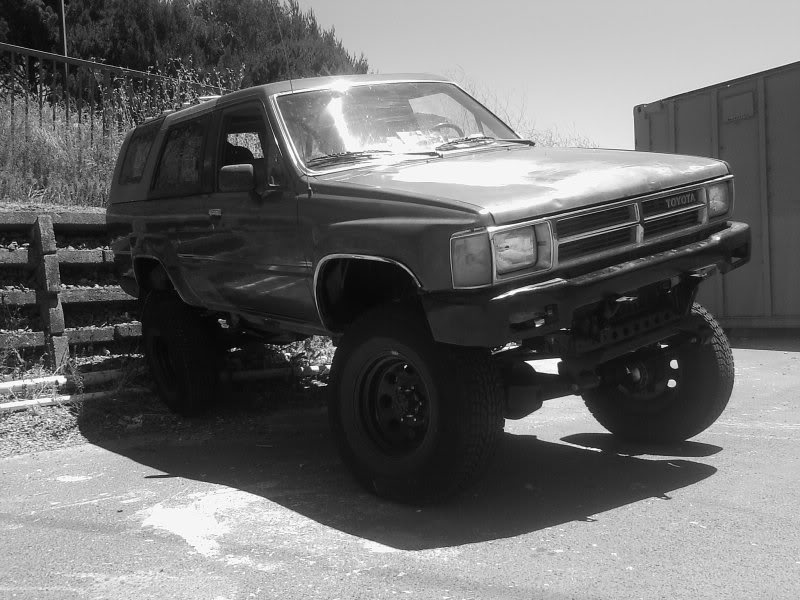

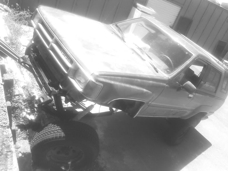

flex

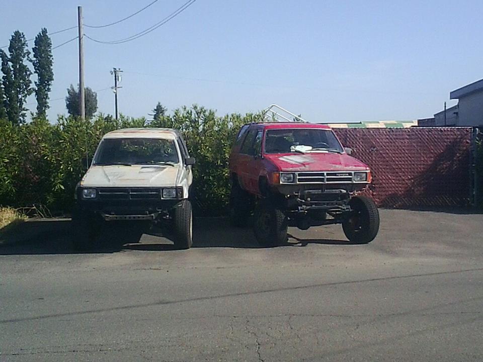

stance compare to the scav

ended up building a square tube d-shaft,went to harbor freight and bought a receiver hitch and a receiver then cut the ball off the hitch. and cut the tubing off my drive-line and took a press and cone and pressed one end on each tubing until the fit perfectly on the drive-shaft end then welded it into place. i also bought a p/s relocation kit from wabfab and relocated my p/s box had to notch the core support but not to much since i have the body lift.
i get a lil vibration under 15mph and then it goes away until 60mph but im not complaining considering i only paid less then $45 and got a free mini led flash light and volt/ohm/current meter also.

SICK!!!!!!! WOW, seriously, I knewit wud be flexy, but WOW! Nice work!
Old Jan 20, 2013 | 06:24 PM
  #63
twistedyota's Avatar
Joined: Nov 2008
Posts: 1,212
From: Napa, CA
Yea I have 12" travel shocks in the fron and they just about max out both ways
