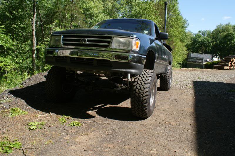

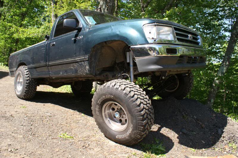

ok finally!! picture!!! btw thats a 2" body lift with pro comp 35s mud terrians i just threw on the other day and sorry about the ty quality pictures i dont have a digital camera so i used my cell phone

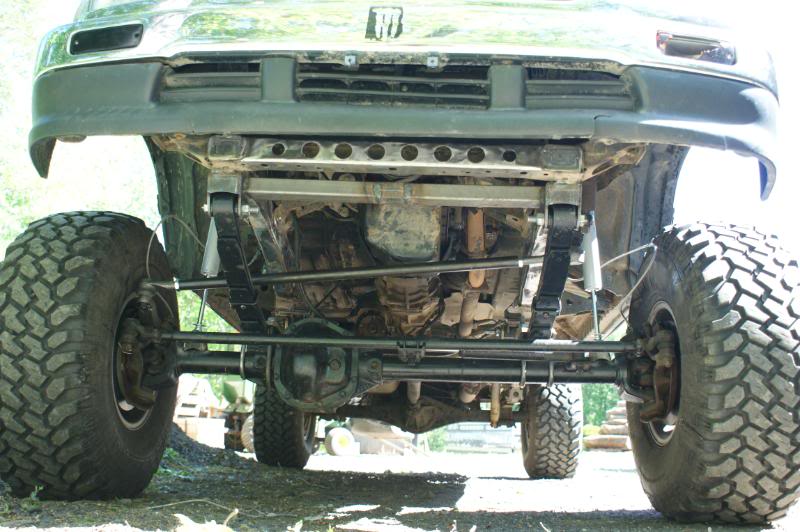

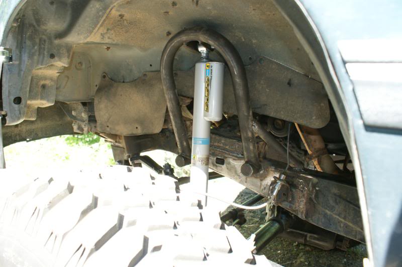

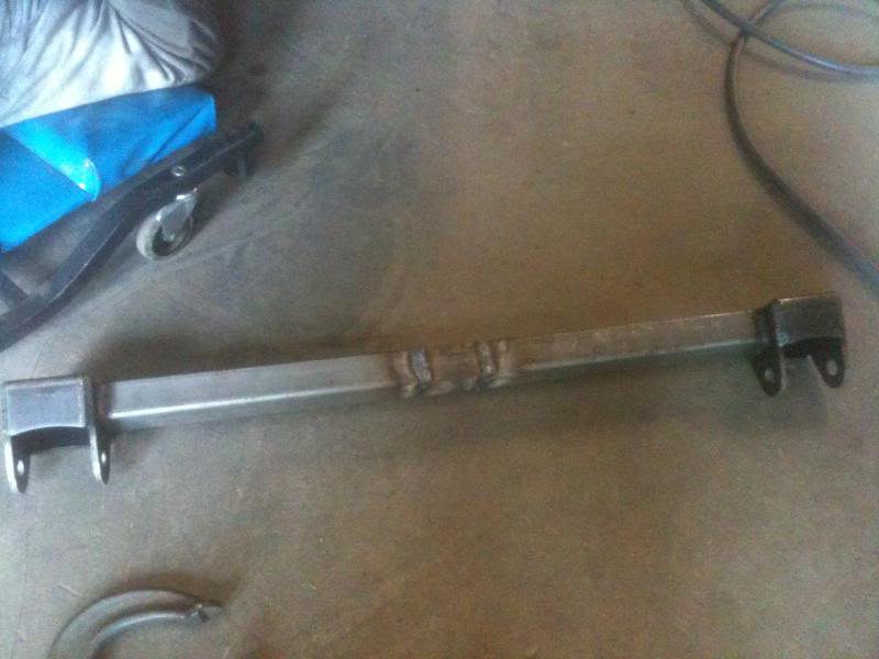

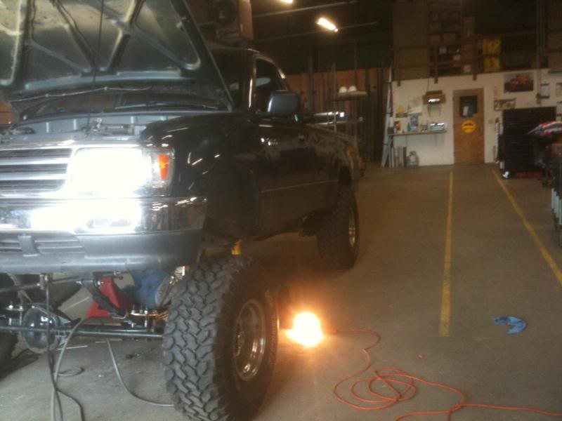

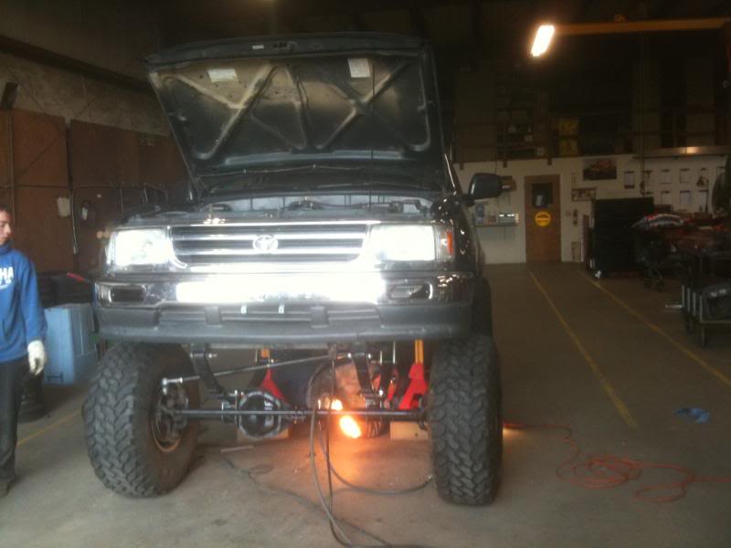

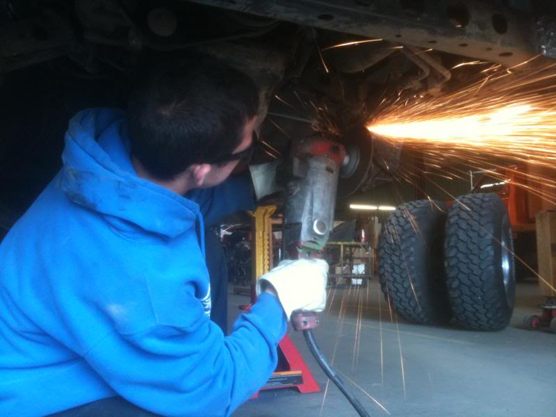

finally its done! btw i got everything suspension related from inchworm gear 4" toyota leaf springs on stock chevy perch mounts (bolted rite up no problem), 14" shock hoops, 14inch travel bilstein shocks with the biggy-back resevior (really squishy ride =]) and the brakes are a million times better then stock ifs....i got my dana 44 steering arm from shakerbuilt.com and my drag link, tie rod ends, and pitman arm from front range offroad

my shock hoops all in

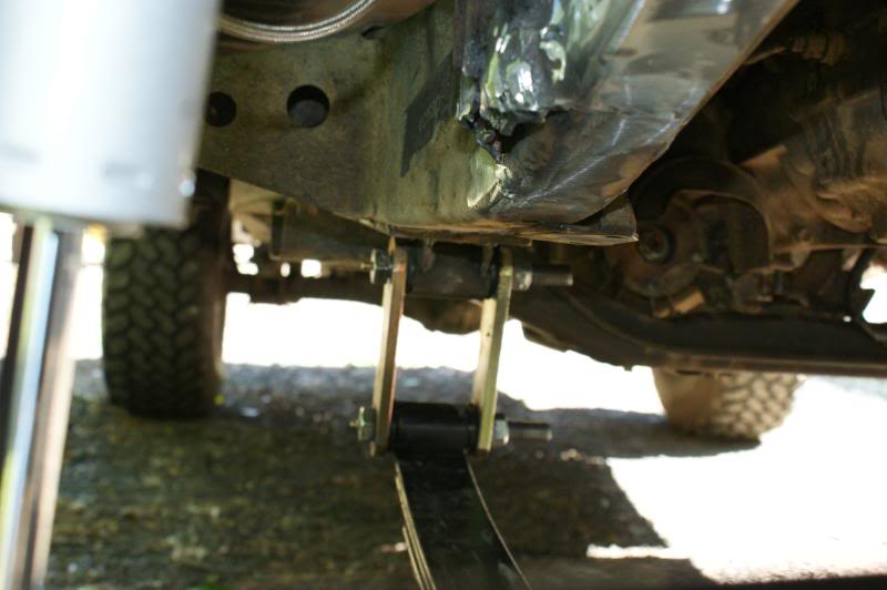

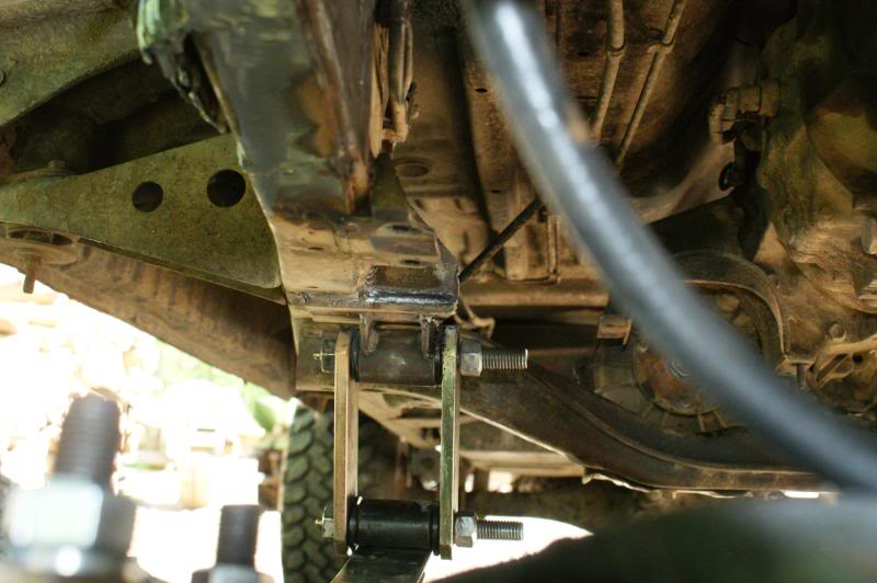

since the frame on the t100s widen where the shackles mount, i welded some plated for more surface and used the shackle mounts from inchworm gear

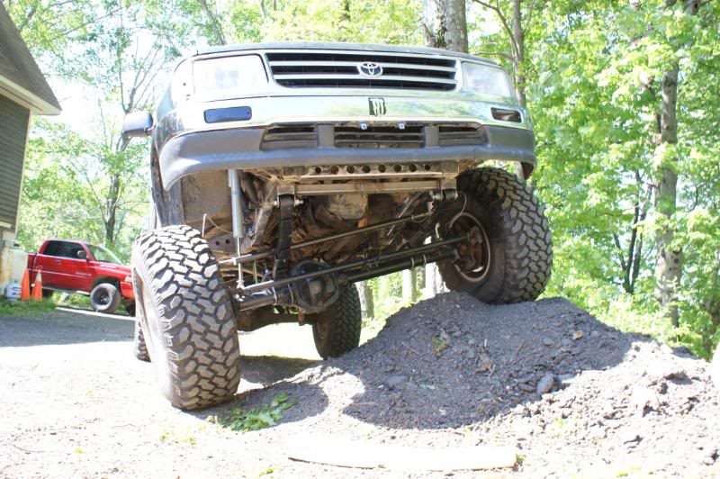

flexing

wasnt even flexed out all the way still had a couple 3 to4 inches to go on the travel
