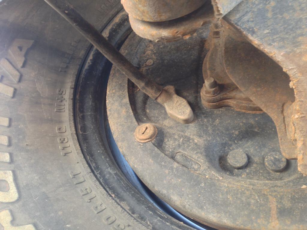

Wanna trade tires? Good lord what I wouldn't give for some 35x10.5r15 Centipedes(don't know if yours are that size, but that's the size I'd rock). Looks like a solid, capable rig, and I could totally rock a Slamurai, too...if I'd fit in one.
Ok, clarification on which cable you're needing, it's not the Celica cable, right? Slightly different fitting? The one you posted a pic of on the axle doesn't look like it has any bolts holding it in place or anything, really it looks(externally) exactly like mine. Which I'm about 90% sure is a Hilux Surf everywhere but North America.

Let me clear this then .. I need to ID my rear axle (realised the front one is more of a problem to ID than the rear and it is not important to ID the front one for now) to be able to get myself a hand brake cable. The part I pulled off my axle - this:
is how the steel part of the cable enter the wheel hub and attach to this lever:
I used the Celica cable as an example of it having the same fitting as I removed from my axle.
The drum brake setup on my Runner is exactly the same inside, same parking brake lever.

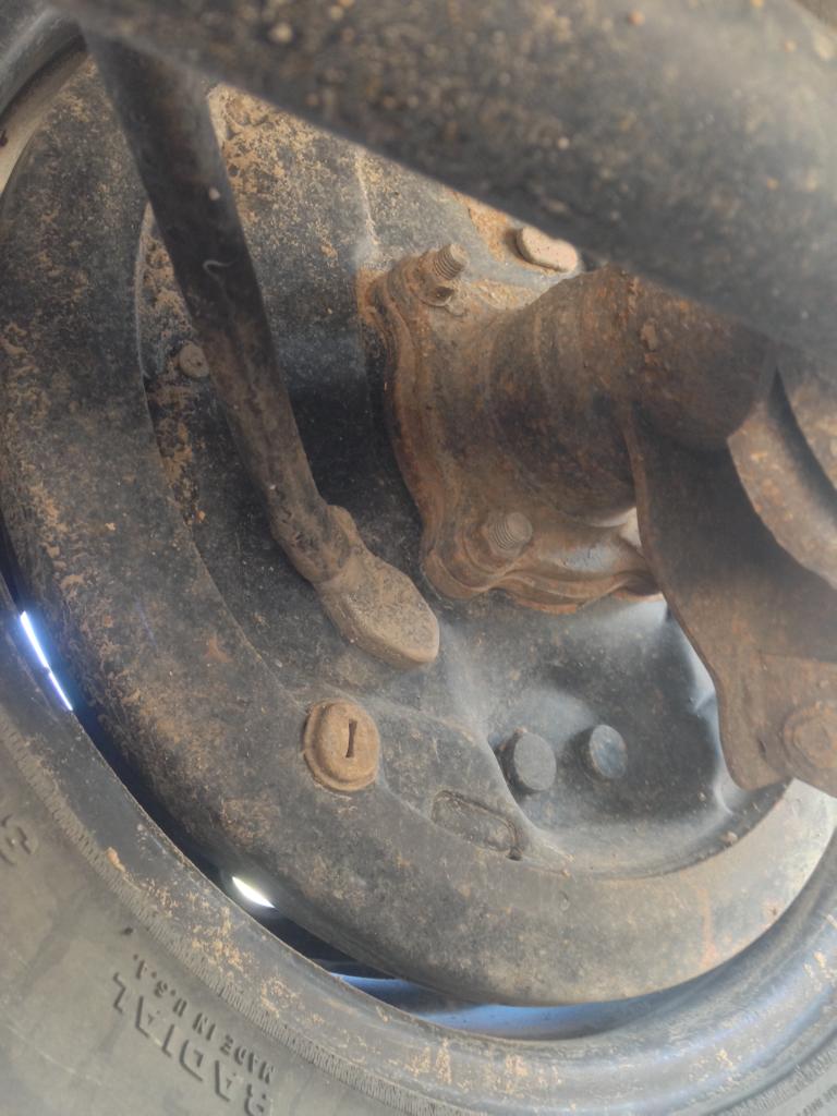

Originally Posted by JoeConti
Great. Any chance of a picture where the cable enters the drum from the inner under side of the vehicle please?
That was the first picture that I posted up. From in front of the axle, passenger side
From right below the axle, passenger side

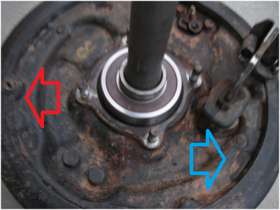

Update:
Changed shaft and wheel hubs with an LN 107 model. This way I know for sure I can find a handbrake cable locally. Here's what it looks like.
What I am not too sure of now is if the handbrake lever on the back side of the wheel hub should be on the rear side of the vehicle or front.
Which is the front, the red or the blue arrow? Will it make any difference which way it faces because if it should be facing the rear of the vehicle then that lever is in the wrong position because of a bump stop.
Thanks

I remember my '83 pickup(Hilux, frame code RN38, I think) had the lever in the rear of the axle. I couldn't say if it'll make a big difference, though

I'm thinking out loud.
When I reverse and put my foot on the brake it works fine. Same as engaging the parking brake while parked facing uphill (in Malta it is very common)
The suspension bump stop is in the way of the parking brake cable but if I swap the left and right wheel hubs complete with shafts then the lever will be in the front side of the axle with a clear view for the parking brake cable to be install and fitted. Agree?
