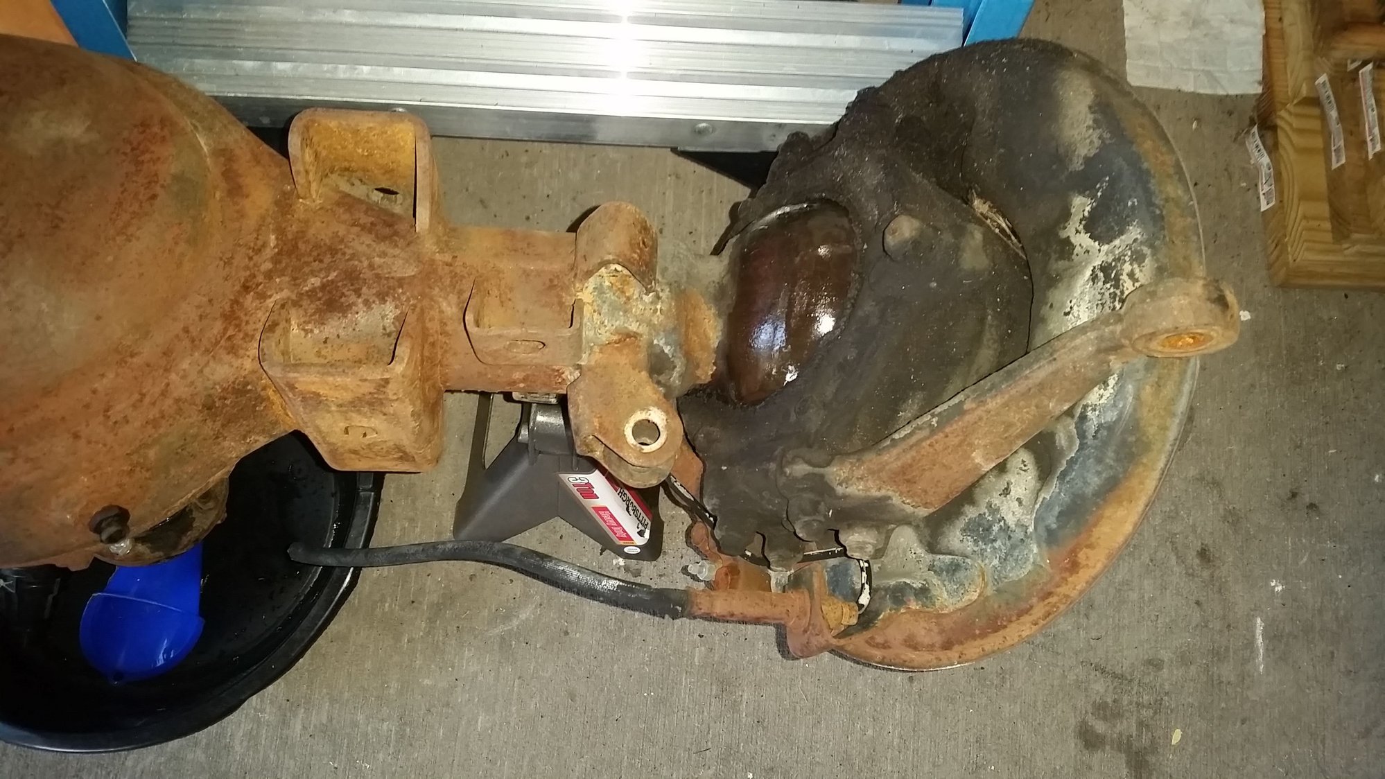

Got those rotted tires and rusty old wagon wheels off.
Right knuckle ball close up.
Left knuckle ball close up.
Slow steady progress...
Here's a tip for your pitted knuckle balls, a little pitting probably wont be a big deal but your pic looks like it may be "grooved" like my axle was. Clean them up best you can with a wire wheel then resurface them with JB Weld. Mine were as bad or worse than yours. One side had the trunion bearings completely blown which allowed the knuckles to carve a groove in the ball.
Heres the after result
It sounds hillbilly and hokey rigged but the trunions support all the load, the balls just act as a sealing surface to keep grease in and water out. After wire wheel clean them real good with alcohol or the like before applying the JB. Use emery cloth to smooth and round the hardened JB weld. Good luck, Hope this helps.
Thanks! It's not hillbilly at all. I have read about the JB Weld on the knuckle balls quite a bit and I planned on doing it. This axle wasn't taken care of so I knew I had my work cut out for me from the very beginning. Nothing a little patience and a lot of research here on the ol' Yotatech won't get me through.
