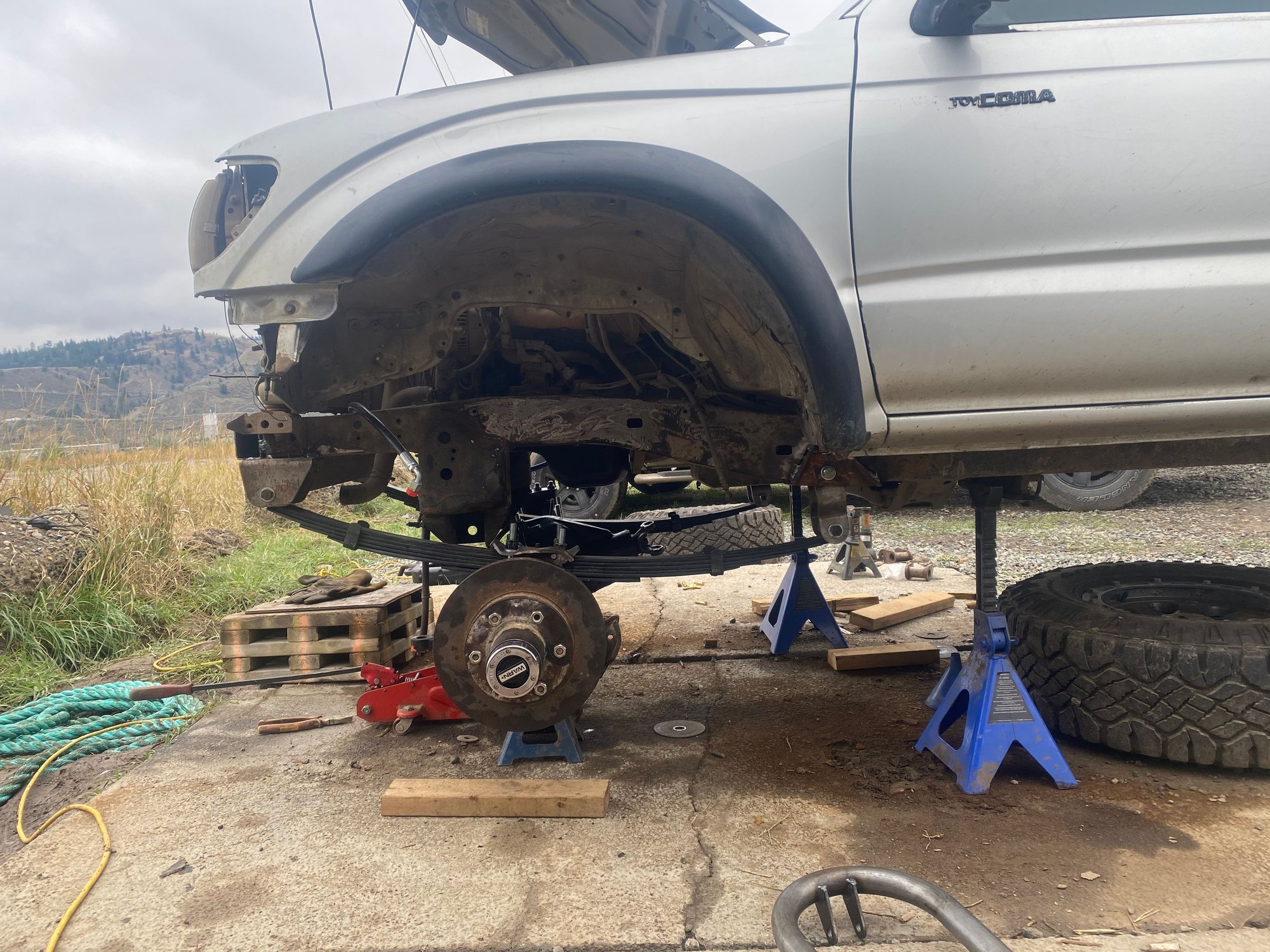

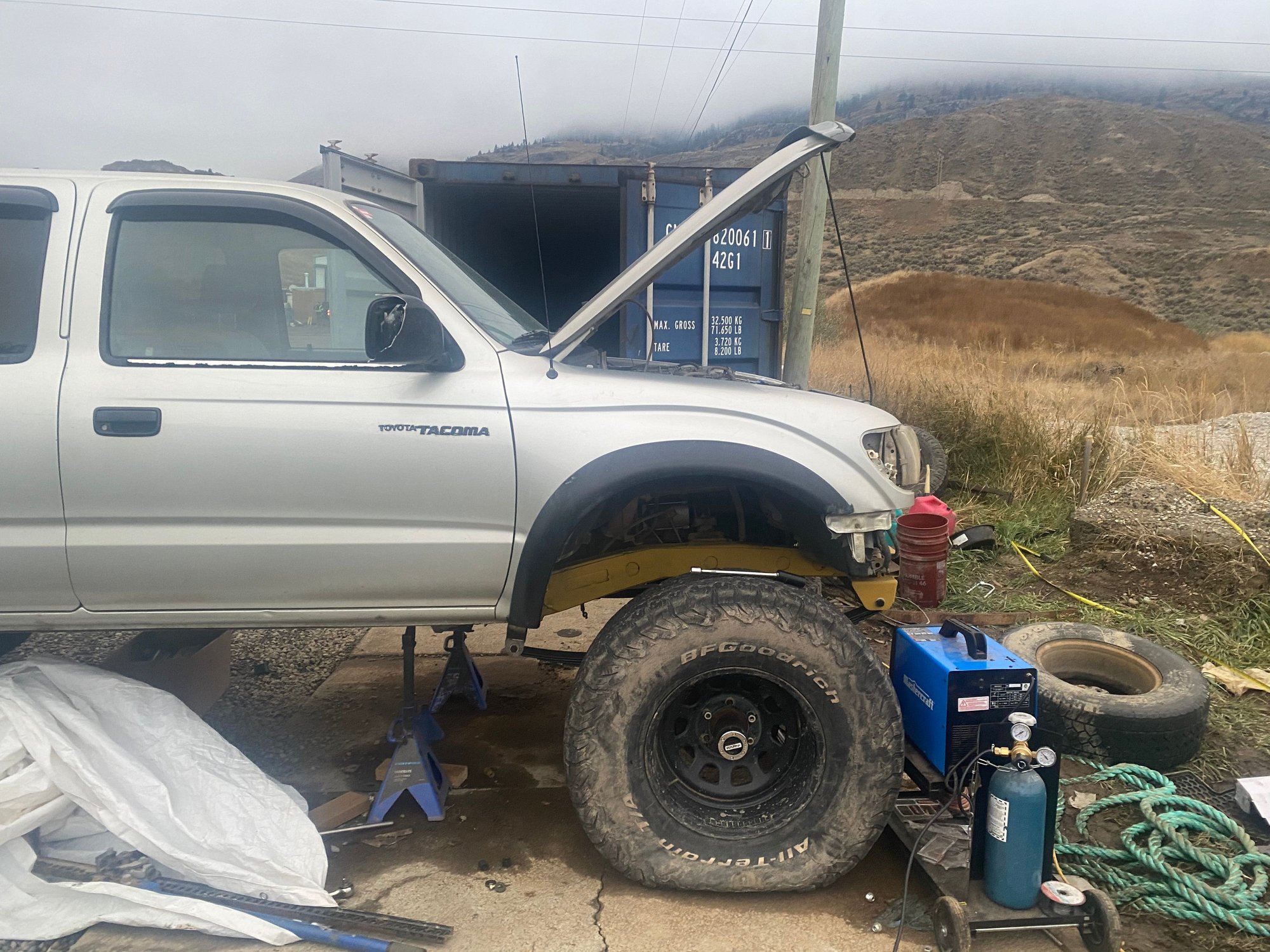

Picture of Rig before beginning (see a reason for more suspension travel??)

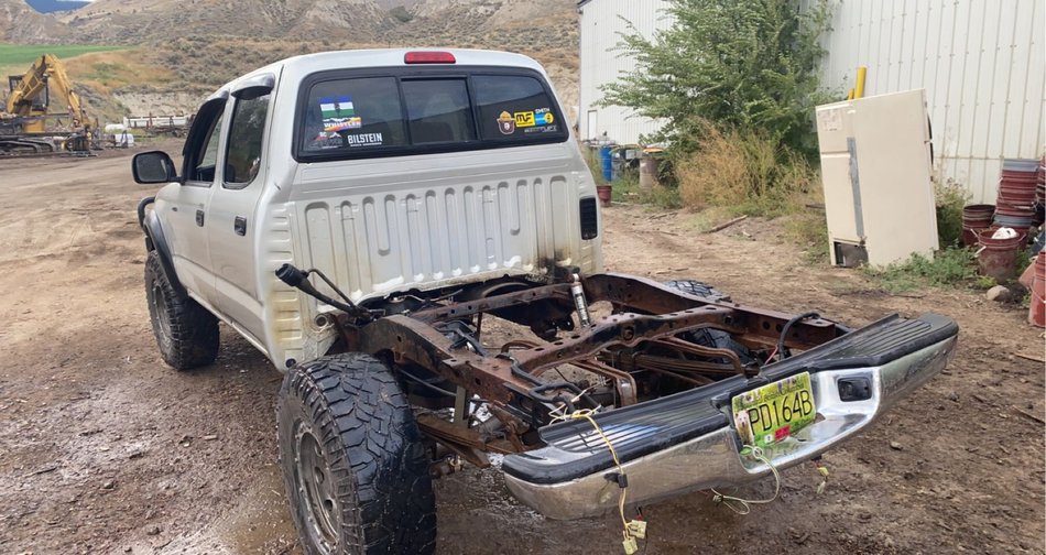

Beginning with the rear. First night. Took off the box and wiring, pressure washed underneath to look for rust. Found a small amount in the channel of the frame. One more thing added to the list

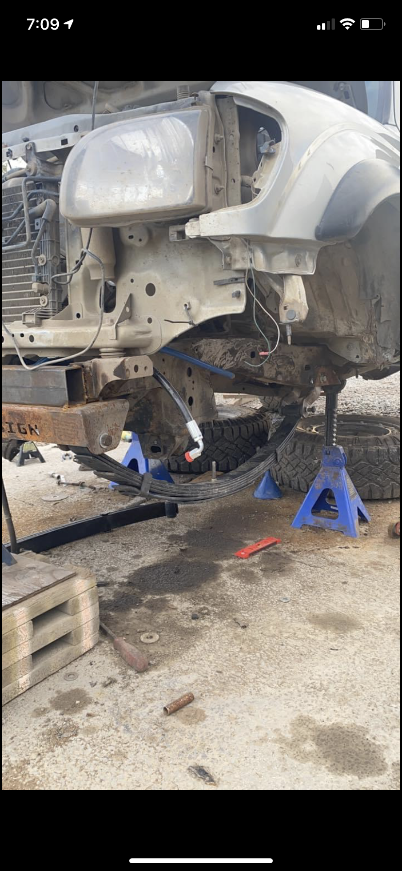

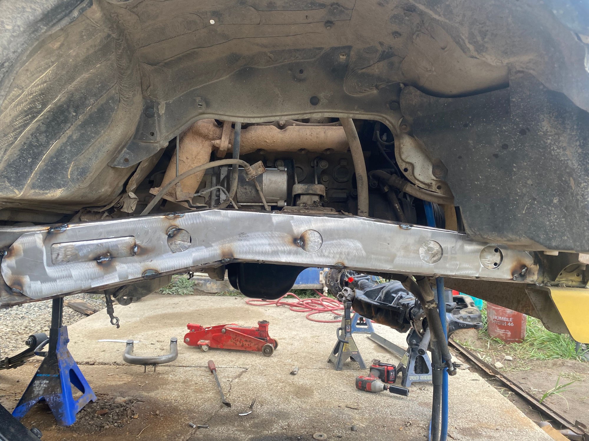

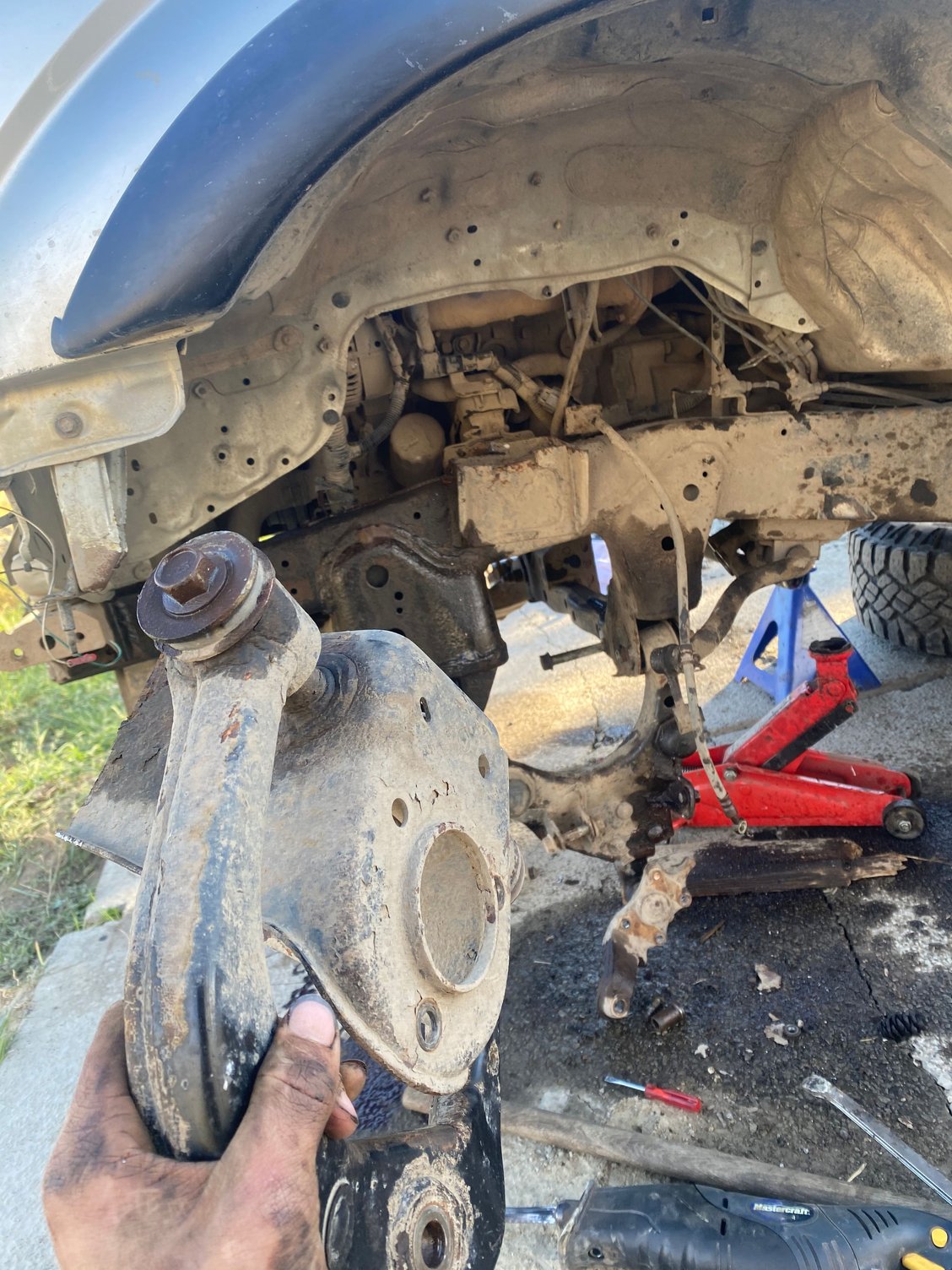

Little update here, due to wait time on shipping parts from the states (I’m in Canada) I have decided to begin on the front end. Currently I’ve removed the front differential and associated connectors,steering rack and lines, all suspension components and the rear crossmember. (No turning back now!) Leaving the front crossmember in until I can weld the new front crossmember so the frame rails don’t spread.

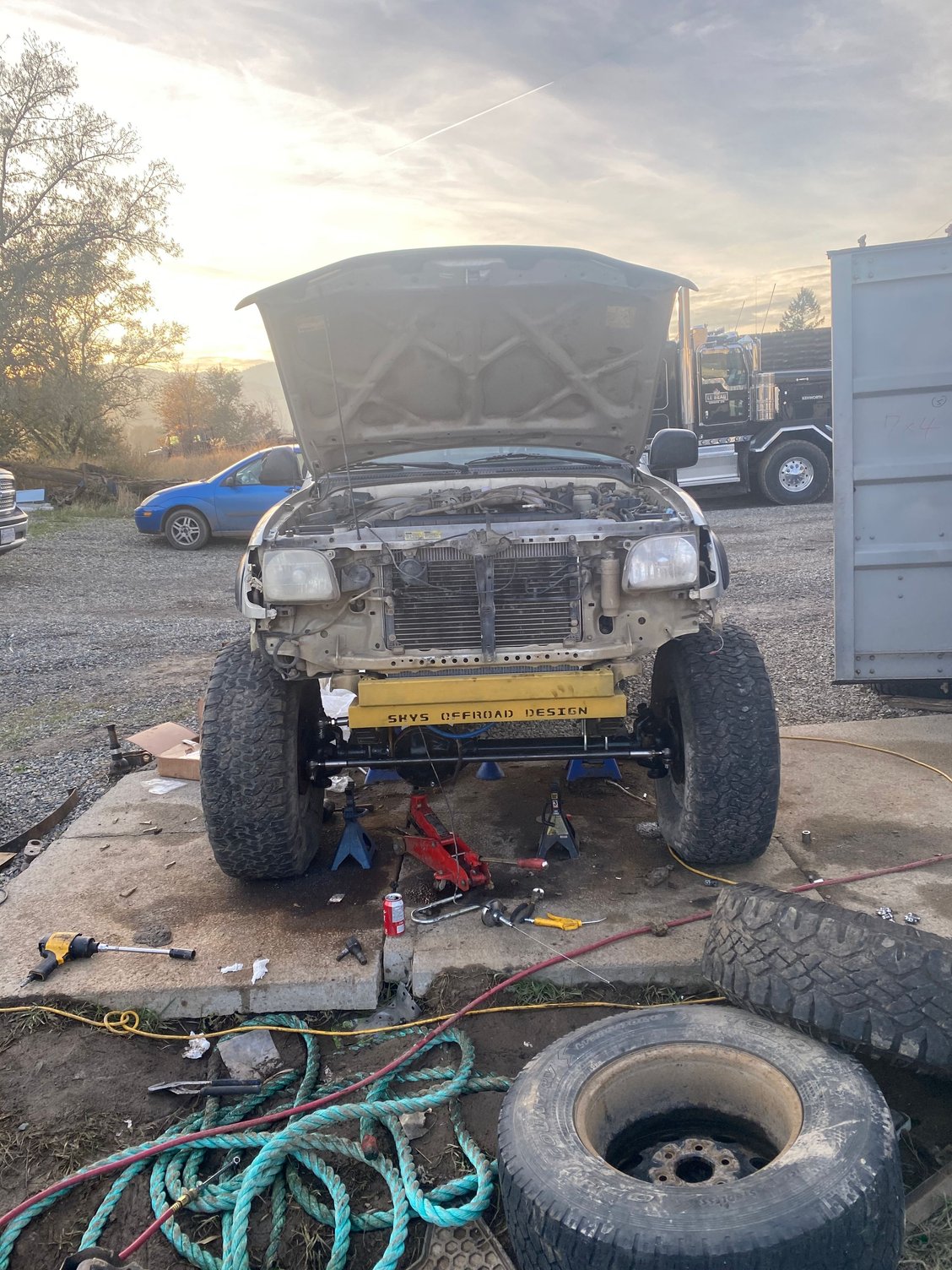

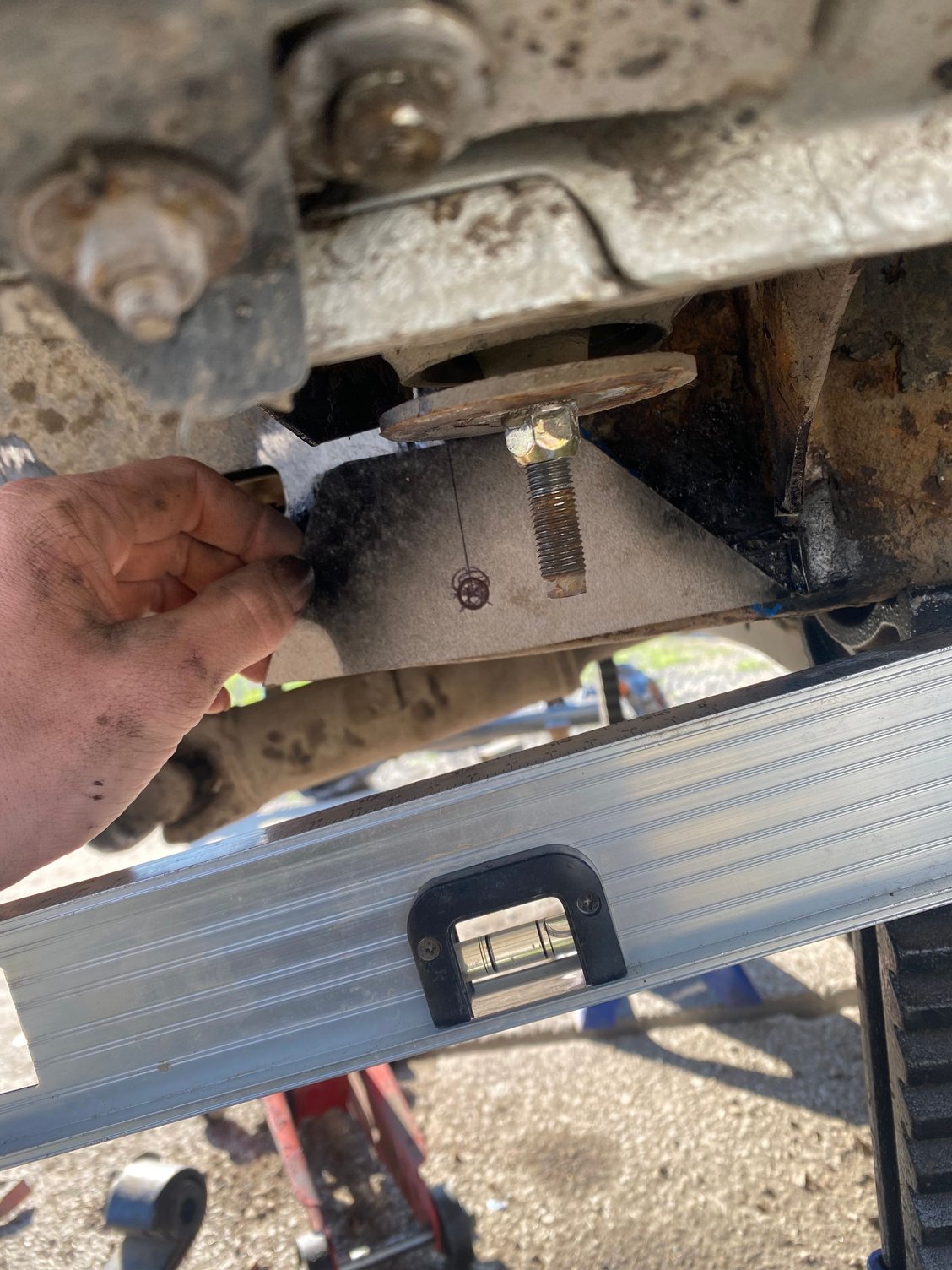

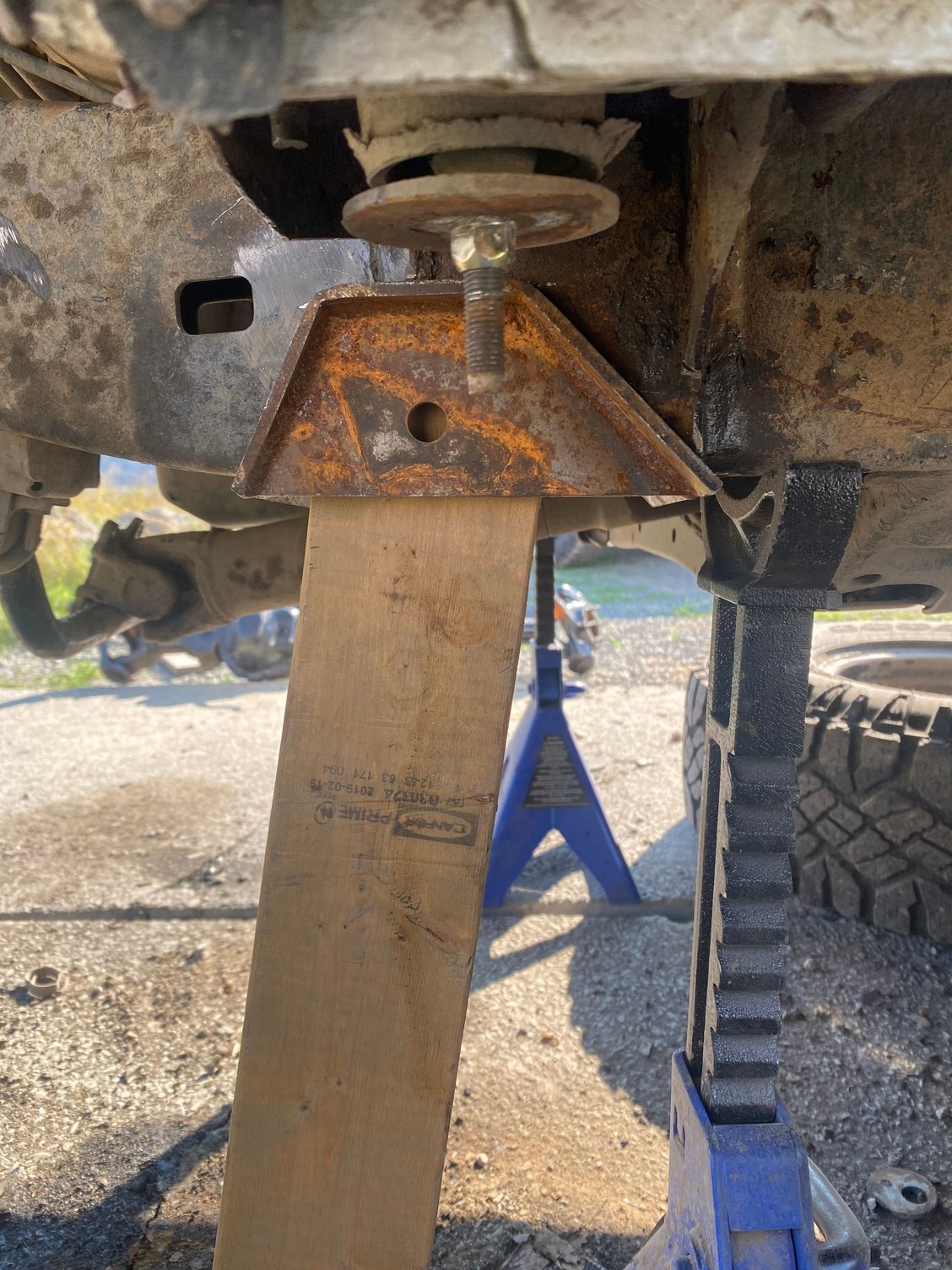

Began the scary part today. Started by making a cardboard cut out of the shackle hanger. It’s fairly difficult to measure because you have to keep the hanger parallel to the flat of the frame, not the rounded part. So I marked where I wanted it to be based on sky’s off roads instructions. Went 3/8” ahead because I didn’t like how steep the shackle angle is. Held the cut out up parallel. Used spray paint to mark the negative of the hanger then clamped a level to the straight of the frame to get the bottoms line deadstraight. Repeat on the inside. And cut with grinder

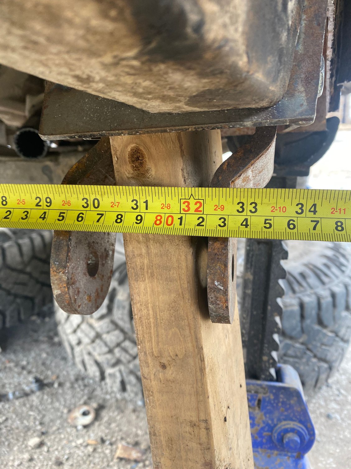

Got the shackles mocked up and ran into a problem. They measured 32.75” centre to centre. Full width is 31.5. Messaged sky’s about this issue and there was a re-design about a year ago because the offset of the shackles were wrong. They’re getting me hooked up but it’s gonna be a while to ship in Canada.

Parts showed up! Mocked up the springs and they worked perfectly. But I ran into another issue. The 48” trail gear 3” springs are about 2” short of Where I want to keep my axle forward to my liking. I have found some 3rd gen pickup rear main leafs local to me I’m going to try out. They measure at 51”. Trying not to move the front cross member back unless needed

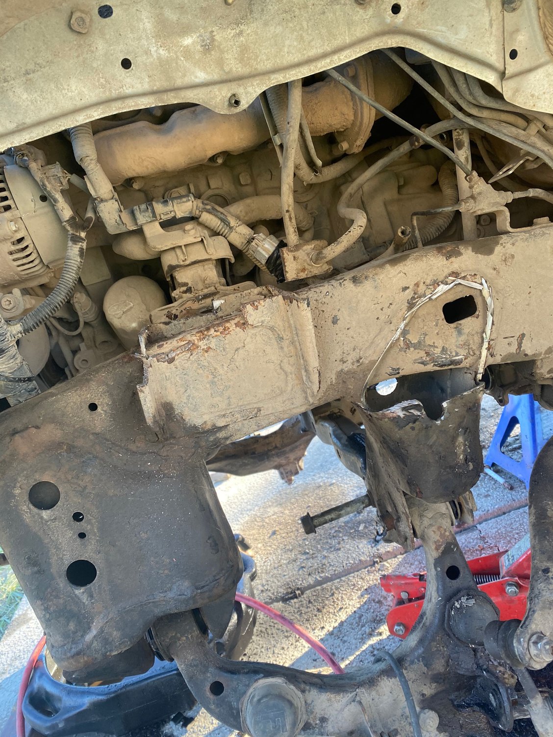

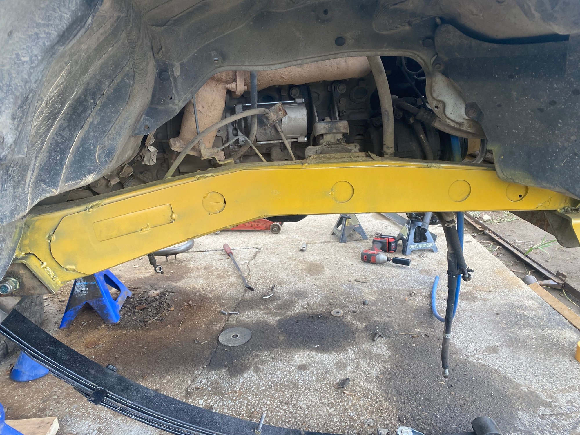

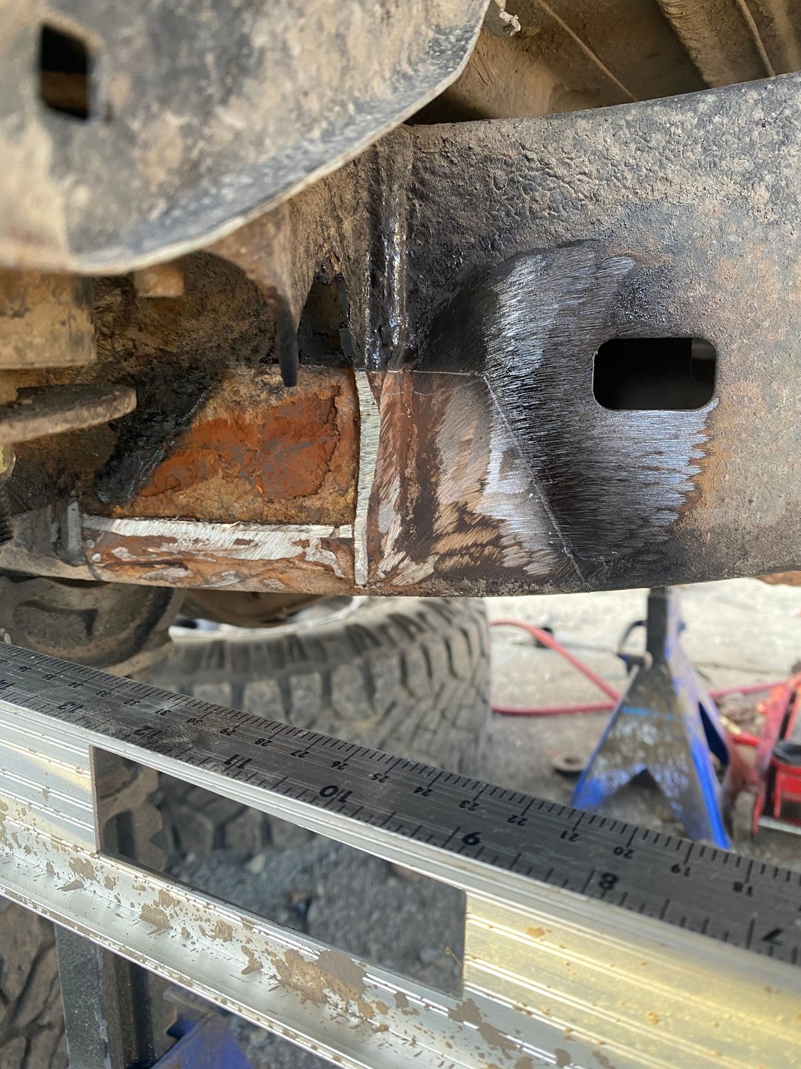

After cutting the front cross member out I cleaned up the passenger side frame and tacked in the frame plate. Put some primer on it so it doesn’t rust waiting to be finishwelded. Holding off on doing the drivers side until I get the steering installed

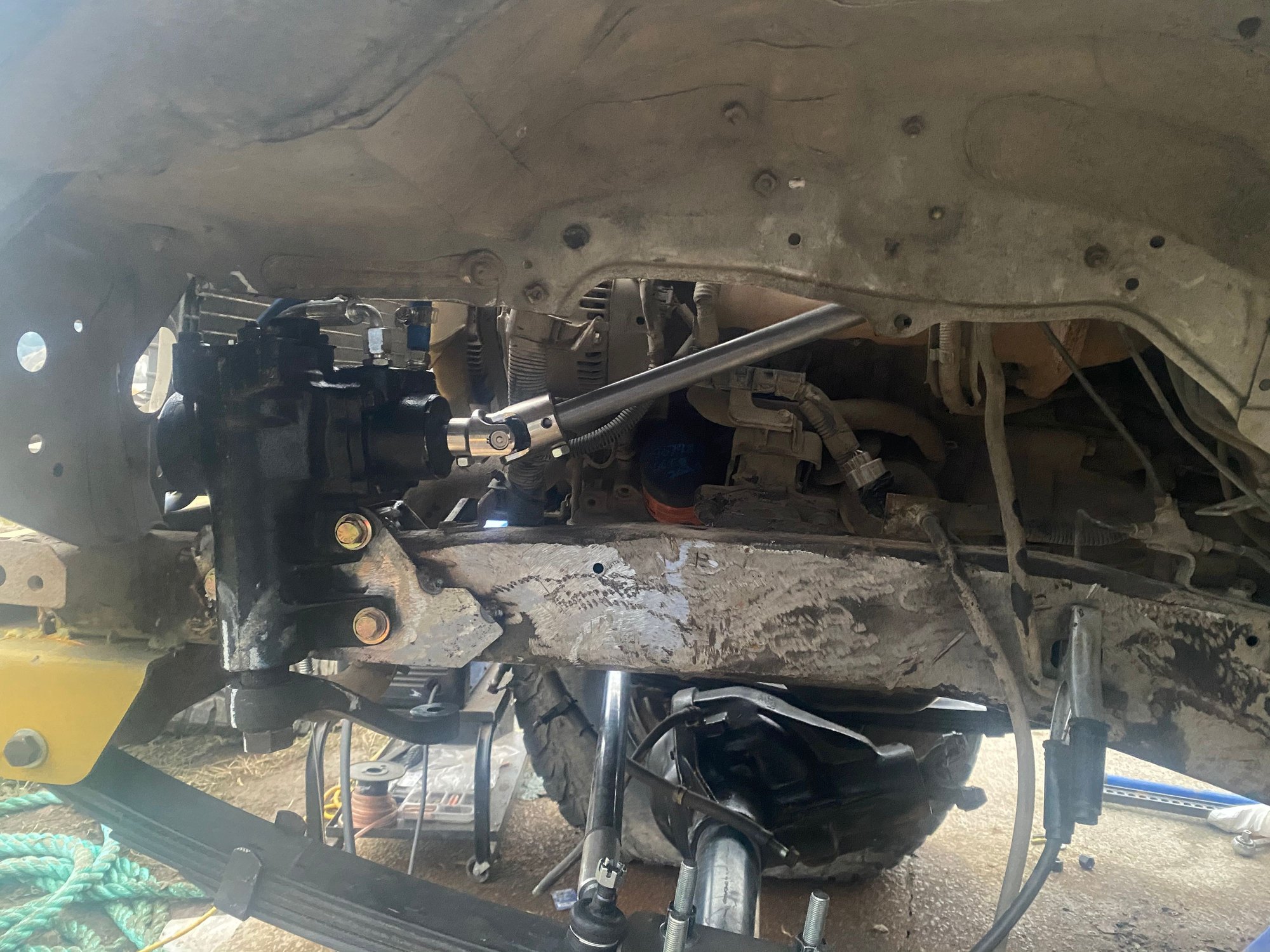

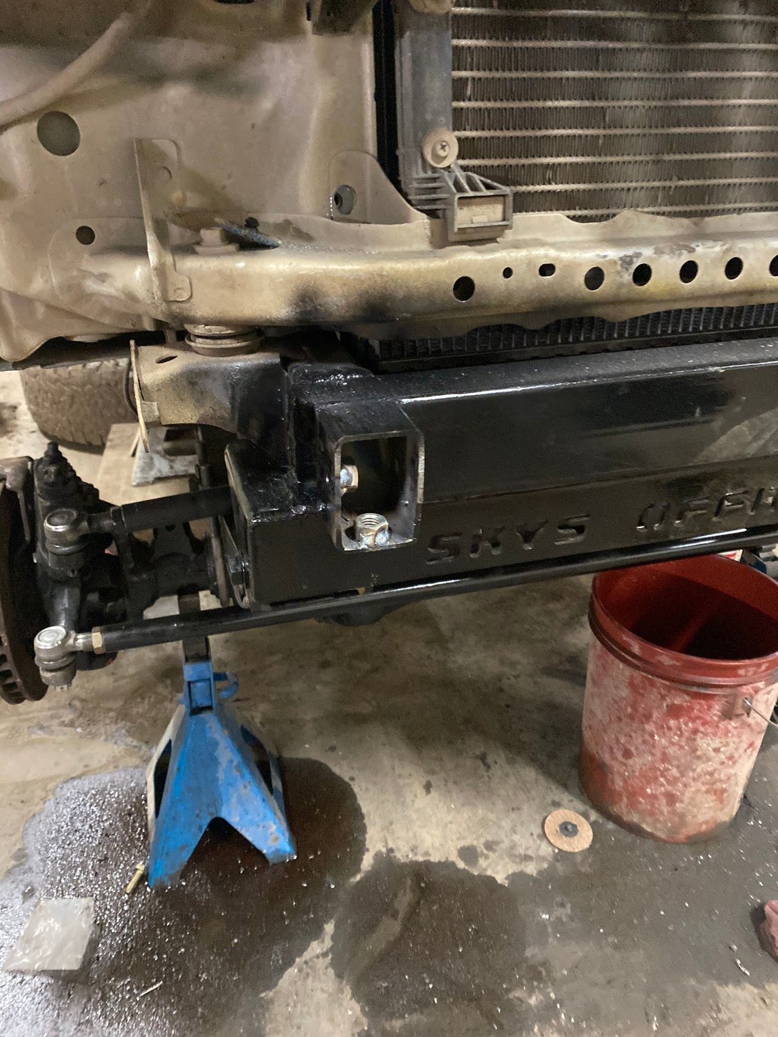

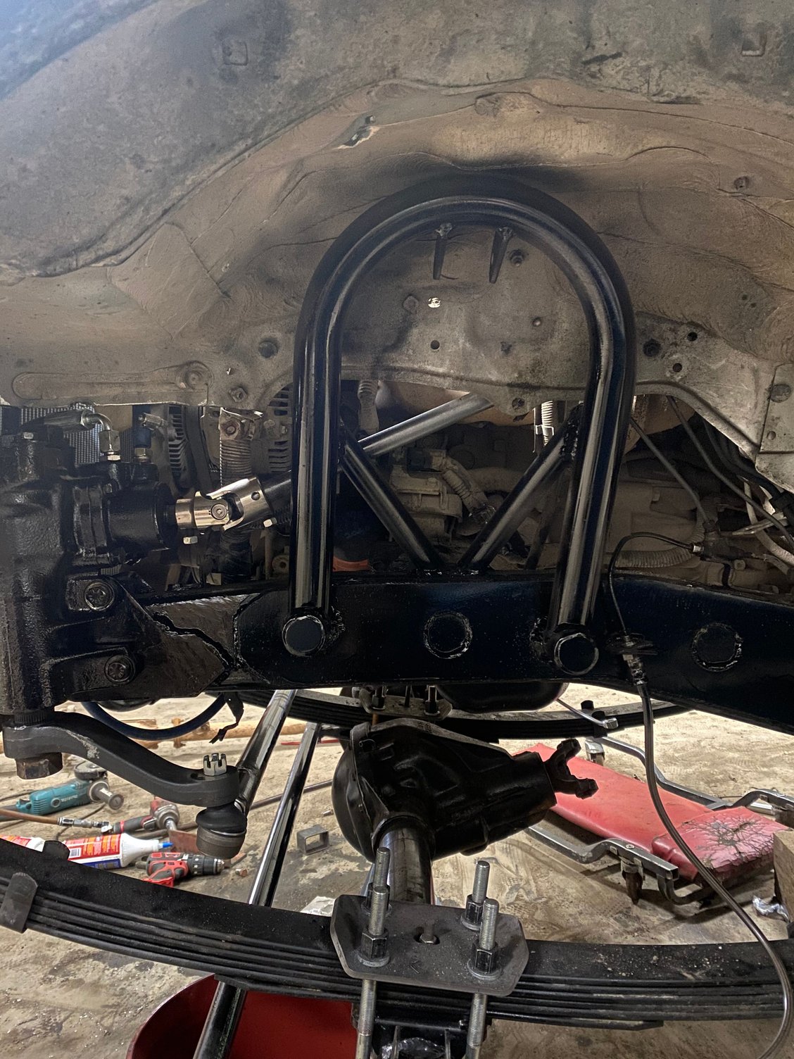

Been I while since I’ve updated. Had to hustle to get it done before snow falls. Got my steering done here. Used skys off-road frame plates. Had to chop up the fender. Pushed it far enough forward so if I wanted too I could run high steer in the future. Used 1.25x.24 wall dom tubing with trail gear weld in bungs for tie rod and drag link. I have decided I need a flat pitman arm or skys 3/4 drop pitman arm.

fully tacked in and ready to roll over to the shop and get it finish welded!

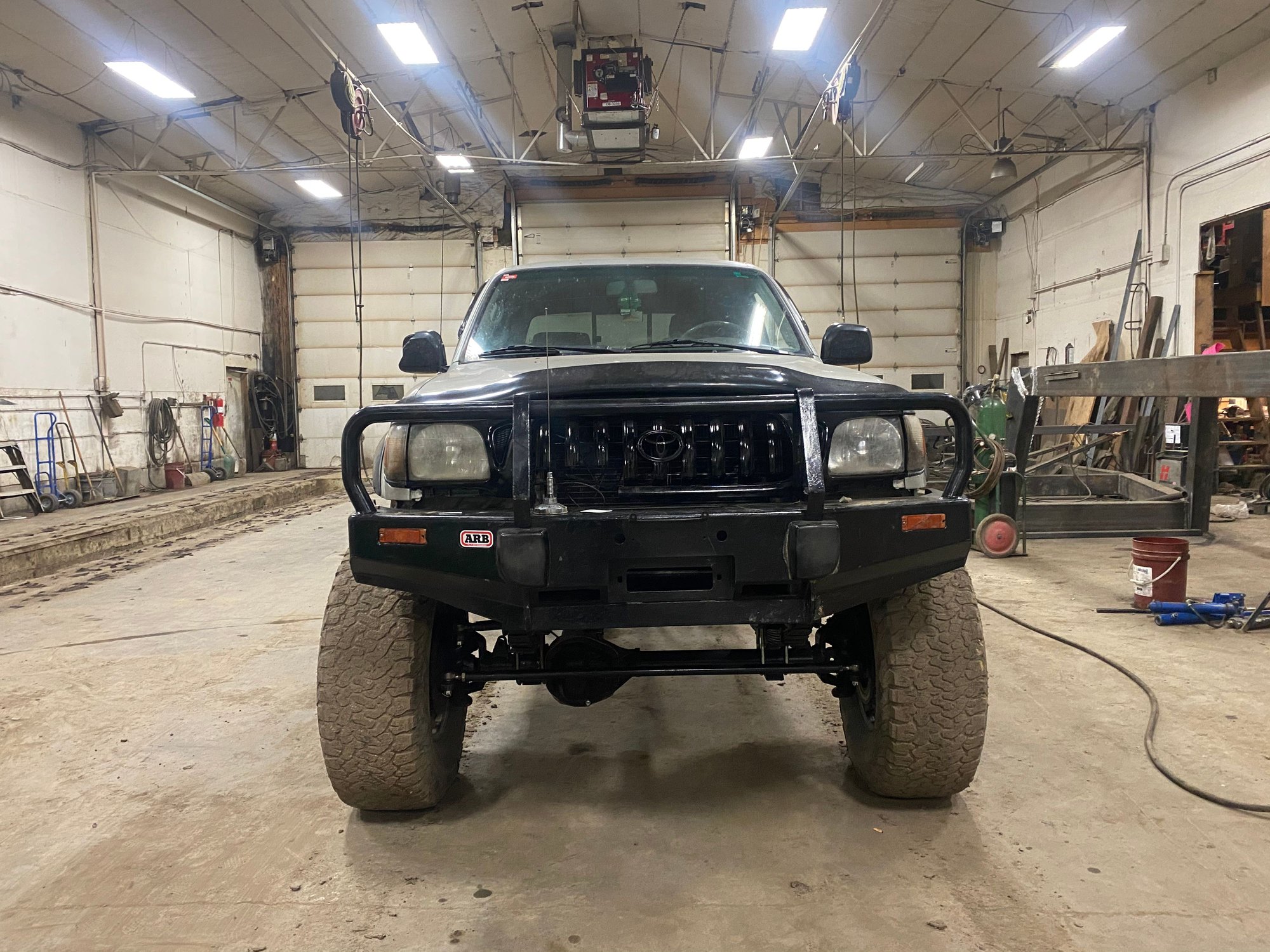

After that it was a self alignment to get it on the road until I can get a proper one done! Feels good to have it on the ground.
Old Nov 9, 2020 | 09:23 PM
Tacosas's Avatar
Joined: Jul 2020
Posts: 16
From: Kamloops bc
Well it’s on the road for now! Took it for a 2wd photo shoot. Waiting on a 23 spline transfer case input shaft tomate it to the trans currently
