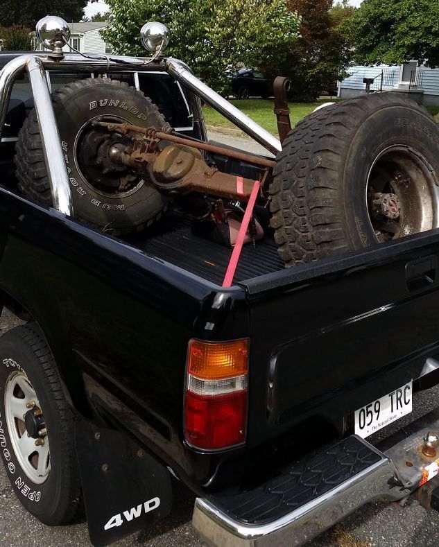

Well, made it home. Wife keeps asking what do I plan on doing with that "rusty old part" in the back of my truck...lol. I told her I'm going to rebuild my axle (rusty old part) then install it on my truck. I think no matter which way I explain it she won't understand. She keeps telling me I should just buy a new truck...psssht, ain't gonna happen. I told her I plan on buying a welder so I can do the job and she's said "You don't even know how to weld." It cracks me up. I love her to death.

a good place to start might be with cleaning that axle up and checking it to see if it's bent.
For sure! It looks terrible but that isn't going to deter me! That will be the first order of business once we get moved next month.
