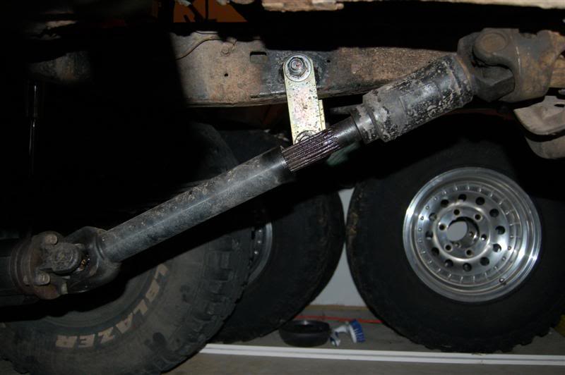

You either need to clearance your IFS CV or use a CV from a sold axle shaft. That's it. Don't go turning your knuckles. Mine didn't line up either, I used a SFA CV and it bolted right up.
Here's mine with SFA CV. I'm runninuals now so my angle is much better than this pic.
