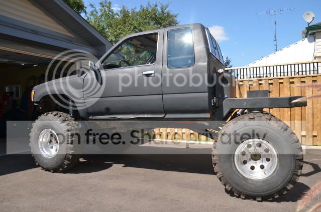

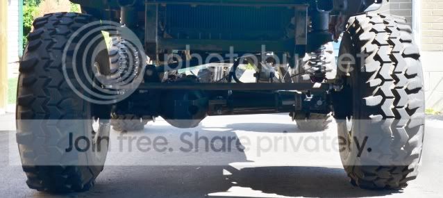

Everyone like pics so here are a couple. Sorry it has been a while since i posted. A 2 1/2 year old and a 11 month old dont leave much extra time.
This is what I have changed,
14 inch coilovers in the front(extended my buckets up 5 inches)
moved the 7.5 inch coil overs to the rear and mounted them backwards and halfway up the link to give me the same wheel travel as the front
Went to a full hydro steer set-up
Finally installed my doubler( had to make a new crossmember)
changed the exhaust back under the truck(might add stacks)
Low mileage bottom end and ported and polished rebuilt cyl heads(sticking with the 3slow....haha)
Also went with 1 1/4 wheel spacers
going to change myfront springs to lower it about 2 inches...sitting a little high right now.
If there is interest i will post more pics of what you want to see..
And Sega...I dont even want to know the real number but im for sure past the 10g mark......
