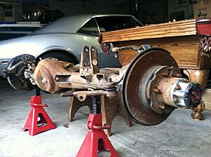

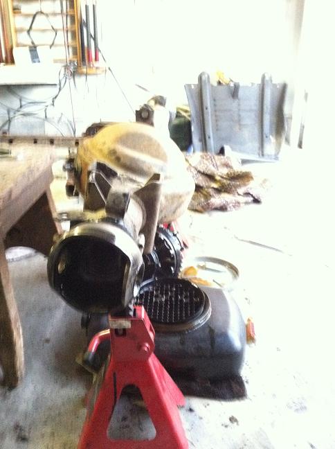

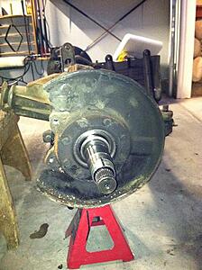

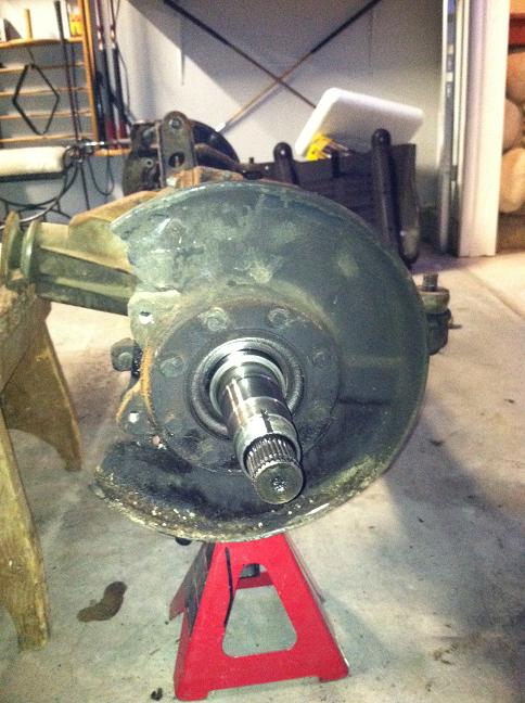

Got the axle off the frame, hubs, rotors, wheel bearings off both sides as of tonight. Spindle nut worked great with the screwdriver and hammer method. Noticed some previous screwdriver marks on the nut as well : p. Bearings and seals should be here next thursday. Still got lots of prep, cleaning and painting to do!

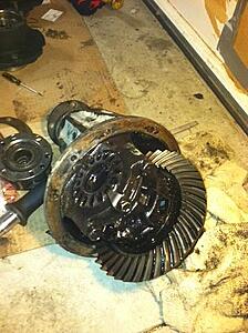

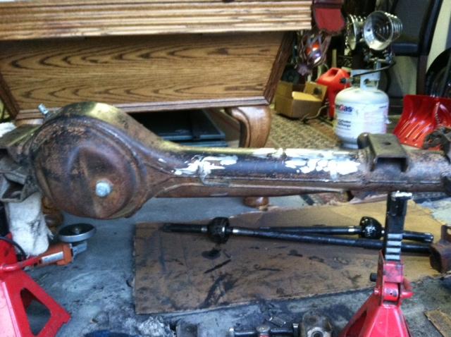

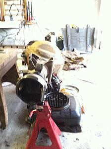

Got everything torn down the other day. Been trying to make some extra time for everything. Still need to cut off everything I don't need, sand it down, weld on extra trusses and clean everything!
Found water in the passenger knuckle, didn't see any rust or damage so I don't think it's been in there too long. Should be able to put everything back together by the end of next week.

be sure and keep the adjustment shims where they were, so you don't have to reset the preload and such.
be very careful when welding the housing, these things warp at the drop of a hat... some people think that warpage is unavoidable, and that the welding should only be done when the housing is bolted into a jig.

As long he doesn't weld the truss in one go he should be okay we stich welded my truss sure took a while but it turned out good and no warpage to boot

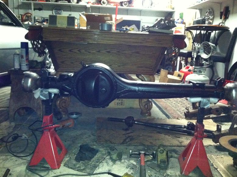

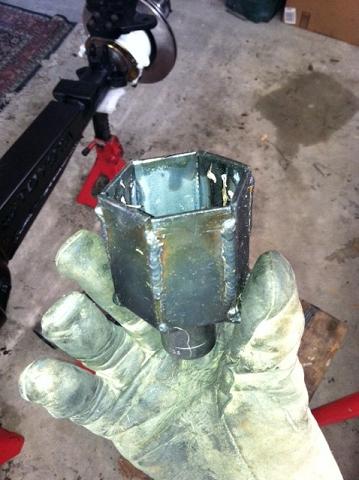

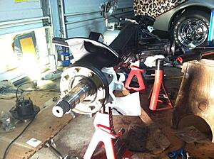

Old Jan 2, 2014 | 06:17 PM
A2theK's Avatar
iTrader: (4)
Joined: Sep 2011
Posts: 275
From: Boise, Idaho

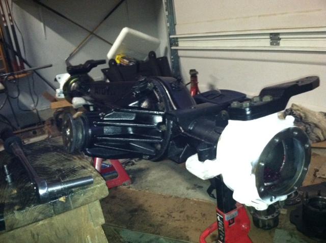

Lots of things have been keeping me occupied but finally got finished with the rebuild..
Extra brackets all cut off and smoothed out.
Primered and painted.

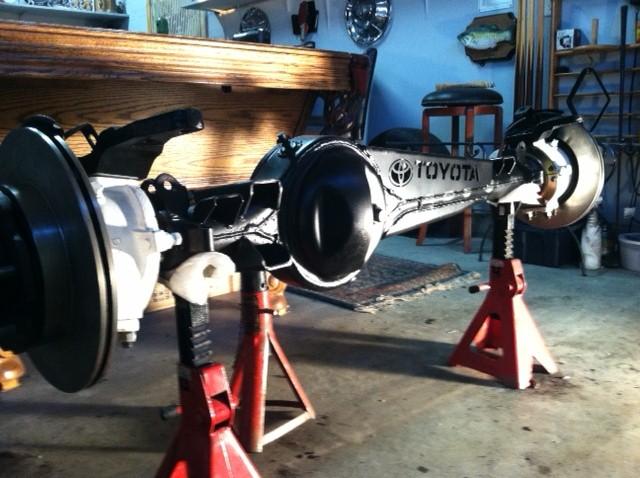

Burning in Sky's Toyota truss. No warpage!
Grabbed a stock 8" diff with 4.88's out of a v6 4runner with only 150k on it!
Reassembly! Full rebuild kit, bearings, seals, grease. Had to reshim the steering arms as the stock shims were nowhere near the pull scale weight. Think I ended up with .30 with a break free of around 9lbs.
Torqued and assembled up to spindle!

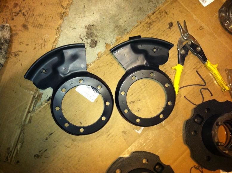

Backing plates cut down to keep brake line attachment.
54mm socket custom made, worked great!
Locking hubs all tore apart, painted and cleaned up and lightly greased for reassembly.
All put together!! New wheel studs pressed in as well, olds were all shot.
Drool...
Whole rebuild was pretty straight forward. Main problem I had was over torquing a bolt for the oil retainer behind the knuckle. Ended up breaking it all the way inside and had to drill it out. Looks super clean and can't wait to get it dirty ;] Ordering all the misc I need to complete the SAS when I get my next paycheck in!

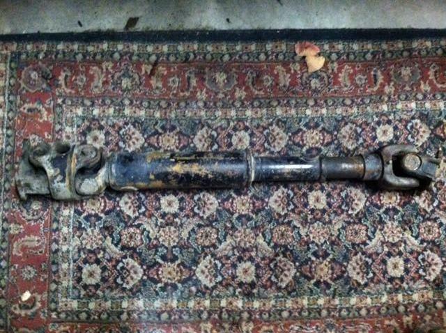

Also scored this 85' front driveshaft on CL. Was told it was lengthened to fit his 6" lift 4runner and balanced as well so I'm hoping I won't have to lengthen or shorten it at all. Picked it up for $50 so if it works I'll be super happy.
