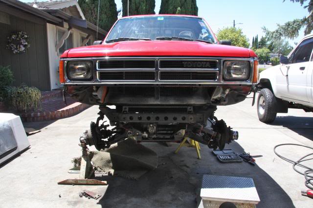

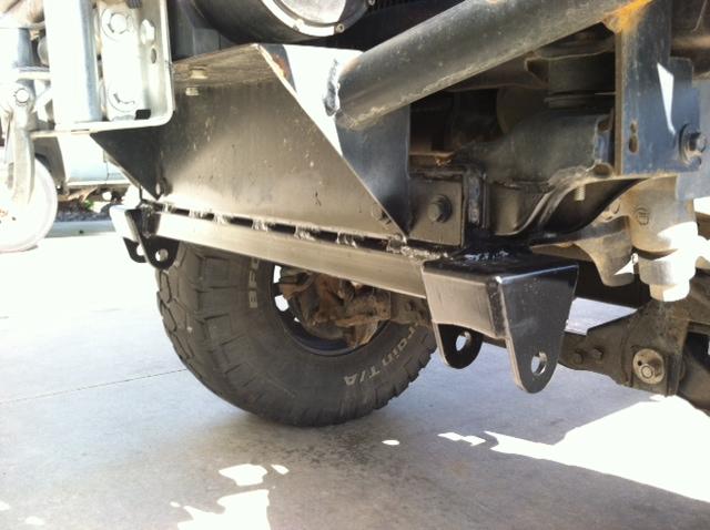

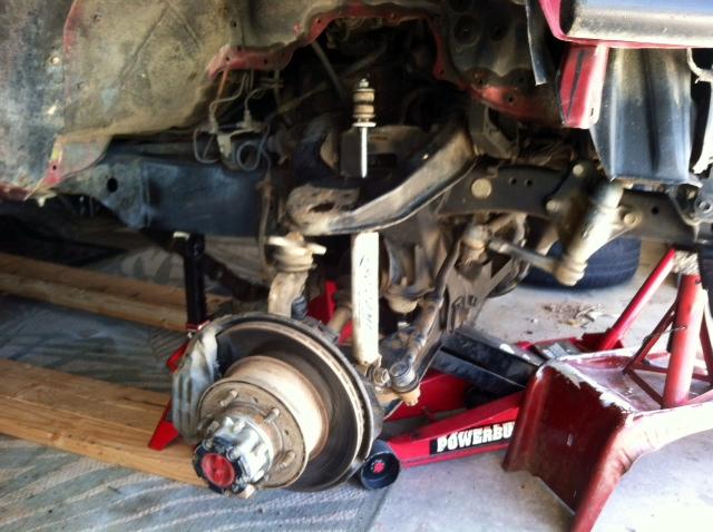

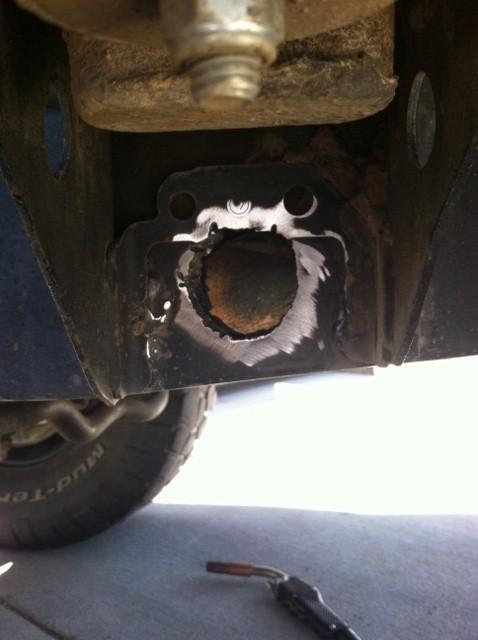

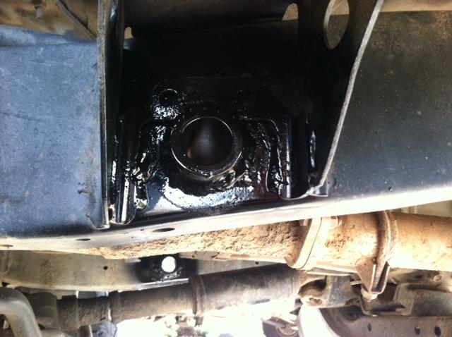

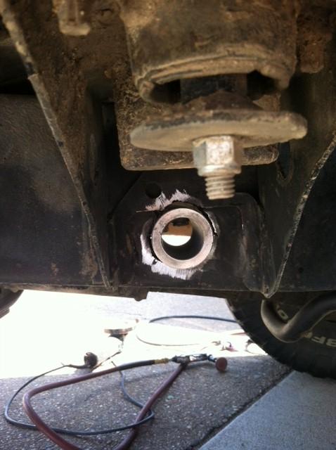

    Works been picking back up so I've been putting in 60+ hour work weeks so I've been trying to really get started since it's starting to warm up around here. Since the truck is my DD; I decided to just burn the hanger in and cut the shackle holes before tearing everything apart. I plan on using stock shackles, may have to adjust depending on where everything lines up for a better angle. Even if I have to adjust my hanger again; I still feel like I'm getting somewhere to get started.. haha.. Put my RUF together as well using 4 leaves from the toyota rears and one more leaf from a front spring setup. I have plenty of spare leaves if I need to adjust.. Planning on taking next weekend off or the one after that and get this project going!!

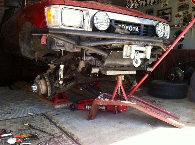

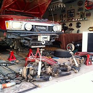

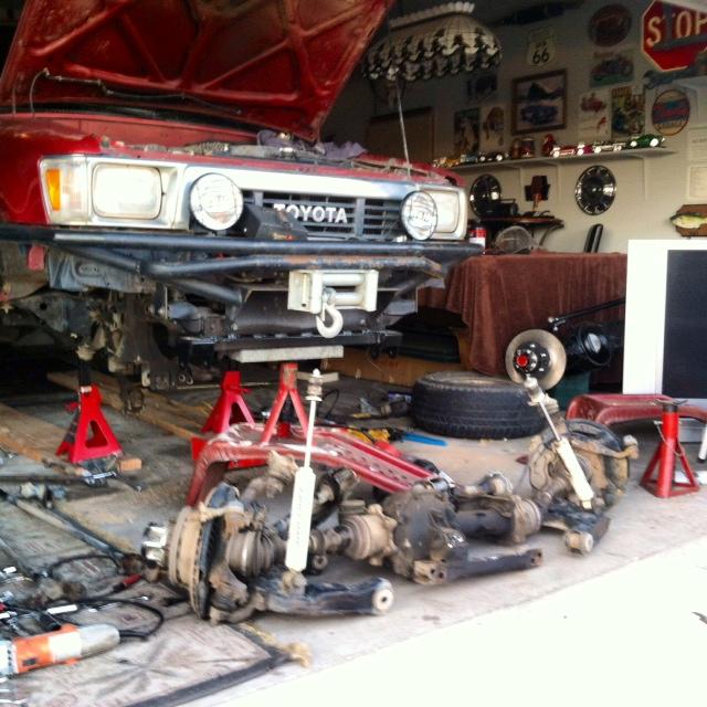

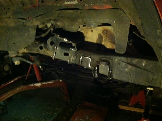

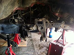

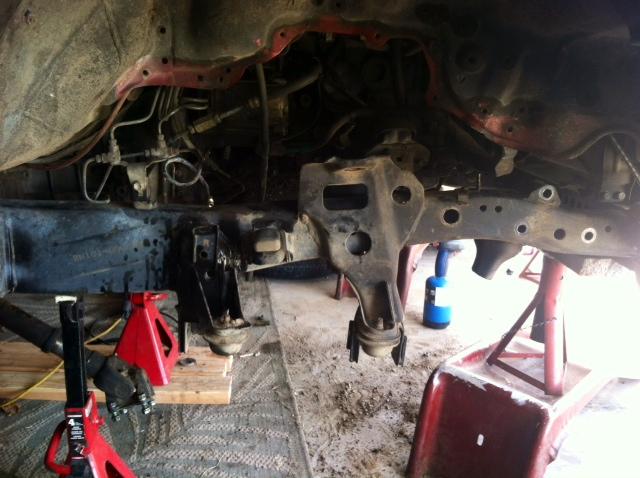

    And... we're off! Took the next 5 days off work to get this project going. Took time this morning to get misc stuff, brake fluid, cut off wheels, etc.. So far so good, got the front end all removed and started cutting off all the brackets. My cut off wheel ended up breaking as I was cutting off the first side so I had to run to the store to grab another! And that's basically where I ended up tonight. Hopefully I'll get the rest cut off and grinded down tomorrow and get the axle at least hung..

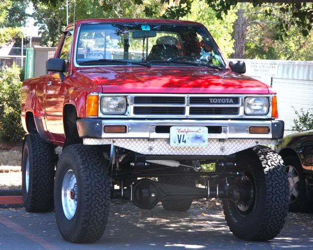

    Brings back memories it does.
