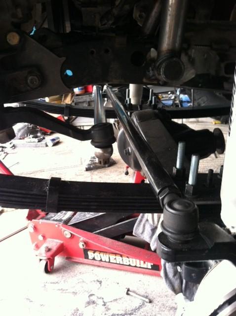

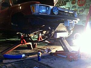

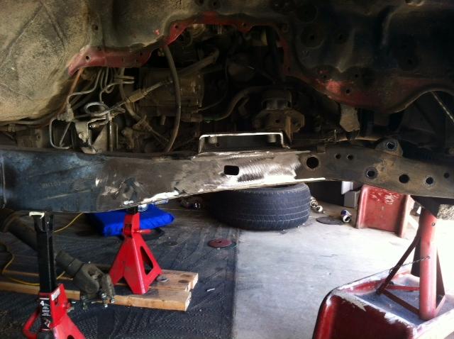

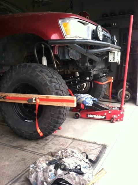

Holy damn am I tired of cutting and grinding.. Got her all cleaned up and smooth though! Didn't order enough leaf bushings so had to run to the store to grab some, slowed me down a bit. Ended up with the springs mounted up. Should be able to finish getting the axle under, brakes hooked back up, check how she sits and then deal with steering..

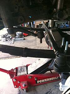

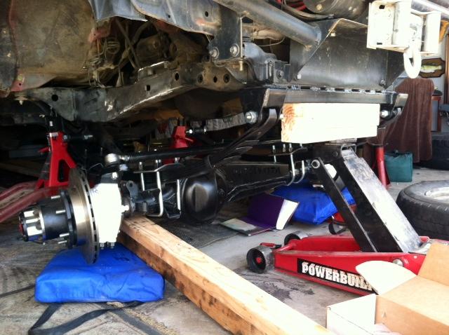

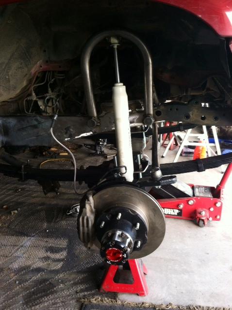

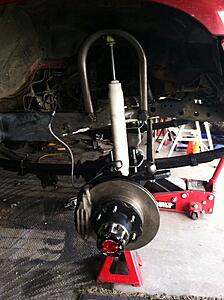

It's under and almost ready to roll! Got everything mounted up today.. Brakes are on with lines, just need to bleed them still. I have a 110 welder in the garage which doesn't burn too hot so had to put some pretty good tacks all around the motor mount plates as well as the shock tube mounts. My dads buddy down the road has a 220 at his house so once I finish up the steering; I'll take her easy down the road to get everything really welded in good. Kinda screwed myself over which not buying wheel spacers.. Wheels hit the calipers so I can't put them on without spacers! I'll have to try a few 4x4 shops to see if they have anything but I'm kind of SOL with it being a holiday weekend with ordering some online.. Besides that though I'm happy with the stance; It's lower but not super super low. About 3" or so over stock, could probably drop it down another inch but I like where it's at..

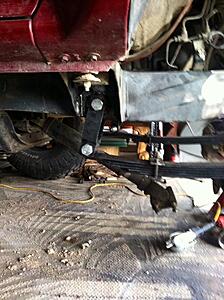

Made my own shackles, 1" longer than stock so around 4.5" hole to hole
Ahhh, makes me want to drive her so bad.. Deciding if I want to take off my 1" body lift or not.. I may keep it just for other clearances it'll give

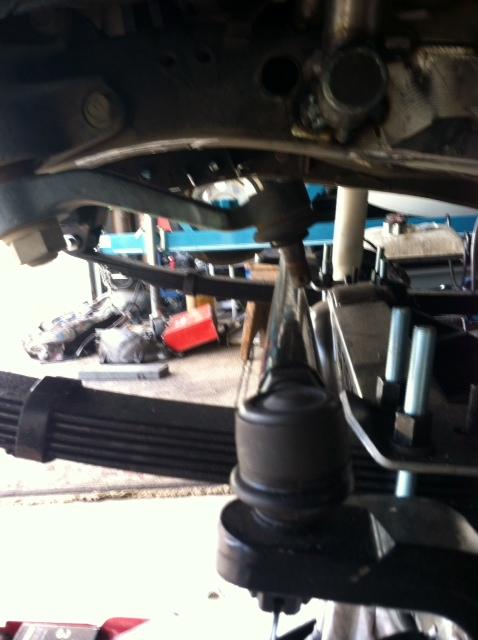

Where the pitman arm ended up, well past the tie rod
Just a mockup on where I plan on moving the box; I'll probably try to angle it up a bit higher though.. Possibly a different arm in the future

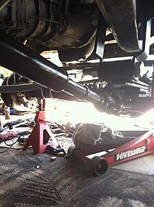

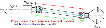

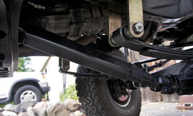

Yea, whats your plans for a F drive shaft,,,,,,,,, Not hard to make.
I did not use the CV in the front, it went out back.

I was thinking about making a square shaft, talked to a few people locally about theirs but had mixed emotions.. Since it's my DD and not just a weekend 4x4; I need something that can go 50+ down the highway in 4WD when it snows here and some guys say their square D shafts usually start vibrating around 25 mph.. I'll put on the new shaft today to see how it fits, otherwise I'll either try a square shaft out because why not! haha or just get this one extended a bit more and balanced..

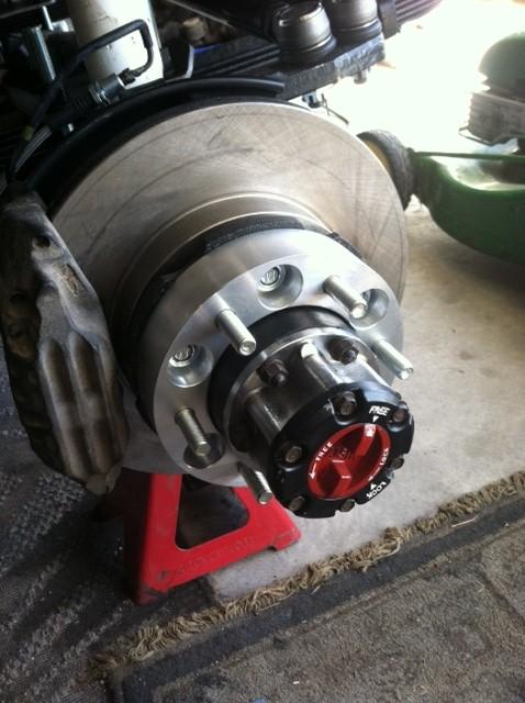

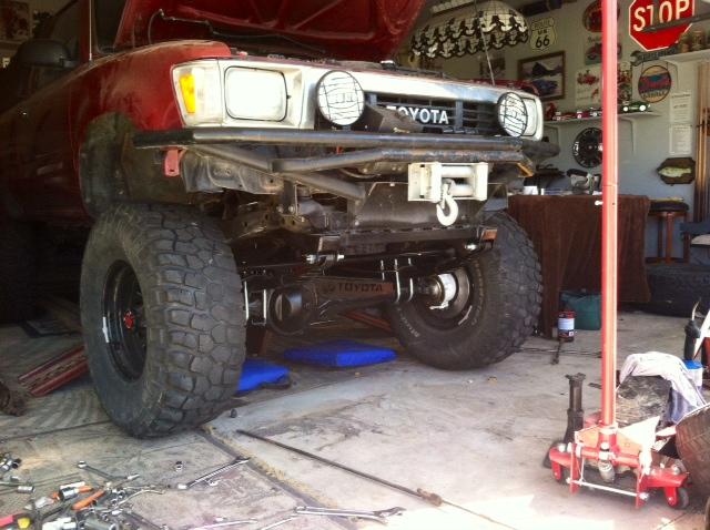

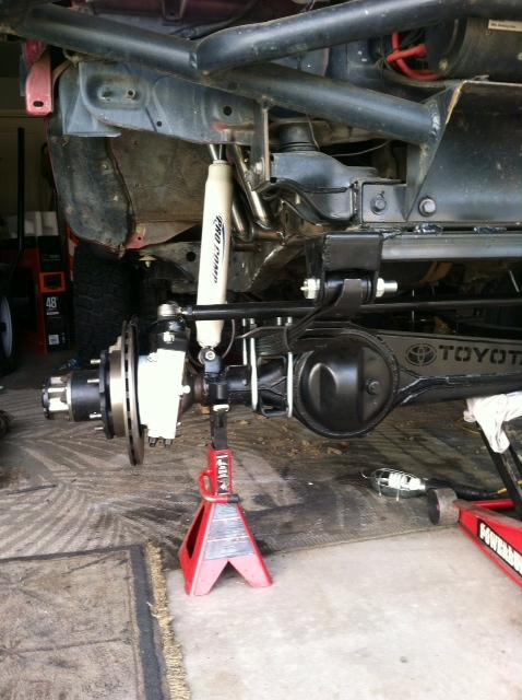

Everywhere is closed for memorial day, even online so I'll have to wait until tomorrow to figure out my wheel spacers.. Got the steering box all in place as well as drag link. All that's left is to fully weld steering box mount and shock hoops, as well as cut and sleeve my steering shaft and then it'll be time to give her an ol' test drive! Depending on when I get these spacers is when I can finish all the welding soo.. kinda at a stand still
Will probably order a less drop and shorter pitman arm in the future..

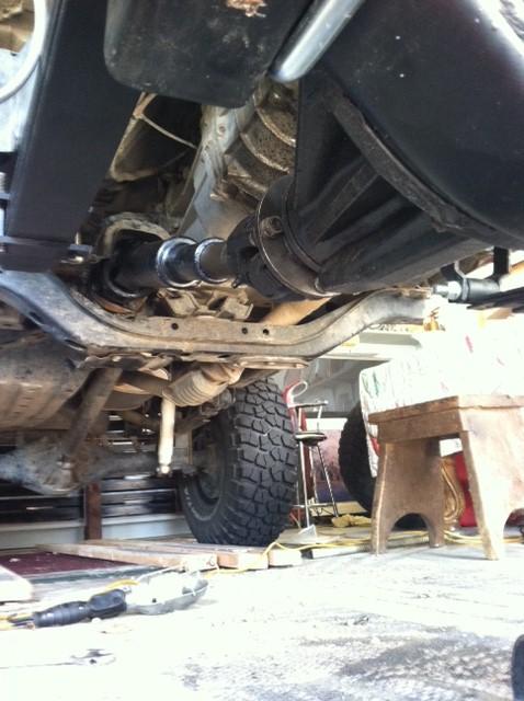

The drive shaft I bought of CL did in fact fit but with only a few inches on the spline, kinda leery about it but hell it should work for now..

Ordered my wheel spacers and had em shipped for overnight because I'm pretty impatient haha.. So should be able to get them tomorrow, throw them on and get my wheels back on finally for good. Then just have to finish up some welding with a 220 and paint her all back up and fix any riding issues or anything else that may come up, hopefully nothing though!!

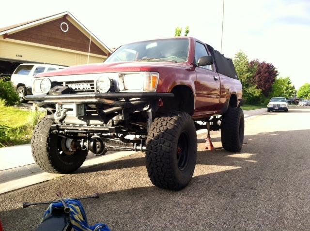

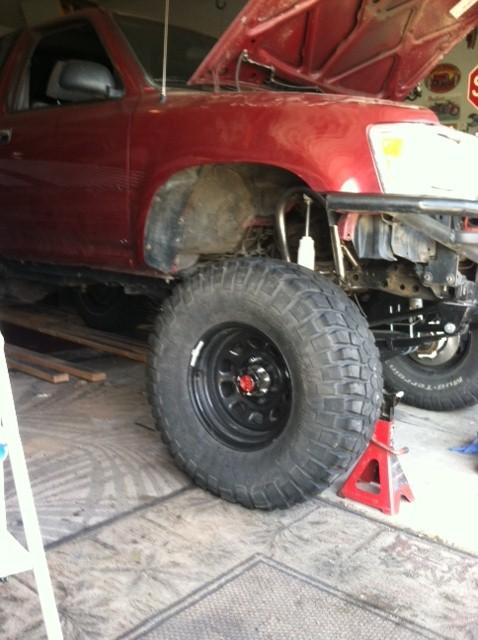

Good news! Got her up and running on the streets again woop woop! Still have a few misc things to finish, steering stabilizer, bump stops, painting.. I'm super impressed with the ride quality as well! Feels nice and solid, got her up to 65 with not a single shake. I'll head down the interstate tomorrow to see the higher speeds 75+ but overall it drives super straight, feels tight, great spring rate, very happy! As expected though anything over 10 mph in 4x4 vibrates the hell out of the truck which I'm assuming is my drive line that is a bit short and who knows if its balanced.. I'll get more pics of the stance tomorrow, it's about an inch or so higher than the rear. I'm just running 2" blocks in the rear (chevy's to come) and that 1" BL so overall it just a hair over 3" suspension lift up front..
Wheel spacers were over nighted and get them basically the next morning!

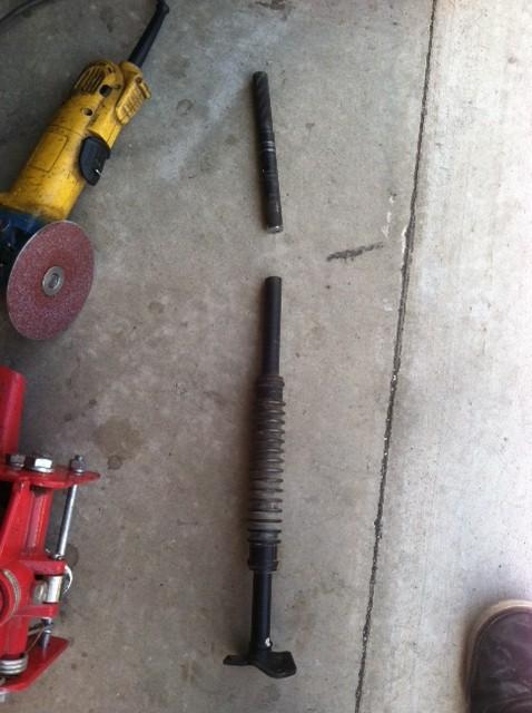

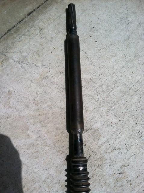

Steering shaft was too short by about 2" so cut it up!
Sleeved and burned together, may drill some holes here and there and stick some more welds in but for now its super solid
Before I got the shaft finished and rest of the welding done, took her to my dads work where the 220 welder was at to finish everything up
All aligned and driving super straight; I could literally drive with my finger if wanted to. Such a huge improvement over my IFS lift and worn out front end.
Quick side angle shot. I'll be ordering some new front tires since no one could align my IFS; it just completely ate through them.. I always told myself I wouldn't want to go bigger than 33's but after this 35's are sounding more and more appealing haha.. We'll see how the bank account looks in a few months and I'll decide then More pics tomorrow!

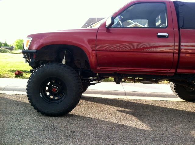

Few shots of how it sits.. Will be ordering two more 33's since my front two are practically bald.. Rears have like no wear so it should work out fine. Just need a little more lift in the rear, thinking chevy springs; what's everyones opinions about them? Thinking about buying a cheap worn set of 35's on CL just to see what it'll look like :p I'm off work tomorrow so I'll get it flexed out a little more than what I've done

Just wondering why you used the spacers and not the ifs hub trick to widen the front?
