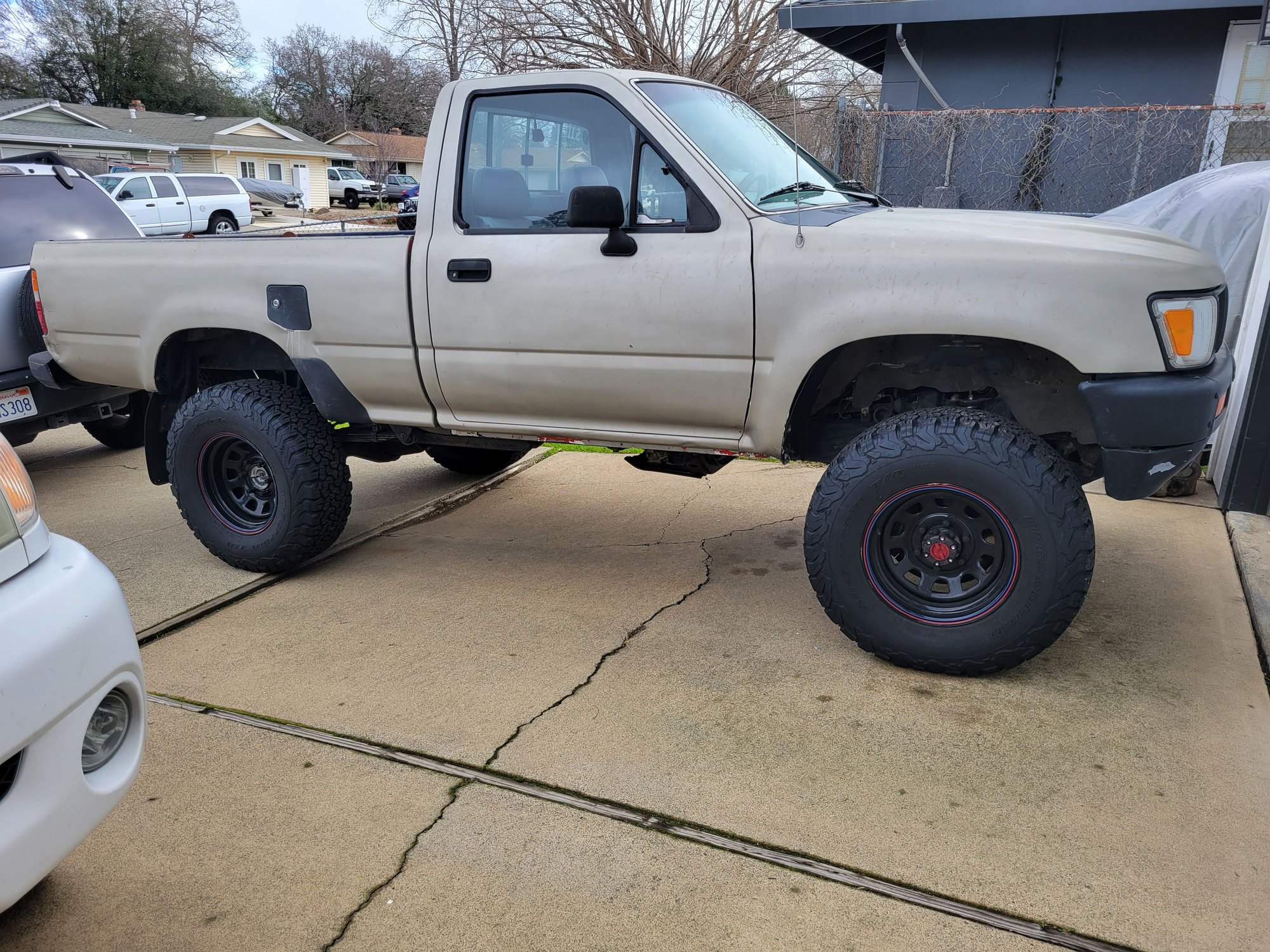

i have the axle built and under the truck with tires on. springs attatched. no steering hooked up. noticing that the top of the tires are angled inward about 3/4". negative camber. is this normal until the new springs settle? or until i get the high steer hooked up? or the axle is bent? its a 84 solid axle. did the TG kit with 3" springs. put a level to the rear tires and then to the front and the offset is equal on both sides. all tire pressures are equal. i realize that camber isnt really a thing on solid axles but im stumped.

I never checked mine but I never "noticed" my tires leaning in. It's not something that's adjustable. Almost sounds like a bent axle but both sides equally?? If it's bent it's usually very difficult to get the Birfs in and out. I hope you don't have a bent housing after all your work. Did you weld on the housing?

All welding was done by previous owner. Passenger side birf was mostly OK putting in. Driver side was a pain. Went in but only after several wacks with a dead blow. New 6 shooter knuckles. All new bearings and the likes. New longfields. Haven't even run it yet.
doing all this research is leading me to believe it's a Bent housing.

Just going to run it. Wouldn't trust another used housing. If I get a new one like the rock assault then I would have to buy new solid axle hubs because the new one is already ifs width. Or, use my ifs hubs but then put 1.5" wheel spacers in the back which I don't like.
Going to mess with pinion angle and see if that helps with negative camber. Someone told me to check the perches and make sure they were level and i found out the driver side perch with the spacer pad may have been rotated and replaced by PO. They are not clocked the same.
theoretically they should be level (level to each other respectively) and the same height, correct?

Sounds like your housing is a mess. Sorry man, that sucks. I have a set of 85 hubs. I swapped to IFS hubs. I'm near Tucson though. I actually have an 85 straight axle in my 88 that I will be eventually be parting out or selling whole. My SAS'd 88 sadly became the donor for my linked 86 Xtra Cab build. I bought another used 85 axle because I originally planned on selling my 88 as a roller. Not sure that plan is going to work because I took the high steer for my 86. Ain't rolling without steering arms and I don't want to put money into a truck I'm not keeping. I just sold the wheels and 35's so it definitely isn't a roller now. Too bad you're not closer or you could check them out.
Changing pinion angle will affect caster, not camber. Unless I'm not understanding.
