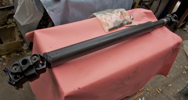

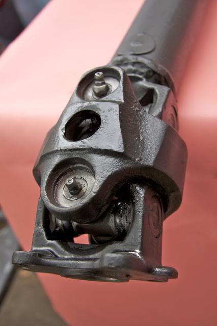

I went through that. Longer shackles equaled pinion flange pointing to the transfer case flange.......= some shake and deceleration growl. In went my IFS CV, problem solved.Name:  IMG_2330_zpse0e2b77f.jpg

Hmm never thought about using the front double cardan do you have a write up somewhere teuf?

No write up, I just cut the CV off a few inches from the yoke. Disassembled CV. Brought it to a driveline shop. They installed and balanced it. As stated I have no vibe issues now. My SAS thread may go into this a bit.
