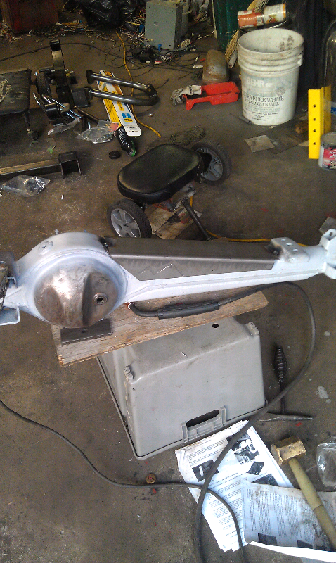

Here's the axle out of a 85 yota 4runner or pickup not sure which one though.

Axle gusset tacked on I welded the diff beef but didn't take a picture must of forgotten :-P

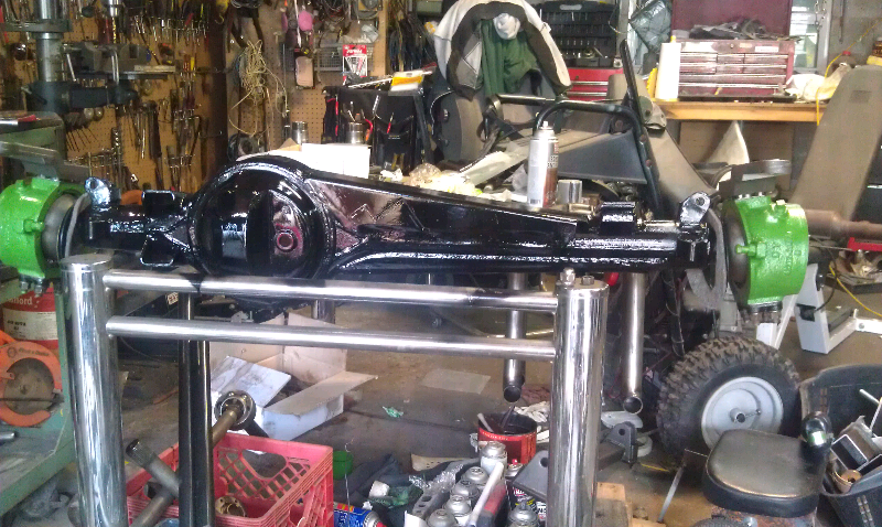

Axle painted with the,knuckles on and seals installed well axle seals that is.
That's as far as I've gotten I'm still waiting on parts to arrive from trail gear, my backing plate eliminator, lock washers, cones and nuts should be here Friday hopefully.
