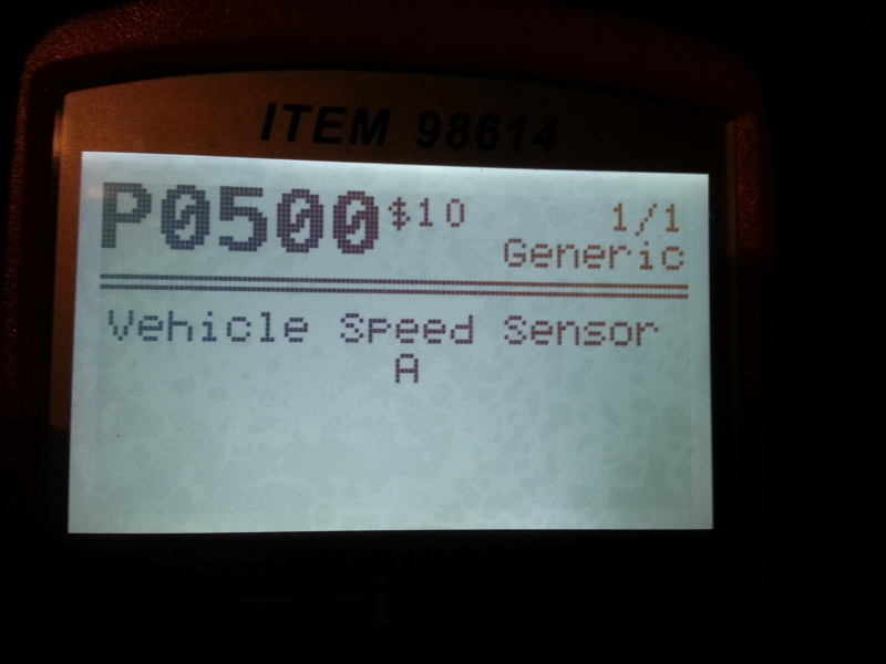

1) Vehicle Speed Sensor to get that damn speedometer working again.

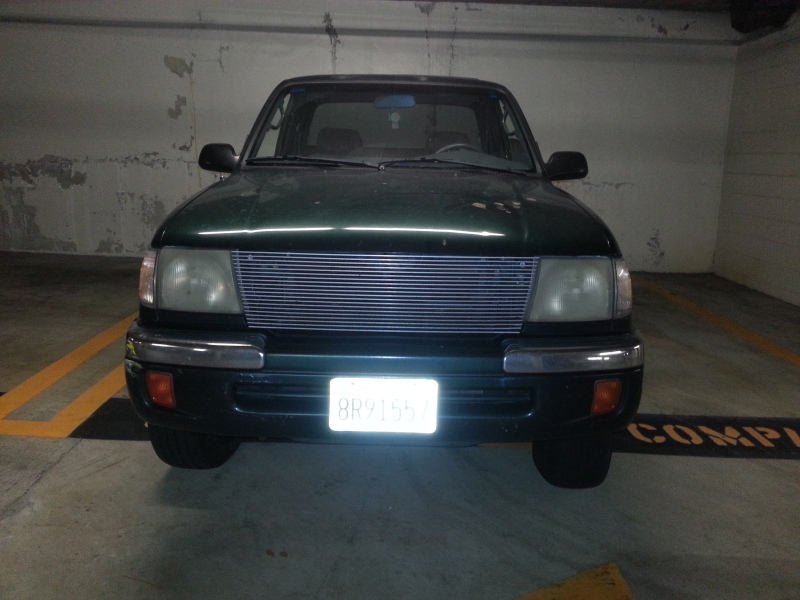

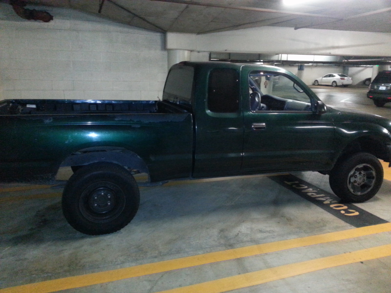

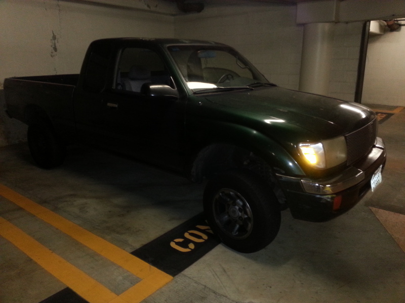

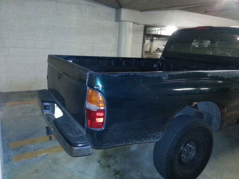

Here are the exterior pictures:

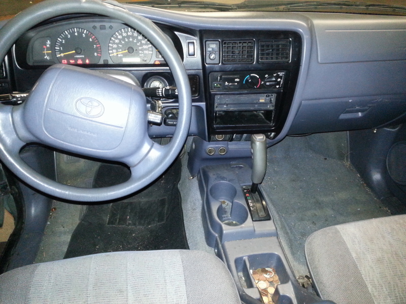

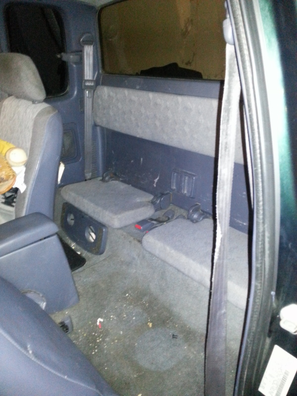

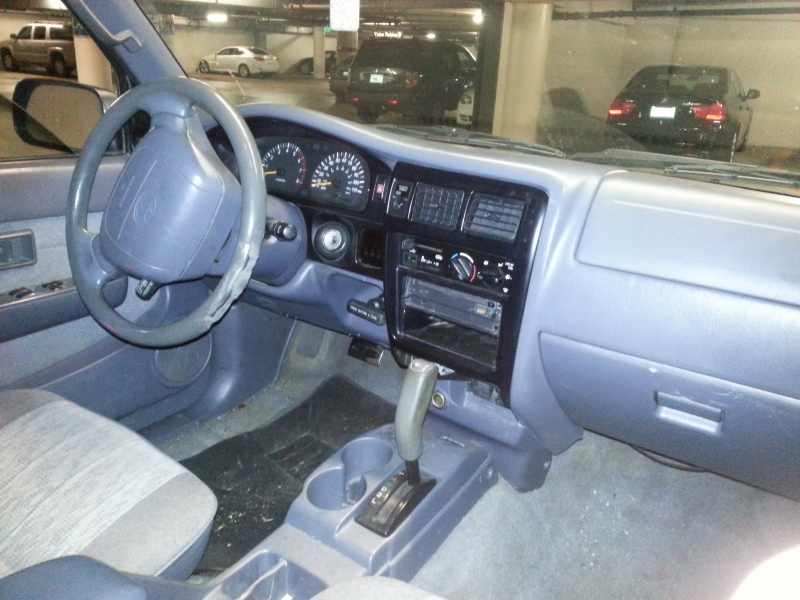

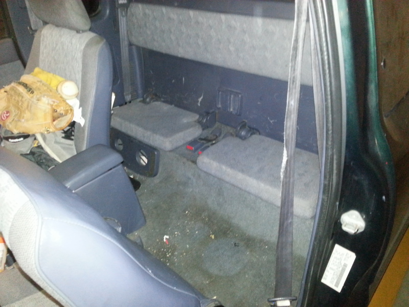

Interior Pix:

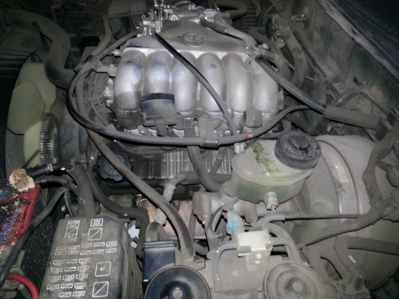

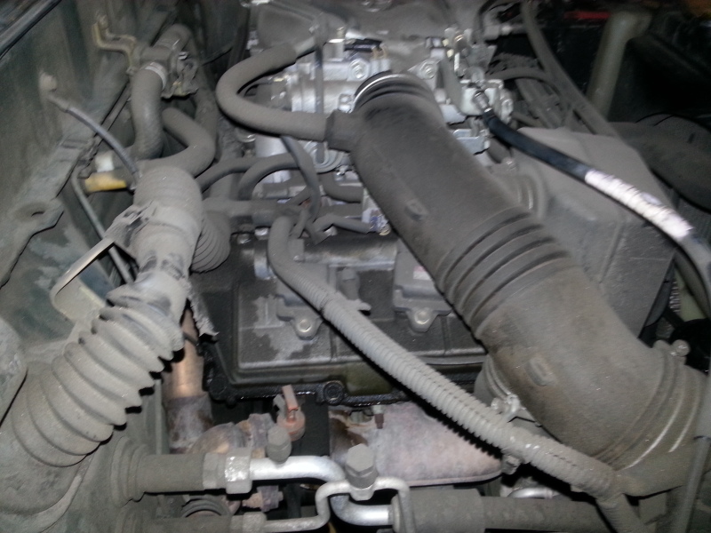

Engine Pix:
I Tested the Check Engine light with my check engine thingy and these are the codes that came up:

Valve cover gaskets and possibly the seal on the oil cap are leaking. Battery posts need cleaning. Are the paint issues isolated to the passenger bed rail? The passenger head rest is oily, filthy, but interior can be cleaned up pretty easily.
For $1400, if the engine sounds ok, oil, looks ok, and coolant looks ok I'd take it.

.... Personally, even if I was just gonna sell it.... I would wanna know EVERYTHING I'm getting into, including Brakes, Steering, Suspension, Trans, Drive Axle, etc. Things like a valve cover, oil cap, sure, that's promising 'hopeful' news... Just be sure as you can of what you're grabbing, ya know? Whether this guy knows his stuff or not.... That doesn't mean he's not accidentally dropping a TOTAL lemon on ya, ya know?
NOT TRYING to be negative... It's a 3.4 for one thing... BONUS... And it's NOT smashed in all over the place.... Another BONUS... But often, oil leaks on the top end like that are a result of 'pressure', ya know? Does this rig have a PCV system, RW? I've had a bad one blow out my VC gasket, lol.
