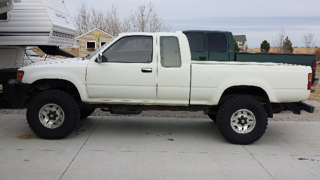

It's a 95 sr5 ext. cab with 210,000 miles. 5 speed 3vze v6 3.o, 2 inch pro comp lift with 33 Mickey Thompsons tires. Replaced the master and the slave cylinders clutch lines, power steering, alternator, valve cover gaskets, put in bucket seats, fab up rear bumper.
OK soooooo here's the kicker. Lost major power! Won't even climb a hill in 4th gear. Thought I would start with changing plugs and wires. Then the starter went out. Took it to the Toyota dealer in town and they told me I have a blown head gasket, that it would cost around 2 grand to fix. The mechanic told me he was interested in buying it from but said my truck isn't worth no more than 50 bucks because they don't know if the engine is worth fixing or not. I said but good enough for you to charge me 2 grand to find out! Any ways, I'd like to get out from underneath it but I feel $2500.00 is a good starting point. Others are saying if I can get 1500.00 to take it and run. What you guys think. Am I being stubborn in not wanting to give my baby away?
