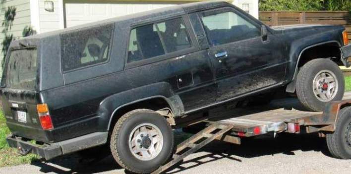

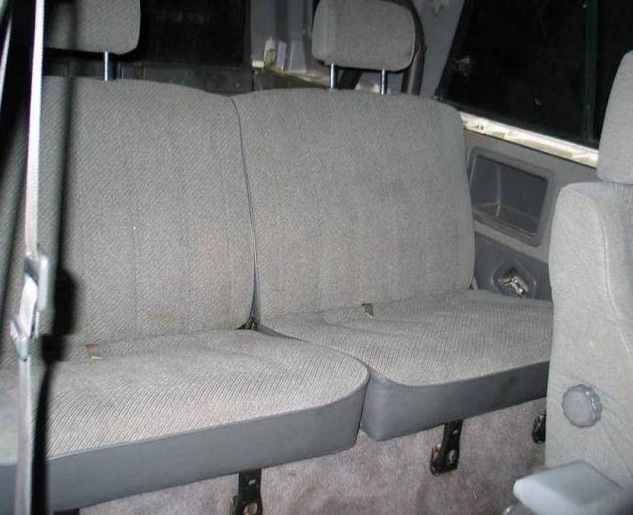

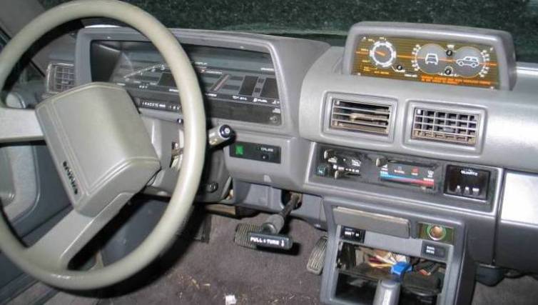

Ok, so after a longggg day of driving we made it home and we bought it!! So now we actually can belong to the club, right??
Here are some new shots of Cass's new ride, of course, it needs some fixing up. No sunroof, but pretty much everything else. Unfortunately it is not running. Will set out to diagnose the trouble monday. We plan to take it to branson and pull our little 14' boat Nov 1st so don't have much time. Dash is in nice shape.
1987 Turbo 4 Runner
Attached Thumbnails Congrats to us new 87 T-Runner-img_5921.jpg   Congrats to us new 87 T-Runner-img_5960.jpg   Congrats to us new 87 T-Runner-img_5961.jpg
