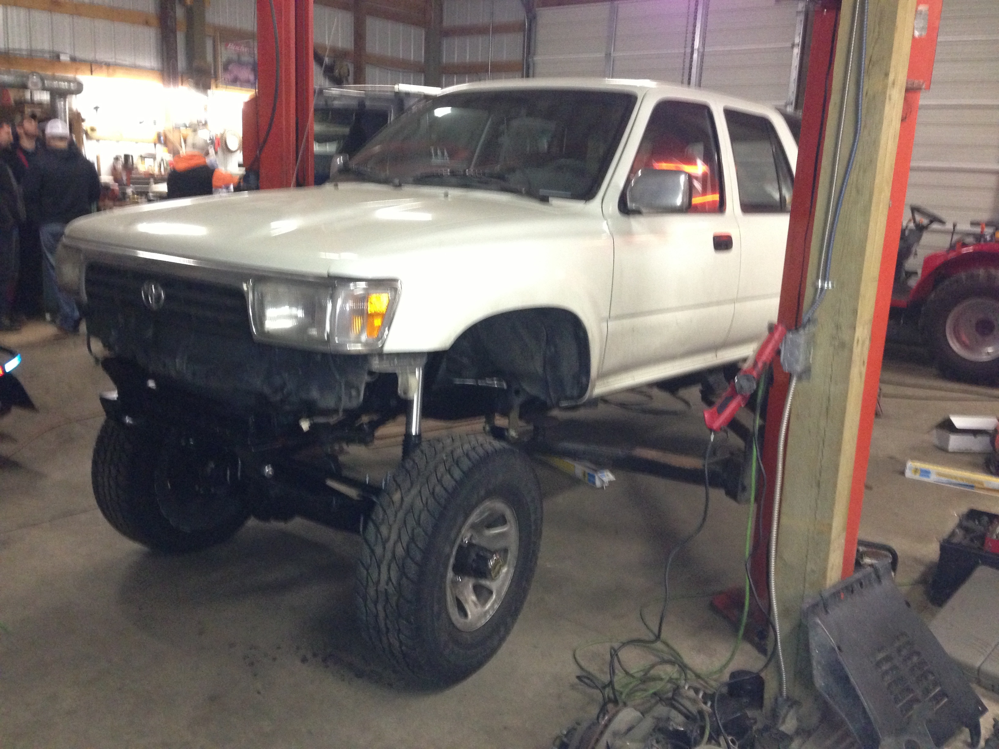

I have a 92 4runner, just got done with the front 4" sas kit. I'm working on the rear now but not sure where to weld the brackets in place. The instructions say to go off the old hangers, but there is no hangers due to the coil suspension. Does anyone have pics of this and any measurements that they went off of.

The easist way to do it is to find and mark the center of you're wheel well, then hang a plum bob from that location, and that is where you need to have you're leaf pin located. I always move the leaf slightly forward (~1") so when the springs compress under force, and the shackle swings back, you're still centered.
