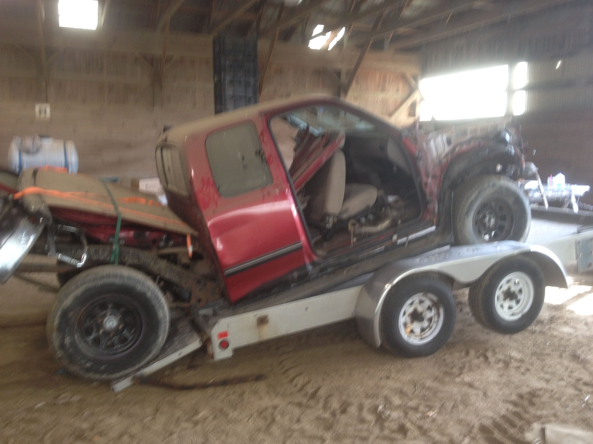

The '95 was a scam. Guy I got it from covered the frame in black undercoating. making imperfection invisible, especially on a rainy day. I ground down the frame when I noticed the truck bed was flopping around on bumps. Some of you may want to avert your eyes for these next few photos, and remember not to make my mistake and to pound on the frame a bit more before you buy a car.
This is what 20 years in New England can do to your vehicle.
Red marker indicates the cracks
The Cracks are just forward of the rear cab mounts. . . on opposite sides. The welds are from the previous owners and as you can see failed shortly after acquiring the vehicle. There's no sense in welding a frame unless you plan on completely encasing the frame IMO. Angle iron alone tends to bow out when put under pressure.
So as you can see I'm in a bit of a predicament. Originally I was planning on salvaging the frame by welding it back together but after getting a better look at it, it really doesn't seem like much of an option. My plan as of right now is to do an engine swap.

I ended up scrapping the 95 frame. In retrospect I'm glad i did rather than try to save it. Almost decided to tow the truck from just the front end to the scrap yard. Glad I went with the trailer the whole thing turned into a pretzel in the process of getting it to the scrapyard.
