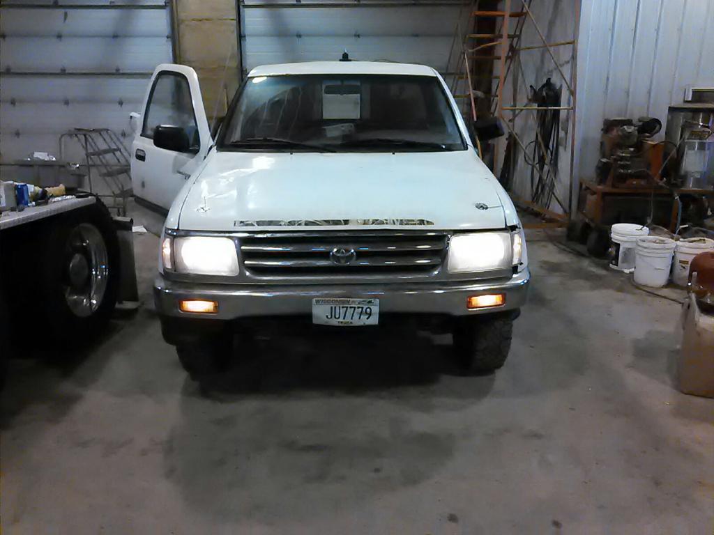

Here's a few pics of it. Needs some work but I don't think it's too bad for $1000. Gonna make a new flat bed, make a tube bumper like the ol smitty ones and might lift it 3"

That flatbed might be an issue on the rear wheels because it looks like if you were to load the bed down enough it would rub or larger tires would rub ont he bed.

That flatbed might be an issue on the rear wheels because it looks like if you were to load the bed down enough it would rub or larger tires would rub on the bed.
+1 you will need a rear lift or a higher bed to clear bigger tires. I'd stick with the ones that are on there until you can lift it and/or build a higher bed.

Wow what a great big shop to work in....jealous!

Here's a better pic showing the clearance. Currently has 31 10.5 15. I figured it could at least fit 32 11.5 15..

The clearance with the bed will be more of an issue during flex/compression of the suspension. Measure the distance between the bumpstop and the top of the leaf spring, that will be how much "up travel" the suspension has. Then measure the distance between the top of the tire and the bed, if it is less, then it will rub. You could always just cut the bed over the tires and add higher wheel wells.
