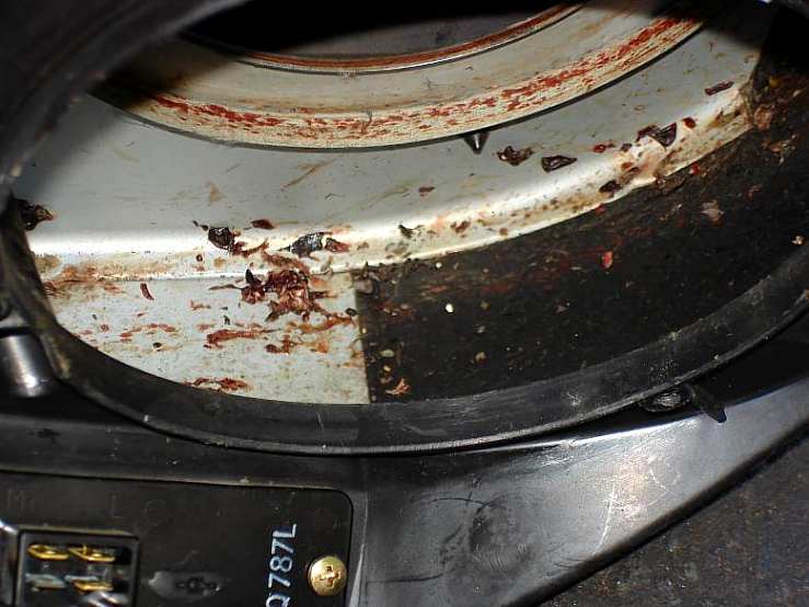

I'm needing some help guys. I turned on my blower this AM, heard this weird sound like something was rubbing against the fan blades, so I turned it off, back on again, same thing. So on a hunch I reached down underneath behind the glove box and wrapped my hand around the blower motor housing and then flipped the switch to full-speed-ahead! It shook like crazy, I was certain something was going to break, then suddenly broke free and was blowing fine. Then I smelled something funky....like roadkill! So it seems like some little critter crawled up in there somewhere.
#1. Where do you think I should start looking for the "dead thing"? I have no idea what I should start taking apart 1st?
#2. Do you know if the T100 has a cabin filter? I checked the local Advance auto store and none is listed in the FRAM catalog. I can see a mesh wire fence like cover over another plastic cover and a piece of foam behind that but it doesn't look like a genuine cabin filter.

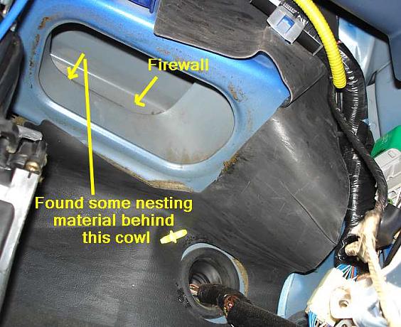

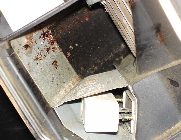

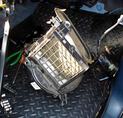

You wouldn't be LingOL if you smelled what I am Joe. Well, I couldn't stand the stench anymore so when I got home this evening I grabbed my tools and started tearing things apart. Here's what I found so far:[br]
Finally got that big ol' thang out, didn't take as long as I thought:
Mouseburger anyone?!
Attached Thumbnails Cabin filter in the "t"?-tblowr2.jpg   Cabin filter in the "t"?-tblowr3.jpg   Cabin filter in the "t"?-tblowr4.jpg

Gotta have the right tools for the job!
hum-mouse anyone?! or is that "minced mouse"?
Attached Thumbnails Cabin filter in the "t"?-tblowr6.jpg   Cabin filter in the "t"?-tblowr5.jpg   Cabin filter in the "t"?-tblowr7.jpg

LAMO, that is frigin awsome. well not for you and the leftover smell thatll take weeks to get out but ya, that is a filter and yes it is just foam but with critter guts all in it id replace it and use lots of dissinfecting spray. Good Luck

Ended up taking the whole thing apart and thoroughly scrubbing every sq.in. of it.
I've got it all back together now but don't want to reinstall it just yet for two reasons:
1 - it still smells - I think when I turned the the warp engines to maximum throttle I blew the little critter's dilithium crystals into the inner chambers of the air system. So I will have to venture further in to do more cleaning.

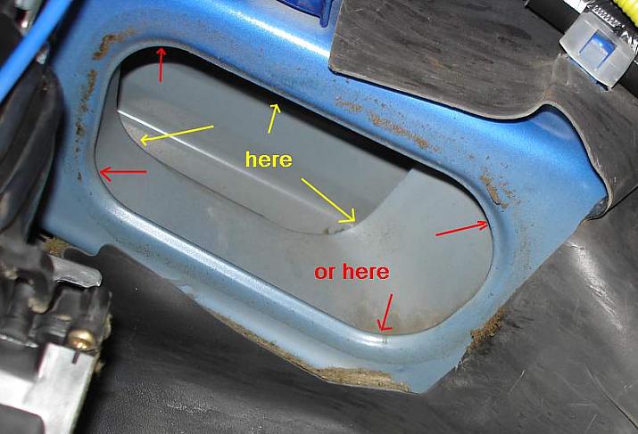

2 - I want to fabricate a cabin filter and rig it up somewhere in the top-side opening that the blower assembly snugs up to. Anyone have any suggestions about what kind of cabin filter I should use and how I might fasten it in? I think if I can get one in place I think it will prevent future illegal mouse-grations. Unless of course they just eat through it....
Attached Thumbnails Cabin filter in the "t"?-tblowr8.jpg   Cabin filter in the "t"?-tblowr3a.jpg

Crane, beautious rig man! Drat! since you mentioned it I'm gonna pull it apart again and see what I can do about replacing this foam filter. It's all dried up anyway and literally crumbles up when you touch it. I think I have some high density stuff at work I can use to replace it, just gotta figure out how to keep it in place, something that won't dissolve it, maybe double sided foam tape?.

That's not a filter...it's just some foam on the damper door to keep the noise level down and help seal the exterior air out.
You could just put in some screen like some extruded metal...gutter guard comes to mind. You'll have to cut it to size and fasten it in place. You'll want to use some sort of sealant so water won't git into the interior from there.
The rest of the mouse is probably on yer AC evaporator. My AC thread over at ToyotaNation has piccies of what my evaporator used to look like before I started spraying it with some degreaser and rinsing it with water. Make sure yer drain is clear from the engine bay side before you start trying to rinse it out. You might fair better with some disinfectant vs a degreaser...you'll have to try it and see. Good luck!

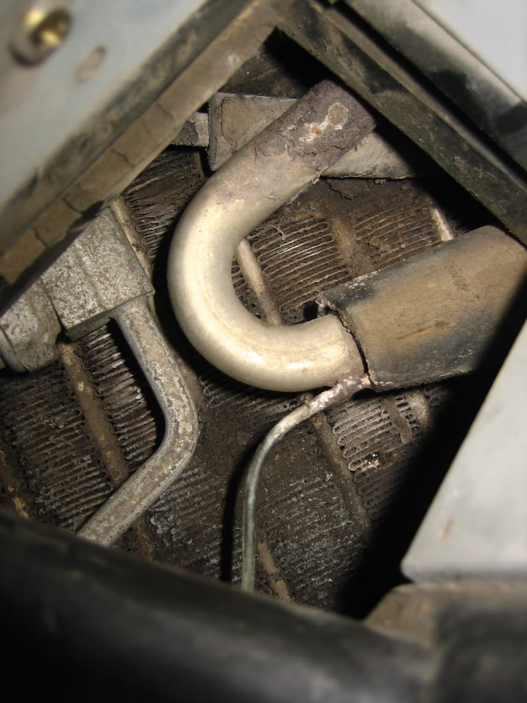

This is where the rest of the mouse would've ended up at...it's right after the blower.

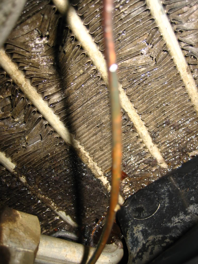

Old Jun 17, 2010 | 12:06 PM
BamZipPow's Avatar
Joined: Feb 2007
Posts: 454
First rinse...
Final rinse...

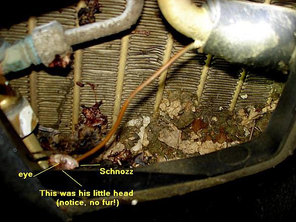

BZP - what in the world happened to your evaporator that it got so crudded up like that plus the mashed up fins? BTW when I checked my Toyota factory service manual it shows that you must completely dis-charge the A/C system before pulling the cooling unit out(which includes the evaporator), so I decided not to do that. How did you rinse your evaporator?
I found the rest of the little bugger, at least I think I got all of him.
basically gut-splattered the furry dude all across the evaporator just as BZP pointed out. I used a little vaccum cleaner that the copier techs use and sucked up all the stuff I could not get out with my fingers. Pretty tight quarters in here, not much room to even see what ur doing.
The smell seems to be gone, thanks to the Lysol and a couple of leather scented Christmas tree air fresheners.
I'm the 2nd owner of my T-100....it was a commercial work truck in it's previous life. It was one of those added features when gitting a used truck.
I decided to clean the evaporator before my BG Frigi-Clean kit came in. Basically...I had the water pressure from the water hose on too high and I rinse it from the blower side. I should've back flushed it from the driver's side with low water pressure. Or I should've used compressed air from the driver's side. Oh well...it was a lesson learned. It didn't affect the airflow that much...

BZP: great ideas...you got me thinking, if you look at my pics above(#2 & #8) I was thinking I could fab a filter in the upper intake which brings in air from the firewall vents. That opening up there is tapered and wider at the bottom, and has a little lip there I could fasten something to. Then I was thinking I could put something in place of the foam that's on the flapper for interior intake. I like the scotchbrite idea but I keep thinking I once had some charcoal filter material just like scotchbrite when I once owned a huge aquarium, or maybe it was an airconditiong system material. It was hard though, not like the scotchbrite stuff, but if I can find some material like that I might be able to make it work.

You should be able to find some activated carbon filters that are used fer air purifiers pretty easily. They are designed fer air flow so it should detract too much from air flow.
Bed, Bath, and Beyond, Ace Hardware, Tru-Value Hardware, Home Depot, Lowes are a few place that come to mind that might have those. Good luck!
