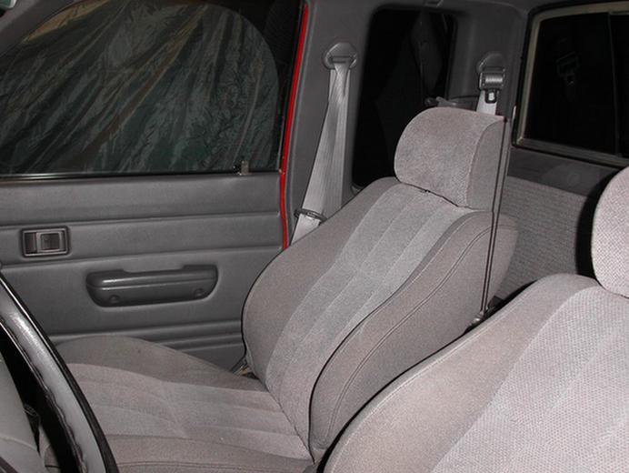

I got these from the local wreckers bucket seats-pict0139.jpg out of a 4 runner for $100

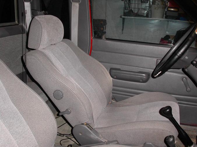

how easy was the install on those seats?

Easy Unbolt old and bolt in new ones .......

Originally Posted by Tick
I got these from the local wreckers Attachment 69050 out of a 4 runner for $100
Attachment 69051
What year 4runner did those come out of and was it an sr5 or not:

I think it was a 88 or 89 and yes it was a SR5 .....
