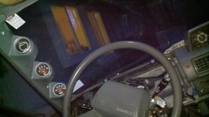

Hey guys,
So I spent most of today creating wiring harnesses for the cab, running wire into loom, and tearing apart my dash. I finally got the pillar installed, with all the wires run. All I need to do is connect to power, lighting power, ground in the cab, and run the wires to the engine bay.
That said, still need some input from you guys please on where to connect inside the cab - see below.
Here is the back, wired up:
And the front mocked up:
Installed!
Now, onto my questions about where to wire in the cab:

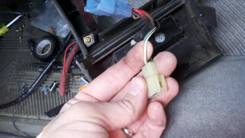

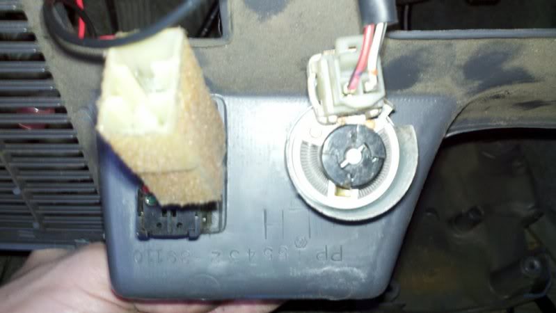

I have 3 wires to deal with: Ground, Power (ACC), and power for lights (triggered by parking lights - ideally hooked to dimmer switch).
For the ground, I was thinking of hooking into the ground on the cruise control switch (black/white wire here). I used an ammeter to test resistance between it and the ground on the ignition - they shared the same ground:
For the power wire, I was going to use one of these red wires, which is already tapped from my ignition system - I think it's part of my alarm system...
Now, for the lights on the gauges....really not sure here. I looked at the back of the dimmer switch and tried to test voltage with the parking lights on....kind of jumped all over. Anyone want to chime in here? I guess what I could do is tap into the wiring harness behind the gauge cluster, where the power for the dash lights come from....since it would already be dimmed at that point in the circuit?
Installed!

I apologize for the confusion. I didn't realize the dimmer switch used a floating/common ground. My advice was for systems who use the rheostat to control the voltage in and not the other way around. Take 4crawlers advice concerning the dimming of the gauges. I am sure I could figure something out by putting my hands on it, but doing it through the internet is a weakness of mine.
Again, I apologize for the confusion.

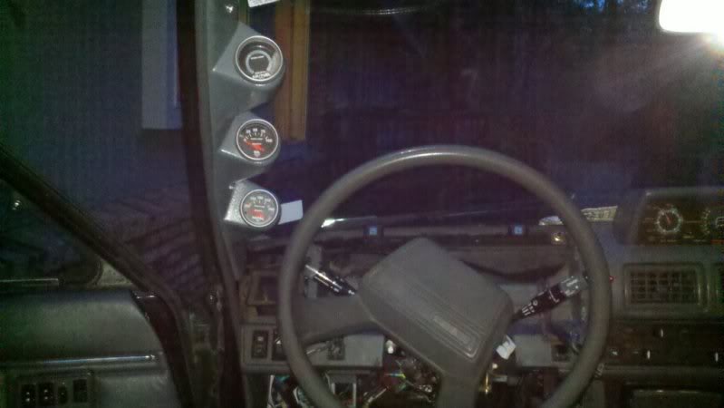

Well, I finished today and buttoned everything back up, including my dash.
I ran sender wires to the engine bay for the oil and water senders, for when I install them.
I wired the A/F wire to the O2 sensor wire in the engine bay.
So, when I turn on my parking lights now, the autometer gauges light up, but my dash gauges do not :/
I tapped one of the wires to the dash lights earlier today but believe it should still be getting power.
Also, the A/F gauge doesnt' seem to work - it does the quick light show when I turn off the truck, but nothing when truck is running.
Any ideas where to start tomorrow with troubleshooting?

With the dash and gauge lights, you either want to use *only* the dash light wires (both the + and - wires) or none of them. Can't mix that dash wiring and the parking light wiring, for example. On my '85, I just use the parking light hot wire and ground for any back lights.
O2 sensor (assuming a 1-wire, unheated unit) will take a while to warm up, so you need to run the engine a few minutes before it'll register. When I wired up mine, I tested it and it was fine, then after buttoning everything up, it quick working. I recall that one of my sensor connections came loose when I was tucking all the wires in place. Traced that out and it has worked fine since then.

So either use both sides of the dash light wiring or none of it, but do not use only one side or the other. It is basically all or nothing.
Problem with using one side, say the hot side and then a direct ground connection is that you are providing an alternate path to ground for the dash light current. It can either go through all the dash lights and the dimmer to ground, or it can go through your new gauge back lights to ground. Path of least resistance gets the most current.
