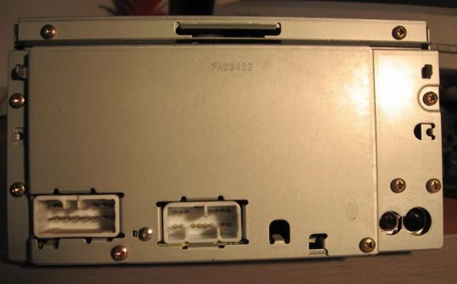

This is the back of my 2DIN HU. The top plate comes off with just 2 screws.

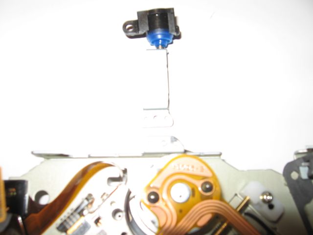

PIC2
After you remove the front bezel, (unsnaps at about 10 places), you can see how the CD sits. You must have already loaded a CD prior to dissassembly or the internal drive plate which holds the CD, motor, and laser assy will be rigidly locked in place and not freely suspended by the spring mounts. With the drive plate floating freely, it should hold the CD centered in the front slot or slightly above the mid-point. Too high, or worse too low, and the CD will strike metal when you go over bumps. This pic was taken after the fix and looks good.
Next check the suspension damping by jostling the whole unit. If its like mine was it won't take much for the CD to bottom out against the insertion plate. This was mainly because the front damper was shot.

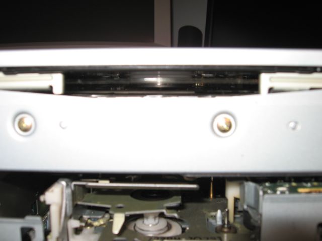

If you need to be convinced, do this while playing the CD in your car. You will have to partly dissasemble the front bezel to get the dust filter out of the way. You can then snap the bezel back on and still see into the loading slot.
PIC3,4
These blurry pics show the copper colored springs I added, one on each side. I put them on the same mounts with the stock springs. I happened to have an assorted spring kit, but if you take apart some old ball point pens you will
probably find what you need. You want to raise the ride height a bit without making it too stiff.
Hopefully this is all you will need to do. To get at the front damper you have to take apart the CD module. Theres lots more screws...(cont)

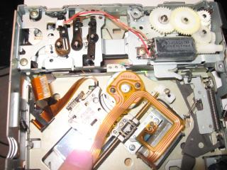

PIC4

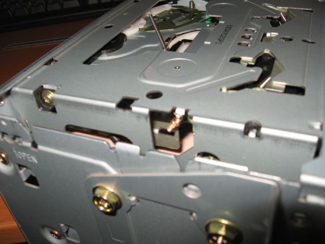

PIC5

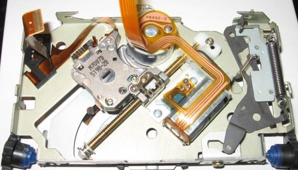

The CD module has been removed from the HU case. Keep all those screws and plates organized.

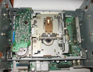

PIC6
The CD module with the bottom plates, circuit boards and front damper removed. The drive plate holds the disk motor and laser. You can see the CD thru a cutout in the drive plate. Just above the 'E-25059A' marking is where I trimmed a metal corner. If you don't feel the need to trim the metal, you can just fix the damper and reassemble (cont).

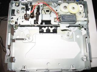

The CD module with the drive plate removed. To eject (or load) the CD, apply from 3v to 9v on the transport motor terminals. A 9V cell should work. Do this a few times and you will see the problem. Without no CD, the drive plate is trapped by two metal hooks on the case. Those hooks won't let go unless you load a CD, but the CD itself blocks removal of the drive plate. My solution was to take an old CD and cut it in two on a line about an inch from center. I loaded this at an angle and then rotated it so I could still remove the drive plate.

A bit of prying and a few curses later and here is the drive plate. The two rear dampers here were fine. This is when I trimmed the metal corner with a dremel tool. I covered everything else to keep metal dust out. I also trimmed the front damper brace since it hits at the same spot. The front damper looks OK, but there must be a tiny hole that let out the clear oil. I used a small screwdriver to pack it with black wheel bearing grease. I reasoned that it was about the right consistency and would not melt or drip away, although I don't know if this is a long-term solution. You could possibly cut and insert some very soft air filled foam, silicone or latex, but I think the earplug foam would be far too stiff.
After the fix, I could shake the whole thing and not get any metal-to-metal contact. I have road tested this on some pretty good potholes and it seems to be 100% fixed.
