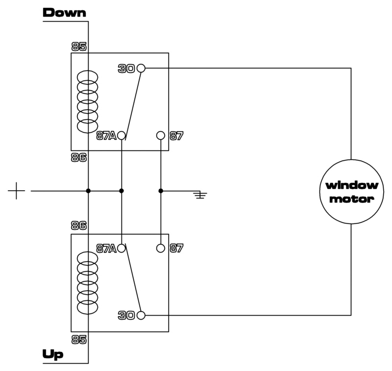

reviving my own thread here i finally got around to getting a set of doors off a 4runner with power everything and all the switches what i couldnt do was unplug the harness on the passenger door so it had to be cut, or get any of the computer stuff so i have to make my own circuit which isnt to big a deal thanks to irab for posting a basic diagram on his thread
i want to use all the factory switches but need to setup my own circuits plus do everything for power mirrors and power locks
is all the power window control box just a box full of relays
basically what im going for here is a stand alone power window/lock/mirrors using oem parts
i took the doors apart today and was looking at the inside and realized i could minimize the wires going to and from the door by mounting the relays to the door in the forwardmost part of the door i already got the drivers side mirror swapped ill post a write up of the passengers side with pics but im probably going to go ahead and get the hang of it thatway when i do my right up it wont be a complete clusterf*** like most off my other write ups

ok so thanks to irab88 and weaselman i will be using this circuit
this site provides lots of info and diagrams on automotive circuits and such

I'm trying to add power windows but I'm trying to use a 4runner rear door switch. Could you please help me out with wiring. I have the oem switch and harness to it but it has 5 total wires. Plz help
