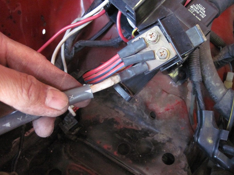

Pictures so we see what you have in front of you?
80-Amp fuse is aka "Fusible Link".
One white wire connects it to fusible link WIRE. This is that one:

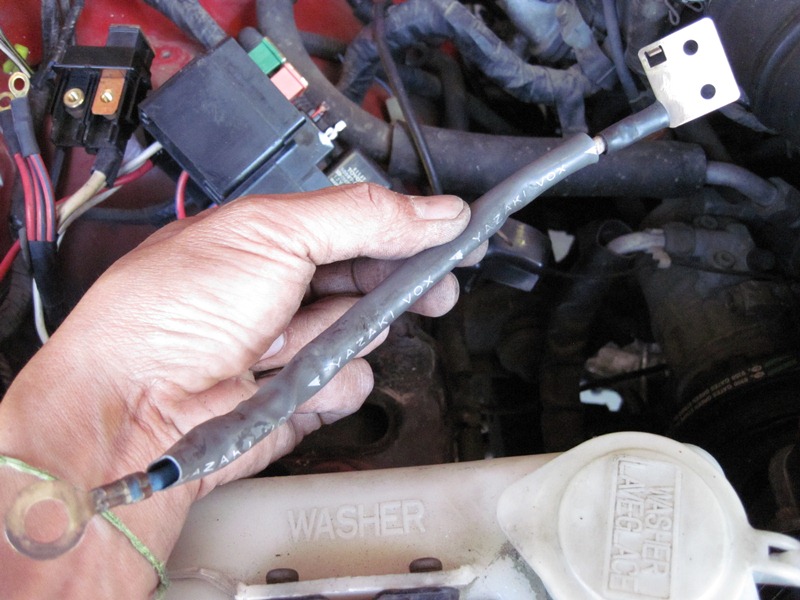

This is the fusible link wire:

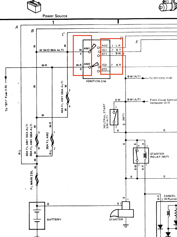

On the other side, the THICK one is "B" wire. Connects to alternator output. There might be another one on that second side that connects to 40-amp fuse in fuse block. The 40-Ap fuse provides power to one of the terminals of the IGN switch.
