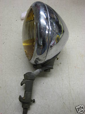

Light Pics
Ok, in my ultimate laziness, I searched EBay and found a couple vintage lights for sale from the same manufacturer from about the same era. I copied 3 pics and they should be attached to this message.
Attached Thumbnails Installing 40 Year Old Lights (no ground wire)-unity-light2.jpg   Installing 40 Year Old Lights (no ground wire)-unity-light3.jpg   Installing 40 Year Old Lights (no ground wire)-unity-light.jpg

Those are rad!

Not bad, not bad. Still want to see them on the truck. And maybe some example pics of how bright they are?
