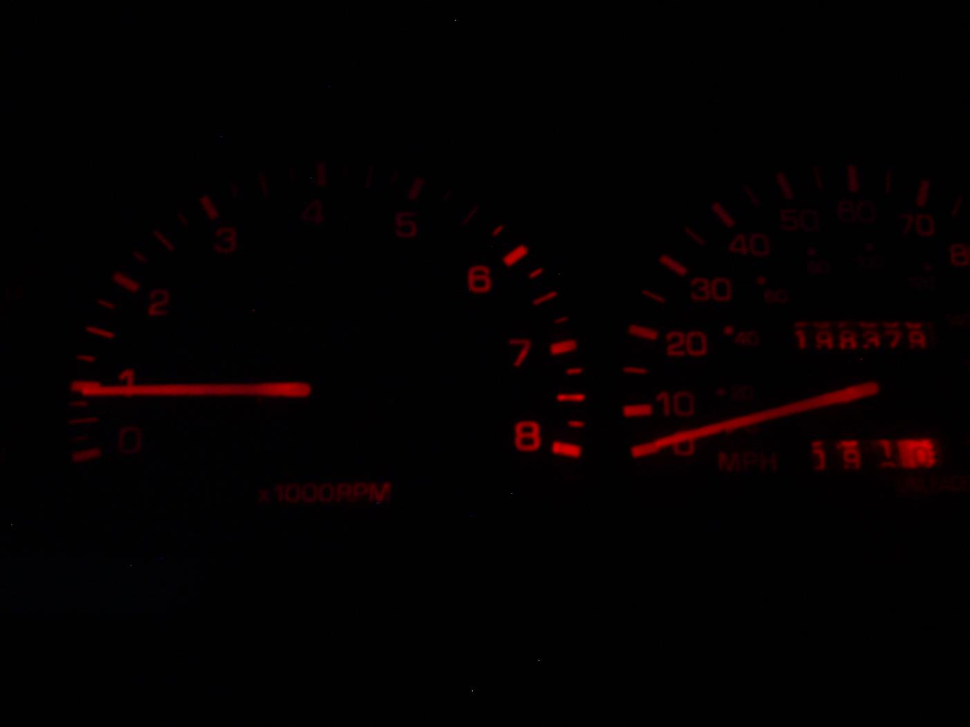

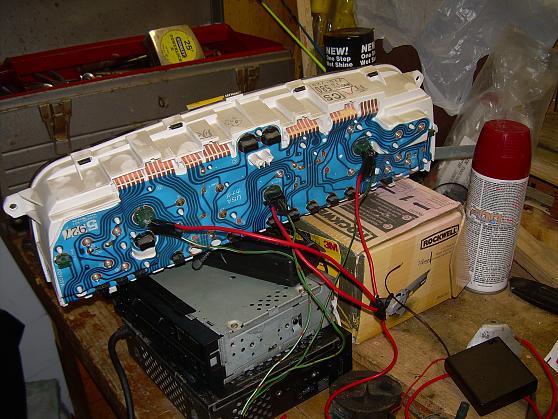

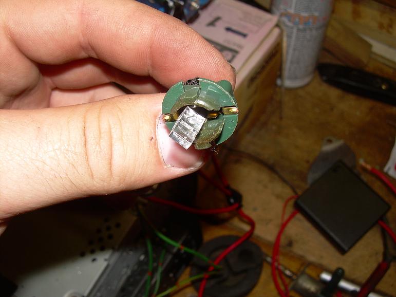

pulled my dash apart and the bulbs were still good... no fuses burnt so i decided to just go to radio shack and get some LED's and 4AA battery holder and rigged it up. ill get some pics up

Still no workey properly?
About the dim spots,,, there are different bulbs you can get that minimize that. I know its probably not as bad as it looks in the pictures but I have seen some that are damn near a perfect spread. Search around here there are a few threads about this.
