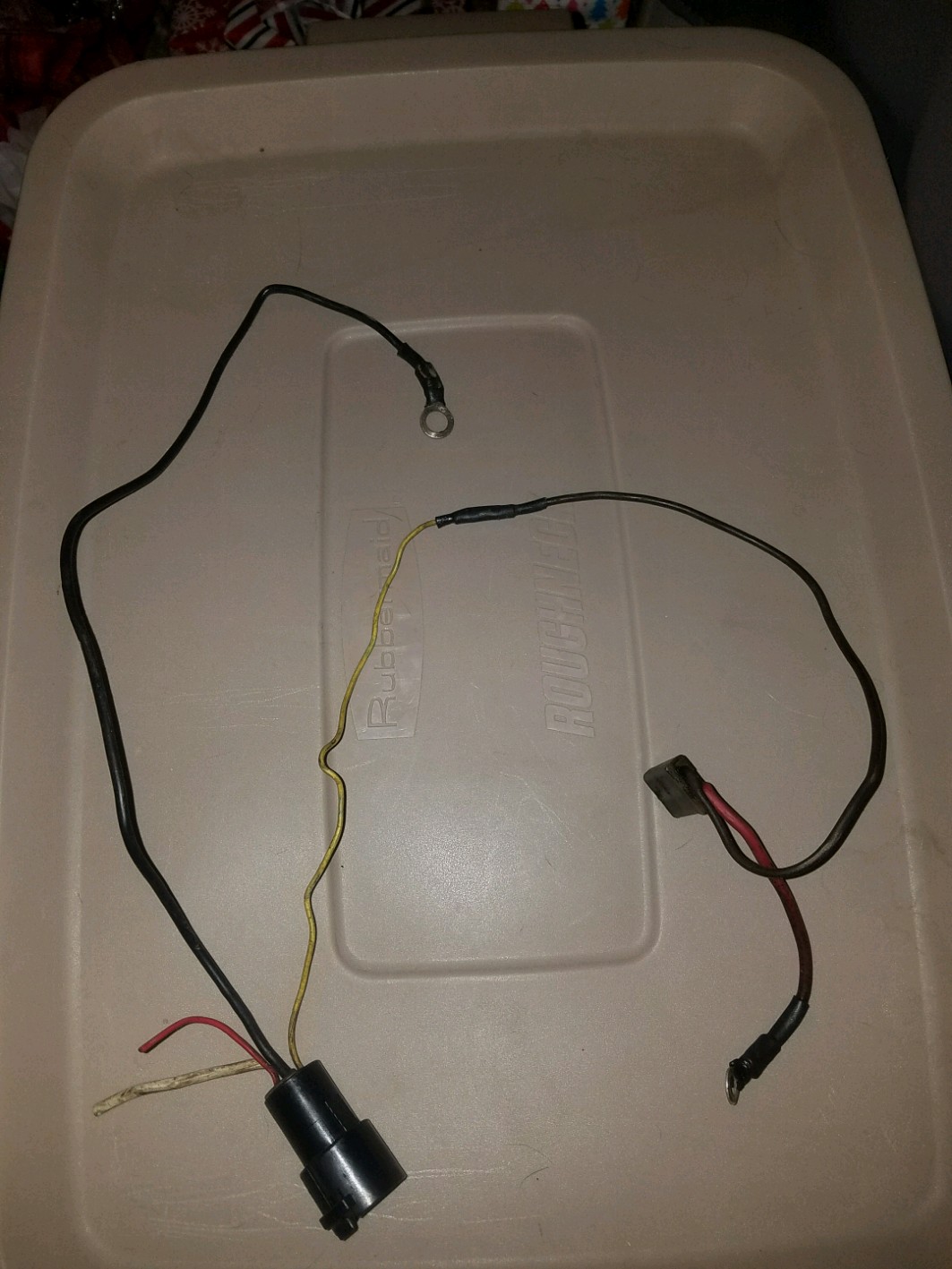

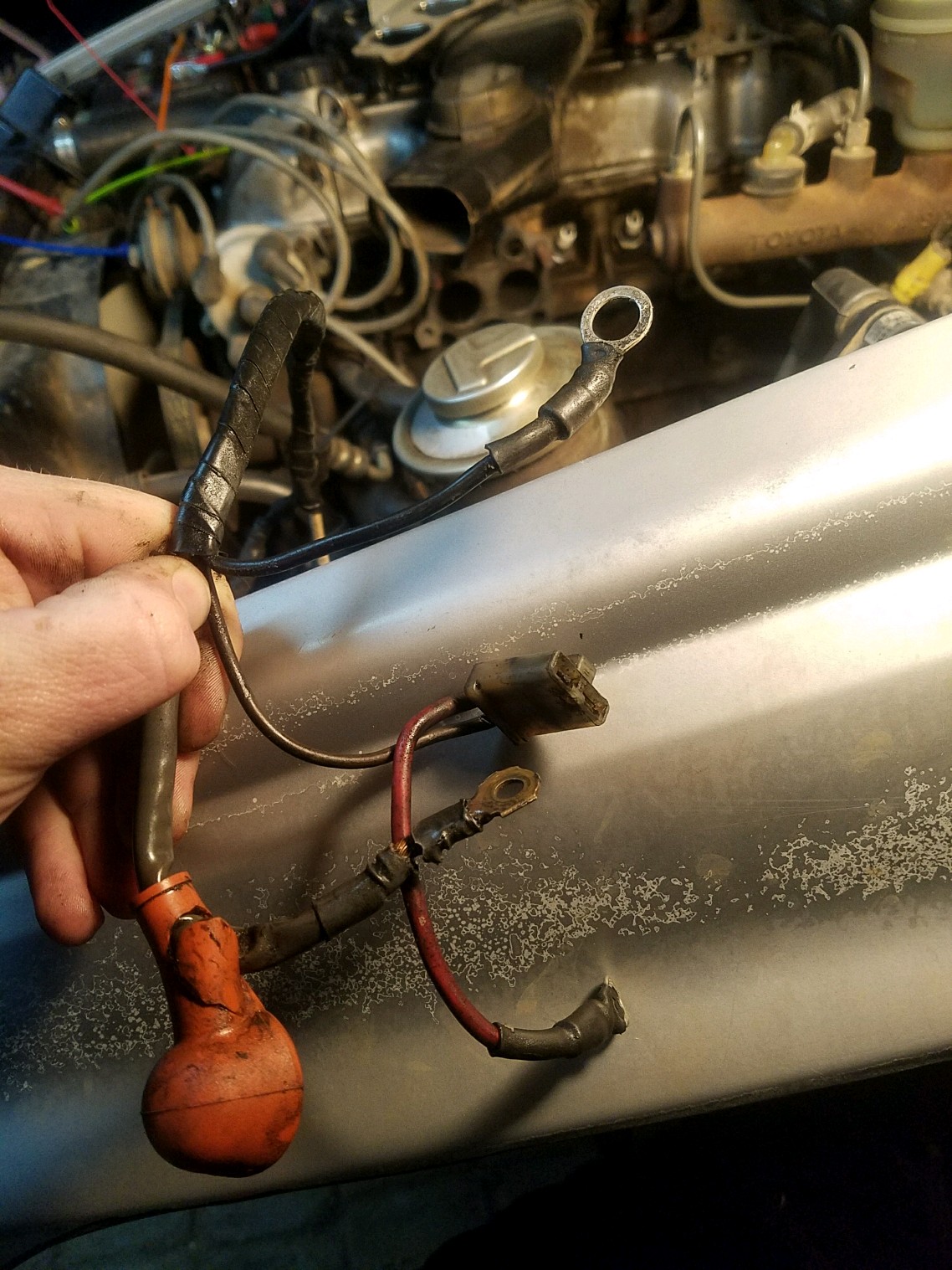

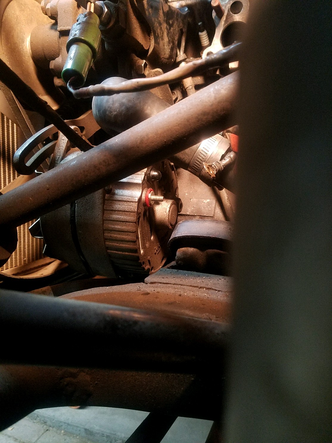

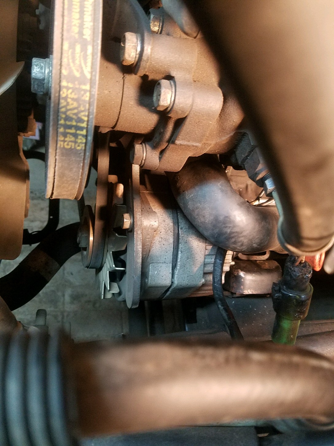

Hey there everyone! New to the forums and the toyota world. I picked up a truck that has a power draw. I narrowed it down to it coming from the alternator. With the alternator hooked up it's pulling 0.68 amps when tested. If I unplug it, the amps 0 out. I do know that the alternator has been upgraded to the gm alternator but unsure of what one it is. I've taken some pictures of the wires. The solid black wire was attached to the ground on the back of the alt, the plastic plug was plugged into it on top, and the red wire from the plug and the wire with the boot were attached to the battery output on the back of the alt.
I've been researching the conversion but a lot of the posts have broken links and missing images. But from what I have found it seems like this could possibly be hooked up wrong? Can anyone give me some insight on this topic and point me in the right direction. I'm also curious about where to tap into the ignition wire so things only turn on when the key is turned on.
Attached Thumbnails GM alt upgrade/power drain-alt.jpg   GM alt upgrade/power drain-alt1.jpg   GM alt upgrade/power drain-harness.jpg   GM alt upgrade/power drain-wires.jpg

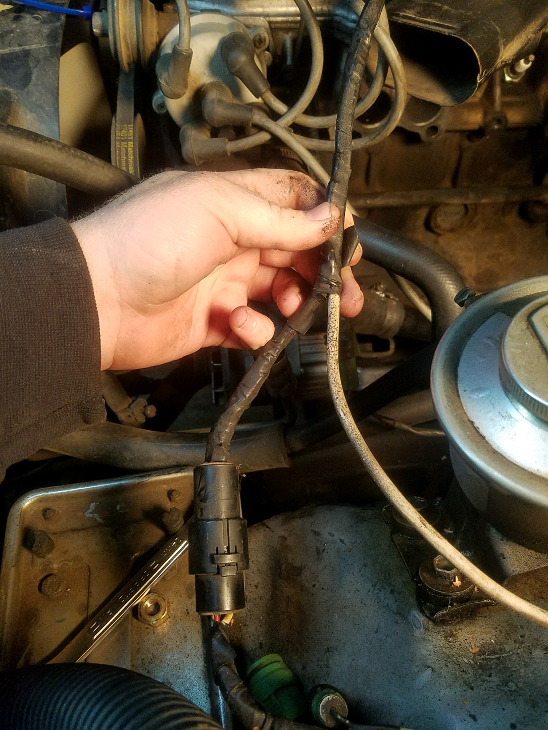

I'm looking at the wiring some more and I'm really starting to believe this thing is hooked up wrong. I'm adding some more pictures to the post so I can maybe get some more help. The wire that is connected to the yellow wire was plugged into the top of the alternator with the plastic plug with the red wire connected to the bat post on the alternator. The black wire went to the ground bolt on the back of the alternator (like I'm guessing it should in this case.) And the wire with the red boot that was connected to the bat output post on the back was connected under a little box. Hoping these pictures will help narrow down my issue.
Attached Thumbnails GM alt upgrade/power drain-ground1.jpg

Looks like the 12si alternator. With this swap the the black plug only has 2 connections vrs the CS130 swap that have 3 wires in plug. Been years since I did the wiring for my CS130 swap and longer since I researched and compared swaps. The 12si combines the ignition and sense wires.

From the looks of it, the alternator is the 10si. I'm not very good with electrical so I'm still learning. But from what I'm reading online is that with this swap, I should be using the white wire and yellow wire with both of them tied into the white plastic plug. Then run a wire straight from the alternator to the battery correct? What about the larger white wire that is connected to the bat post on the alternator already?
can’t think of a single reason someone would go through the effort of converting alt to put in a 10si. But it’s possible. Definately research this some more. Several good write ups.
I'm only going off of pictures I have found online. The plugs and air vents are slightly different on the 12si compared to the 10si. And thanks for the help.
still looking for more info though. I've been doing a lot of reading and searching but haven t really found my answer. Both the red wire and wire wire coming from the harness have been left unused. Black wire is to ground, yellow/brown is into the plug on the alternator, then from the plug on the alternator it goes to the bat post on the back. Can anyone else chime in on this issue ?

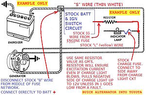

Measure current draw with ONLY the "B" wire connected to screw terminal and the small connector unplugged. If you have current draw, then you either have internal short or bad rectifier.
Originally Posted by GreyYota87
I'm only going off of pictures I have found online...
Find schematic for the car that the alternator is really intended for. Then it is a simple matter of translating into Toyota system.
EXAMPLE ONLY IS ATTACHED...
Attached Thumbnails GM alt upgrade/power drain-example.jpg

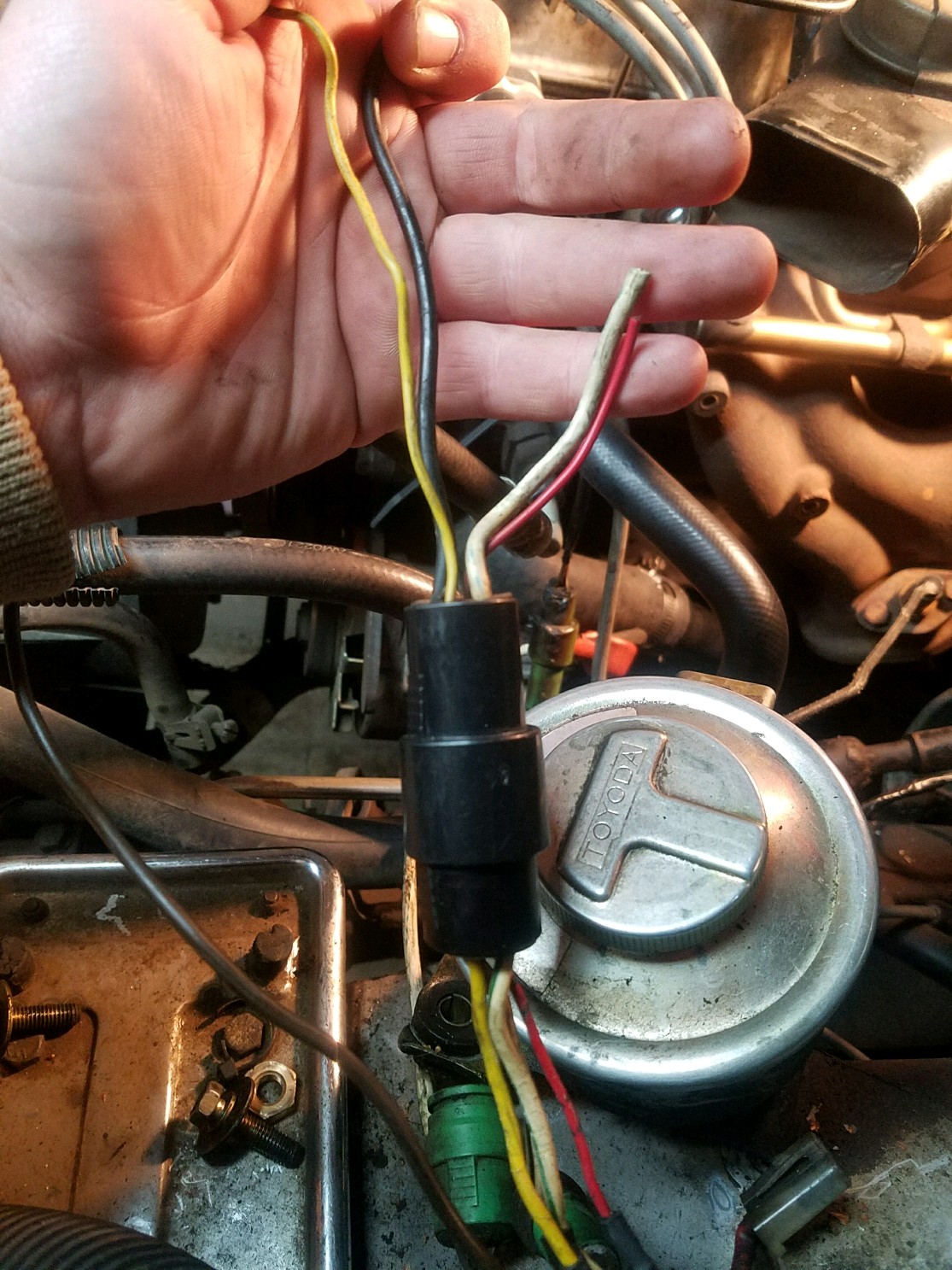

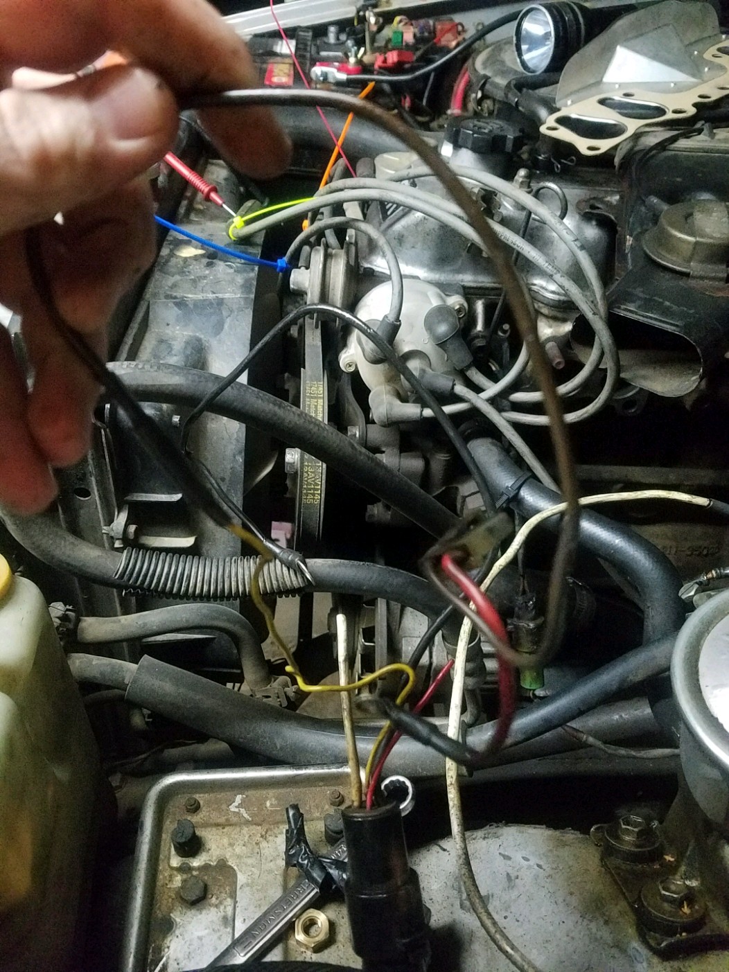

pics you posted are not very clear, looks like spaghetti with all the wires about. Do you have better pics of connection to alt; plugs and wire connection from factory to gm plug.
Old Dec 12, 2017 | 09:08 PM
GreyYota87's Avatar
Joined: Dec 2017
Posts: 62
Likes: 12
From: California
Here's a better picture of the wires coming from the factory plug to the gm plug. I believe I've narrowed it down to it being the yellow wire causing the power draw. I'm horrible with electrical work..but I'm trying my best to learn! I'm really bad at reading electrical diagrams, so correct me if I'm wrong. The yellow wire runs along the front of the engine bay and into the fuse box. The fuse it ties into is the 7.5 amp fuse. Is this the wire that keeps the charge light off? Again sorry for being so new and asking such dumb questions lol.
Attached Thumbnails GM alt upgrade/power drain-harness1.jpg
What year truck?
i’ve only done one gm alt conversion, mine. But yours looks like it was set up to sense as a one wire buy with a charge light. Don’t know that that is wrong but not how I chose to do mine. When the sense is before other load drawing circuits it may not charge at optimal voltage/amp.
When you say power draw when off is .68 but when you unhook it it stops. What are you in unhooking? Plug, main power, ground?
I don’t know that it would fix problem but a would rewire it and not do the pseudo one wire setup.

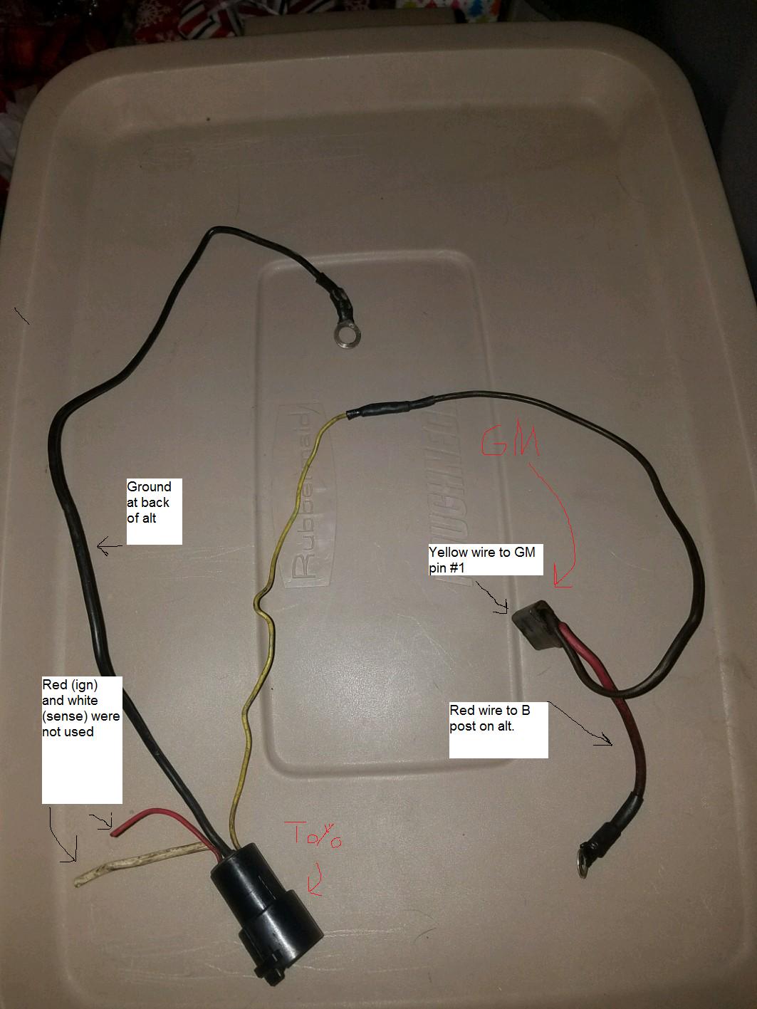

So to clear things up a bit with everyone on this subject. Today I spent some time on the phone with RAD4runner trying to narrow down the issue. We do know that the alternator is a 10SI alternator.I tested a lot of the wires at the stock toyota plug (not the side that would plug into the stock alternator) as well as the new GM plug. The way the truck was wired was as following.
yellow wire (alt light) to GM pin #1
black wire to alternator ground
red wire (ignition) was blank
white wire (sense) was blank
Would the correct way be to wire the red ignition wire into pin #2 on the alternator. Or does pin #2 go straight back to the B post on the back of the alternator?
And if anyone that has done this swap or someone that would know the answer to this. Should their be a constant 12v at pin #1 and pin #2 on the alternator.
Hoping RAD4runner can chime in on what way talked about tonight and give some better information ( i suck with electrical!) to help get this narrowed down. It seems like the constant power at pin #1 is going through the alt light wire and draining my battery!
Attached Thumbnails GM alt upgrade/power drain-harness1p.jpg   GM alt upgrade/power drain-20171213_222459.jpg
