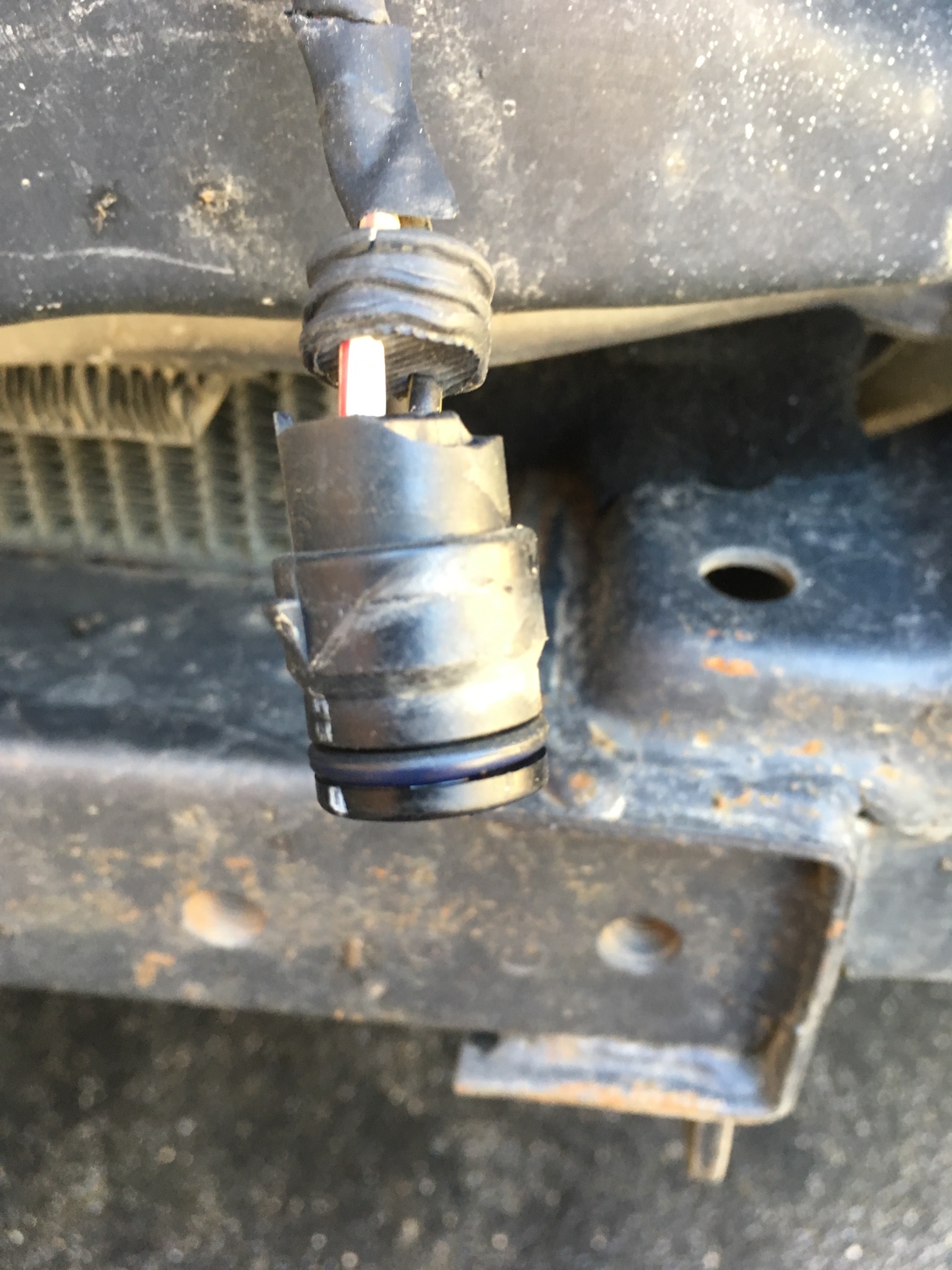

Easy question for those in the know. Hit a deer and this wire connector got disconnected. Wire was cut on the other end of the plug. I have the the other connector that goes with the pic but the wires were cut in the accident. I can't find where it goes. This (photo)end of the plug pictured goes to the electric fan area. Can't say I have heard the fan come on Lately and does not come on with ac on. So in short I have the other end that plugs into the pic with a short amount of wire but a cant find where it attaches. Pulled off the guard under the engine to get a closer look but see nothing. 1990 4Runner with a v6. Thanks

Here is the other end but I cannot find where it got cut (other end that needs to be reattached...the cut wire)? Could only load one photo at a time for some reason. Thanks. Just found a little rectangular box on the bottom of the radiator that looks like it had wires to it???? Is this it what is it. Thanks

Now I have a 92 4Runner it almost looks like a plug for the condenser fan
You should always post the color of the wires Looks like white and black
And show the plug like you were going to plug it together

White with a red stripe and solid black where the wire is cut, the plug side that is still connected is white with a red stripe and black with a yellow stripe. Plastic box were it may have come from in the background. Thanks!!!!

Got it, it does go to the black box. Got the fan to cycle on (with the ac on)What is the box called, I need to replace it since the tabs broke off. Thank you.

Confirm. AC subharness, plug R2 to condenser fan resistor.

PS . Should be a ground wire in that sub harness also, with a ring terminal

This just goes to show even one year difference in the EWD can make a difference in wire color
