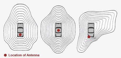

You can see how much the body of the vehicle affects the pattern, the antenna on the front corners would basically just reverse the pattern of it mounted on the rear.
For group use you'd be all right with it anywhere for the most part. Might drop out on the highway or if your way behind.... or in front
