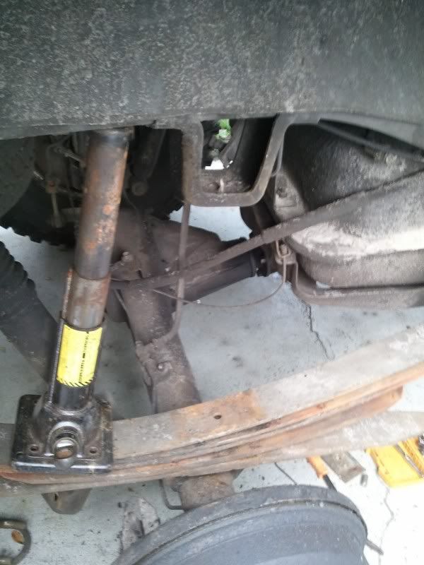

flat leaf springs before the start of the job
with the tires off, remove the leaf spring u bolts and in my case the blocks and make sure you have supported the axle.

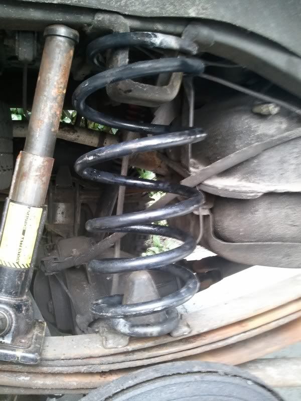

i used stock jeep springs from a friends rubicon. there are two lengths and and diameters under those jeeps, luckily the shorter and wider ones pretty much fit perfectly around the bumpstops between the leaf and frame without any problem. used a torch to slightly bend the ends to better fit around the stops.

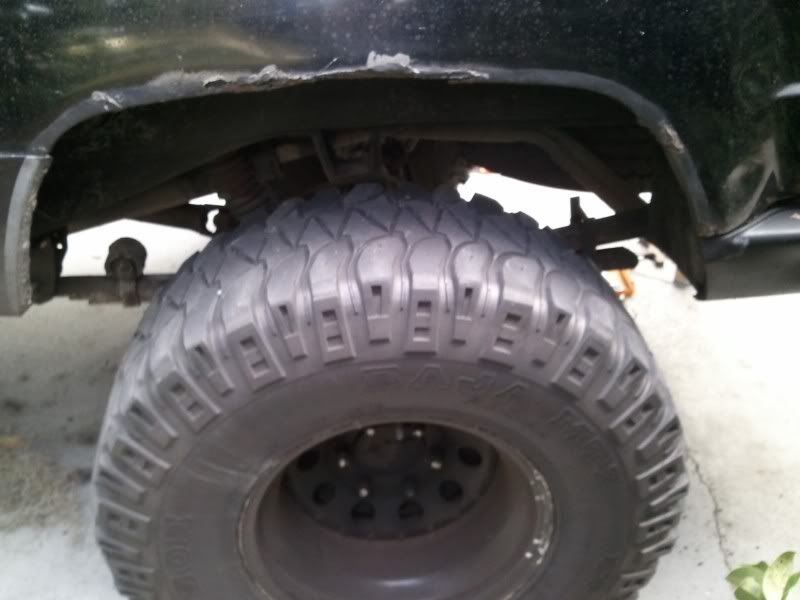

no more blocks and even more clearance by about 1".
i recommend the zuk mod for any older toyota and especially the 4runners. after putting about 5k on it since this mod i can say my horrible body roll and constant fear of flipping while turning is gone. the zuk mod stiffened up my rear end so much i can load my truck with tools and have 4 guys stand on my bumper and it barely drops with all the weight. front axle swap with more detail and pics are coming soon
